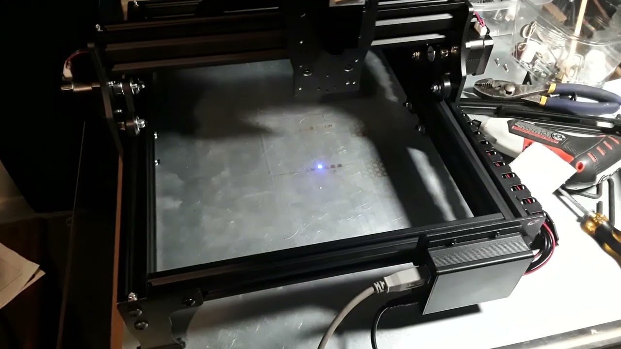

Sill looking for something that actually allows me to connect with the JL1 board. I though someone here had one partially working with software from ?
Back in this post I shared how I had taken an old Win7 laptop and downloaded @LsrSal’s zipfile… and extracted the two files (ROM.bin and upgrade.exe) to the Desktop. Connecting the USB cable and following the simple power-on procedure in that post… I had GRBL 1.1f loaded on this machine in about a minute. Was air-milling under Lightburn control in just a few minutes.
It was really quite easy using nothing more than a Windows laptop and the zipfile… but you do want to do this in one go, if possible, to avoid the possibility of confusion and/or “bricking” the board. The .exe file doesn’t provide any messages/status… just a popup window with a button and a progress bar. Upon clicking the “start upgrading” button it simply shows a green progress bar that runs to completion (hopefully) in less than a minute and then returns to the way it looked in the beginning. I also kept everything on the Desktop for this procedure… the .exe program apparently defaults to “rom.bin” in the same folder.

I’ve blocked up the machine with hopes of trying the rotary fixture later… maybe today. Ran a simple engraving under LB control from my Chromebook…
I haven’t figured out a Z-lift mechanism yet so simply attached the laser module to a flat stick and clamped it to the X-carriage. Also had to fish the laser leads out of the cable chain for a few links in order to get some slack for focusing.
I’ve also got to figure out why I can’t use “User Origin” as I normally do. It frames properly where I put it but when I “Start” it crashes left. “Current Position” framed and ran properly in this test.

The machine itself is a “tank” and very impressively built… the laser module is a low-powered (claimed 3W) laser module as you might expect. But I’ve been doing ceramic tiles and glass with a little Eleksmaker 2.3W laser for quite a while so I suspect this one will be useful as well.
Hookupis a simple 3-wire connection – +12V/Gnd/PWM – that should allow any number of other modules to be installed should you find it necessary.

@LsrSal’s zipfile is what I used… extract two files, “ROM.bin” and “upgrade.exe”. My post above is exactly what I did… it only took about a minute to actually to flash Grbl 1.1f on the board once I got my rarely-used Win7 laptop fired up and running. Nothing more than the Windows laptop, the zipfile, USB cable, and laser machine are required.
You’ll need to change a few GRBL settings to get things going in the right direction but the basics are there.
