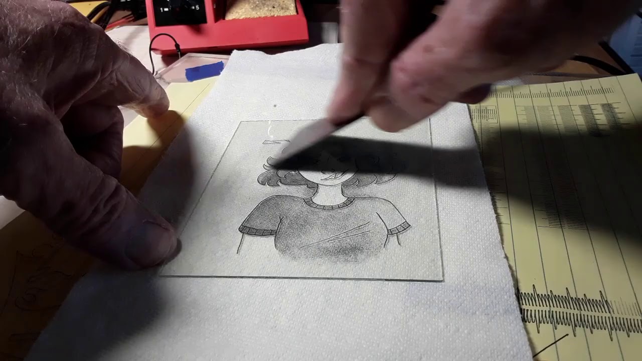

Another fun, quick test… and something I’d done from a couple of years ago, I used the Norton white tile method… on plain window pane glass. Back then I’d done one of my grand-daughter’s pencil drawings on picture frame glass to demonstrate the texture and scrape-resistance…
