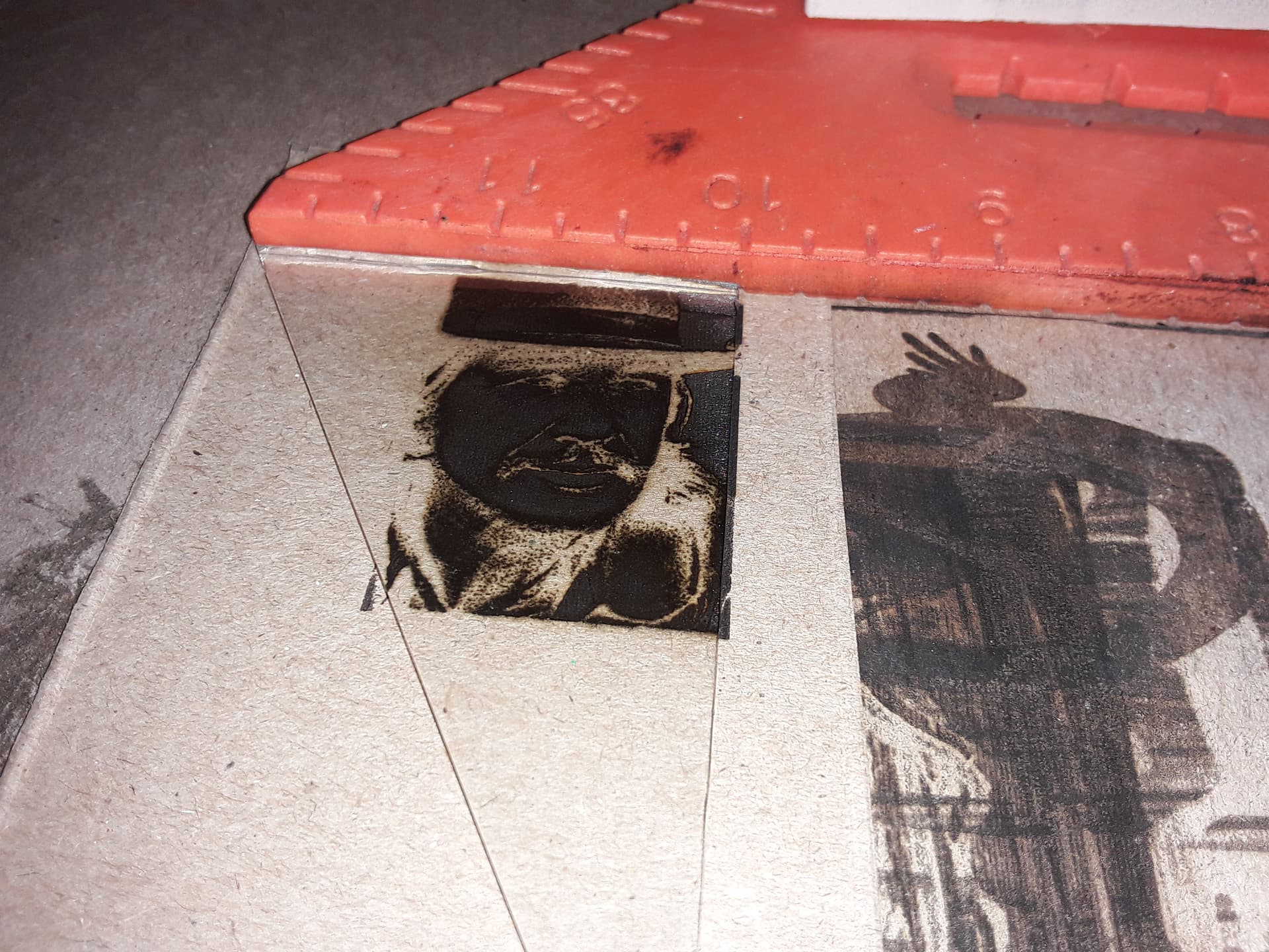

Found this unsavory character hiding on my hard drive…
and decided to immortalize him on a sliver of glass using my new-found method…
focused at surface of chipboard, 1000 mm/min, 90% power, 339 dpi… and looking pretty rough…
remember to mirror and invert the image… we’re etching the backside, which will become the frontside…
Washed in soapy dishwater and edge-lit…
It turned out far better than I expected… he’s almost recognizable.
He looks familiar… I’m pretty sure I’ve seen him someplace :wink:
– David

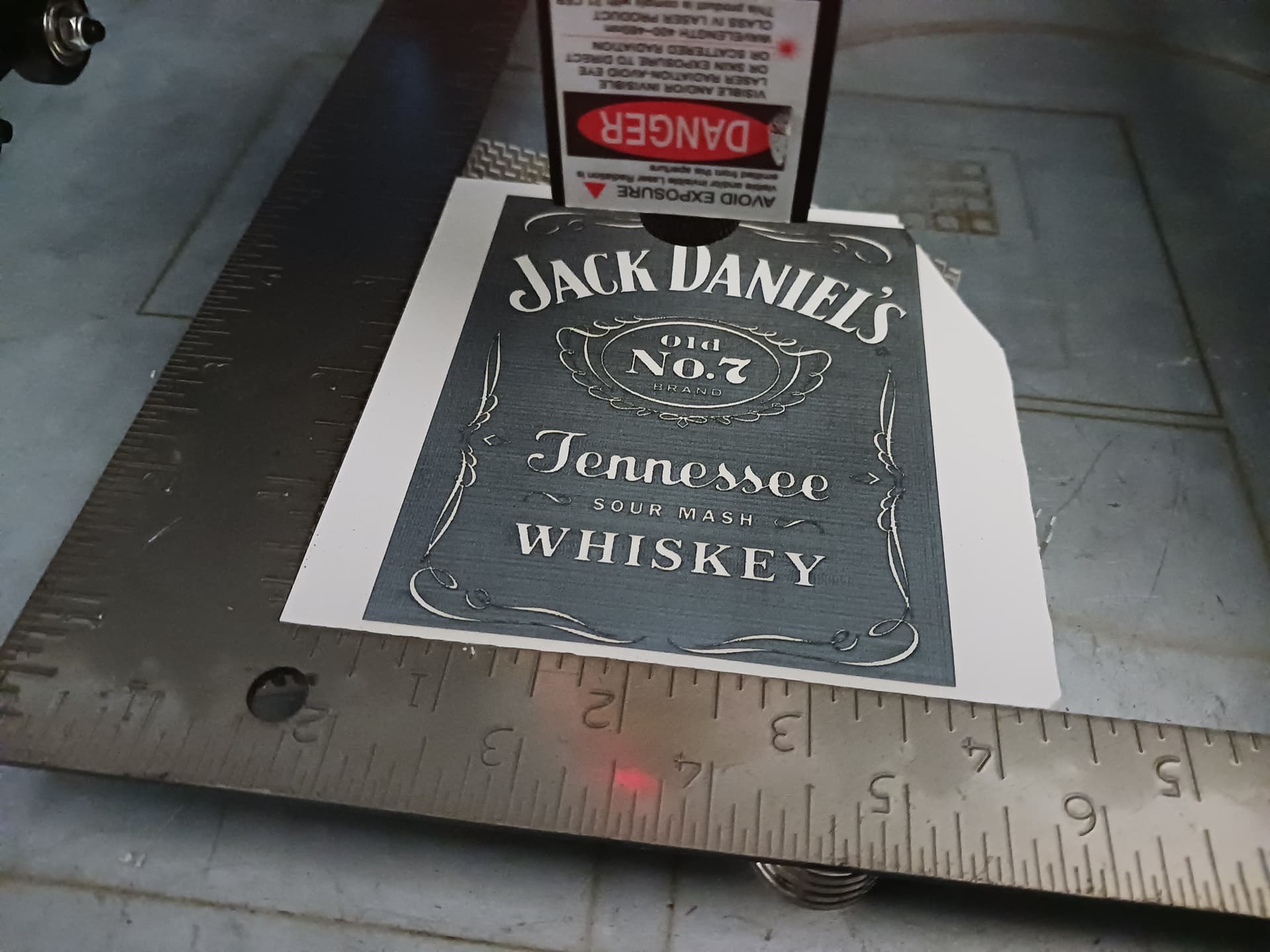

Playing around with the “two-tone” engravings on transparent glass again…
Ceramic tile and glass done on our little Cenoz machine with Banggood 2.3W laser…
The process… lizards for reference – same gcode, same laser settings, different paint
Flat-white painted glass being lasered for black background…
Before paint/soot removal with acetone… I keep a personal fan gently blowing across surface to keep lens from fouling…
White paint removed… note the lettering is still transparent…
Painted now with black tempera paint and lettering/scrollwork is lasered (negative image!)…
Paint removed and frosted letters… tempera paint can be washed off with plain or dishwater…
and now joins my “collection” of glass scraps… :wink:
Remember to use a negative image for light/frosted image bits. And since the workpiece is removed a couple of times… registration is key!
