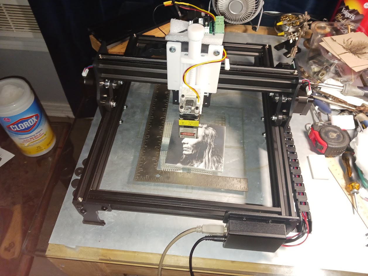

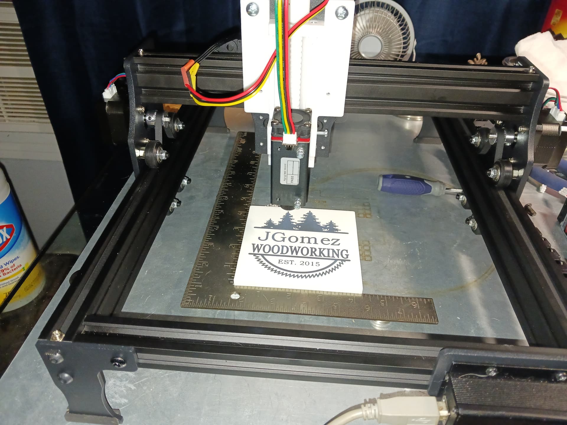

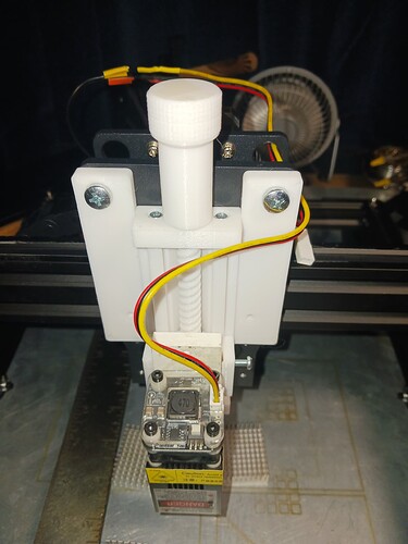

Got the 30 watt Neje mounted and running ramp test…

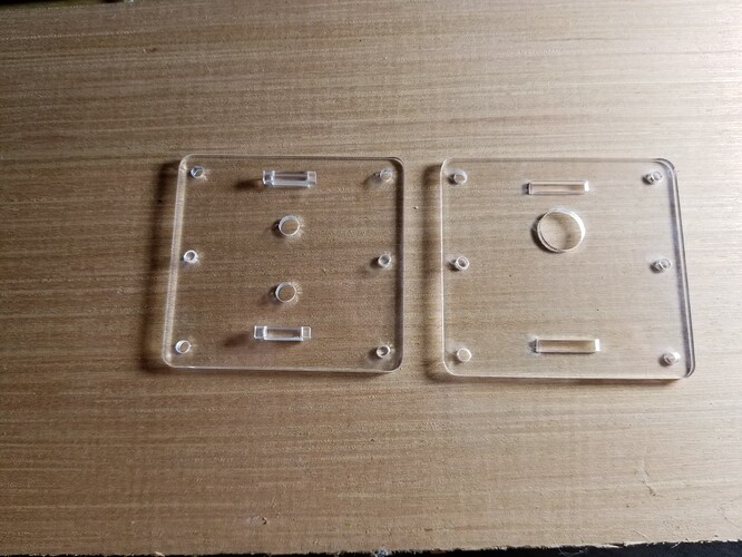

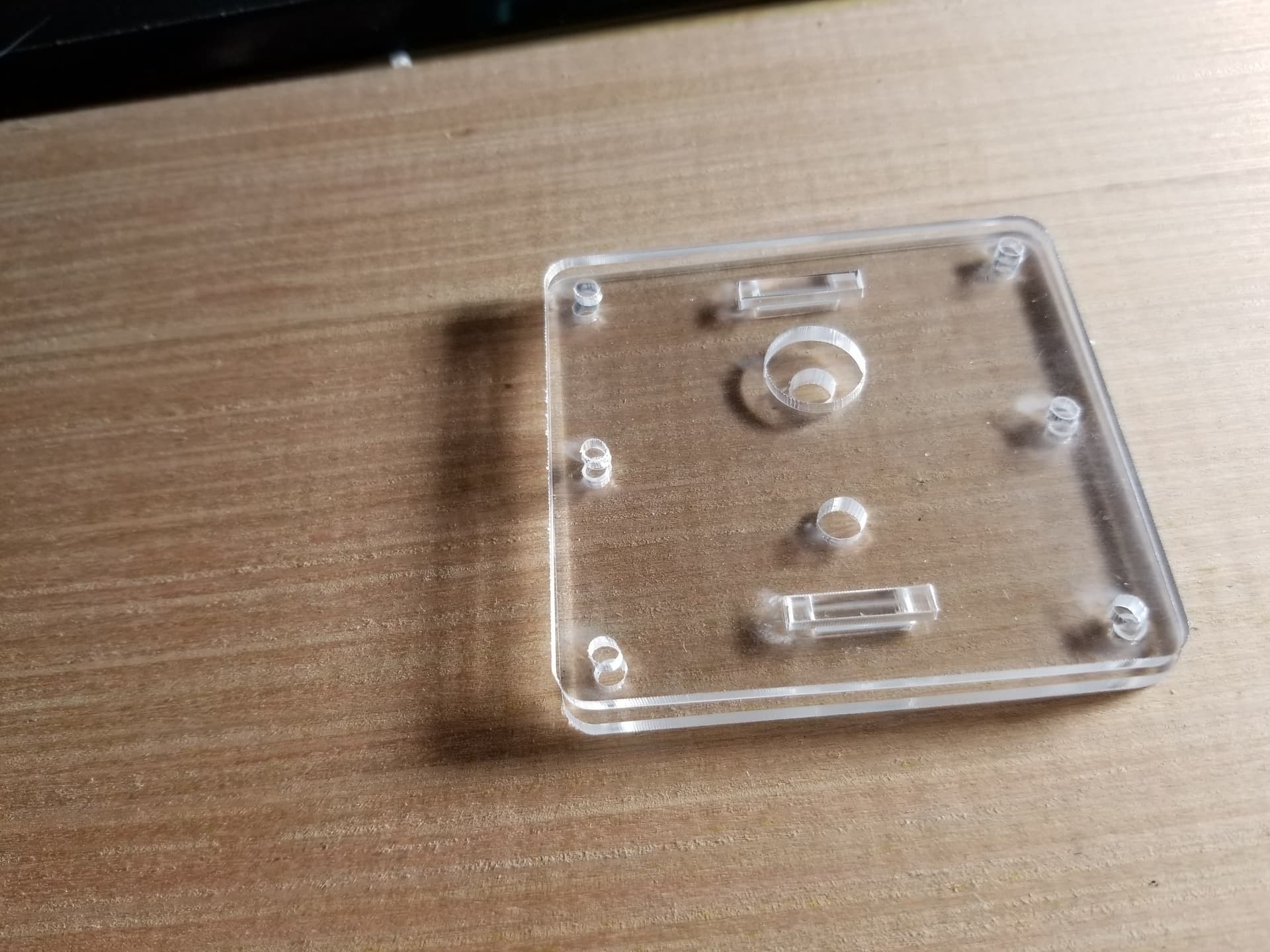

Acrylic mounting plate…
Kind of hacked into operation… High tech board mount — double sided tape on the motor…
Sandwiched pair of acrylic plates…

Managed to ‘extend’ the plate by 55mm and it’s working… Have no idea if I’ve created “the great pendulum.”

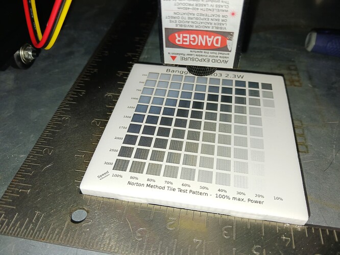

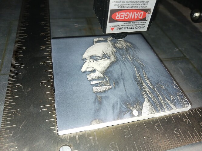

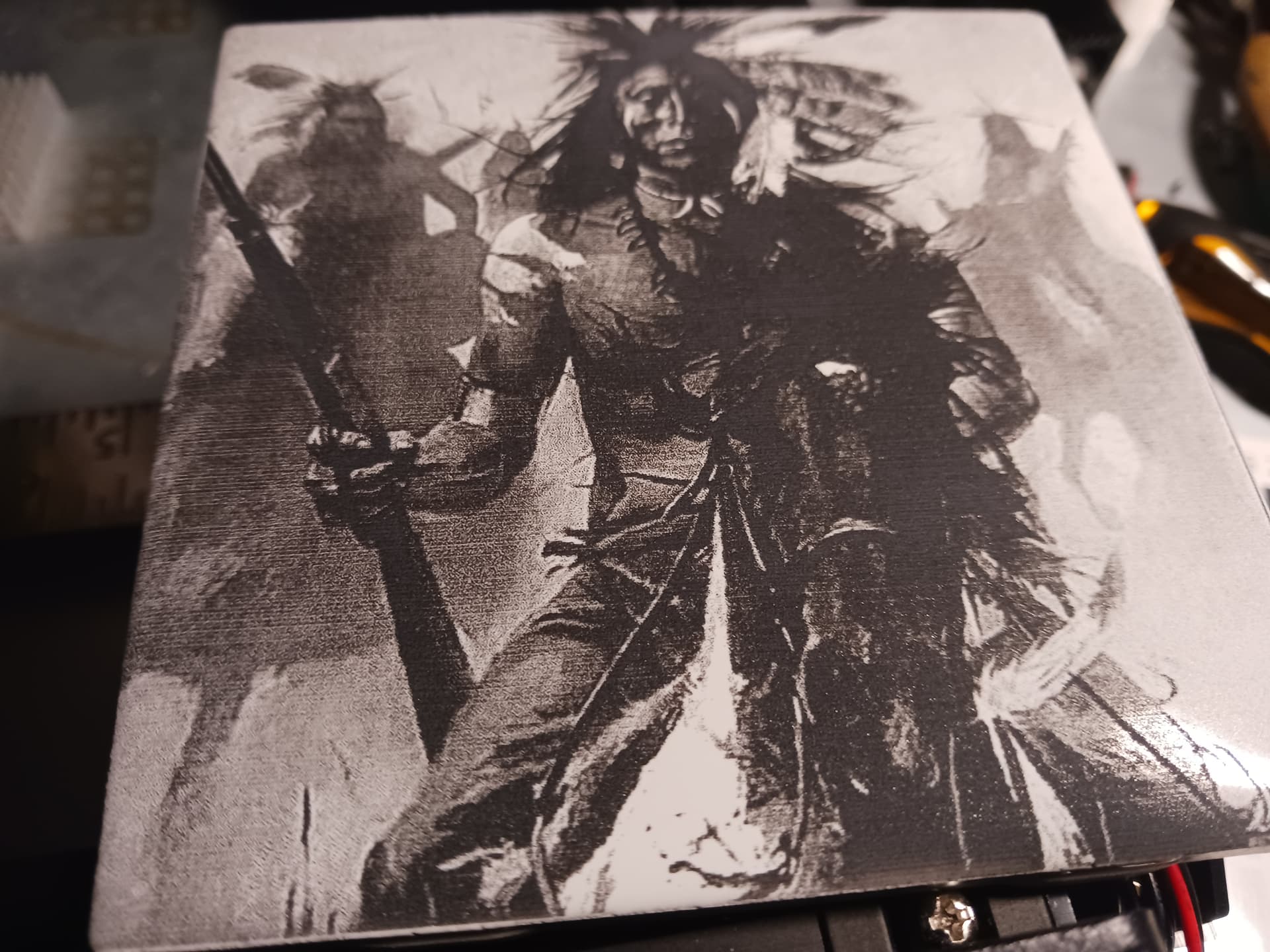

I’ve also been playing with different laser modules on our $79 machine. Here I’m using a little Banggood 2.3W laser to do a test tile and image… lasered and before paint (I’m using Krylon Colormaxx flat-white) removal
Paint removed… best black seems to be 1000mm/min and 100%…

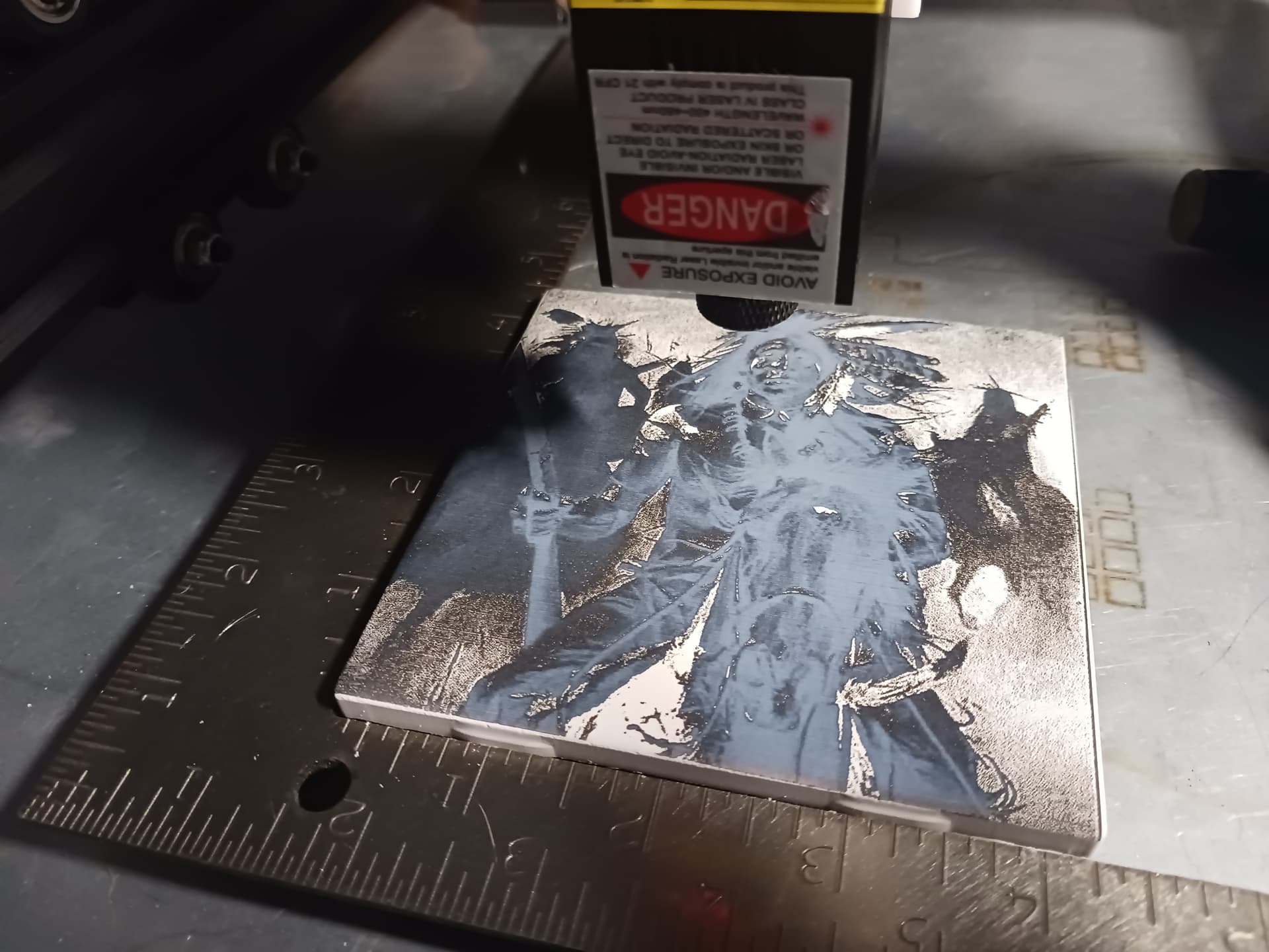

Image lasered leaves dark, muddy/sooty, image before paint removal. I have a small personal fan blowing gently across the work surface to clear smoke/soot away from the laser lens to avoid fouling…
Paint/soot removed with acetone leaves pretty good image of my “warrior buddy” on horseback…

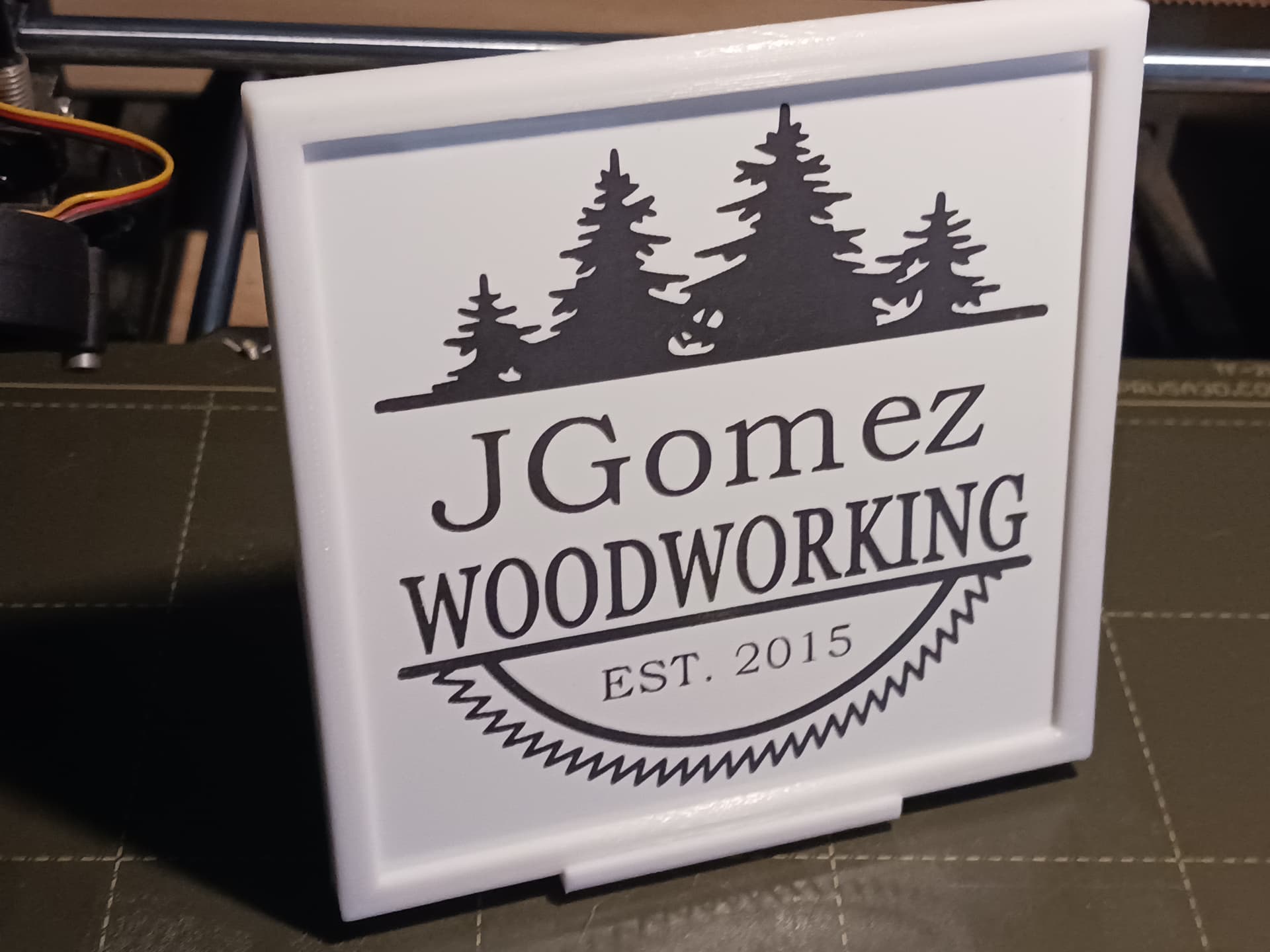

Different laser… Neje 4W(?) laser with friend’s logo…
A little printed frame and stand to dress up the tile edges and present your work…
The included laser module kinda works but leaves a lot to be desired. I chopped off the funky connector and soldered on a 3-wire pigtail and now it’s pretty simple to swap out laser modules. Just keep up with which of the black wires match up to the red/black/yellow (+12V/Gnd/PWM) wires of the old laser before you chop off the connector :wink:

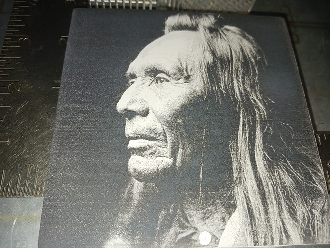

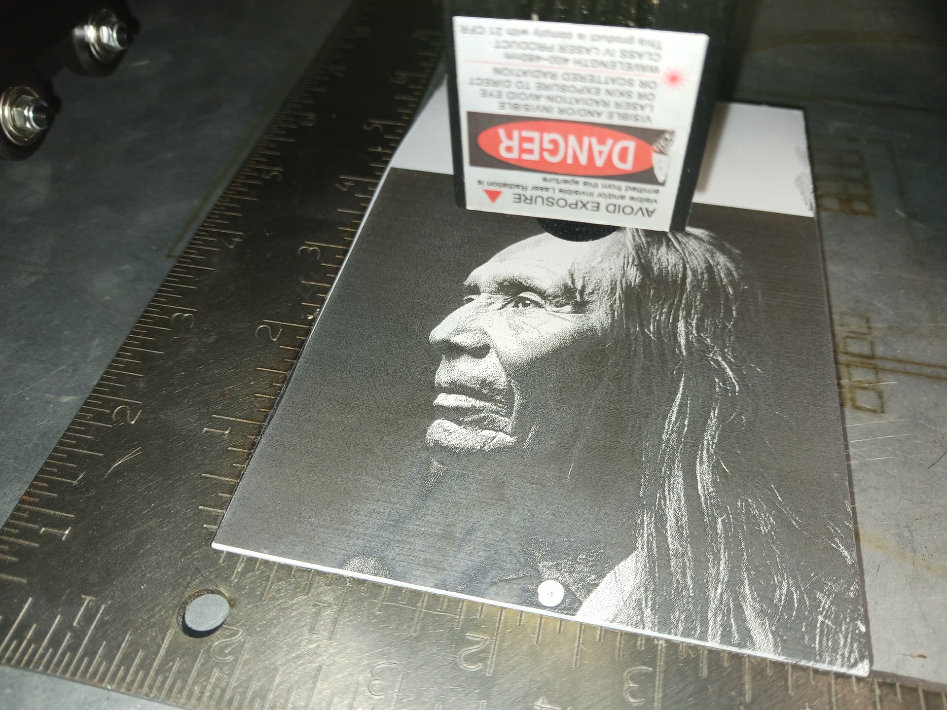

After replacing the original laser module with a little Banggood 2.3W laser, I’m getting a bit nicer results with it… it’s a fun little machine to play with!
1000 mm/min, 100% power, 300 dpi, Atkinson… it’s sooty, before paint removal. I keep a small personal fan gently blowing over the worksurface to clear the smoke/soot away from the lens to avoid fouling…
After complete paint removal with acetone… then washed with dish soap, like a dish…

I think he has his setup similar to mine in post 244… You can see the control board on the X carriage.
Mine is a 30 watt Neje…

Shown here, to buy some slack, I pulled the black 3-wire ribbon cable back a few links in the cable chain and chopped off the connector, after marking with colored tape which black wires matched up to the +12V/Gnd/PWM wires on the original laser module. I then spliced on a 3-wire pigtail with the XH2.54-3P connector commonly found on laser modules and/or their adapter boards, as shown here with a Neje laser module.
or directly to this Banggood 2.3W laser…
I’m sure most folks can do a neater wiring job than I’ve done here but I have a “stable” of Neje, Banggood, and Eleksmaker laser modules that can now be readily swapped out as desired.
Hope that helps. It’s not plug-and-play… but not too difficult either.

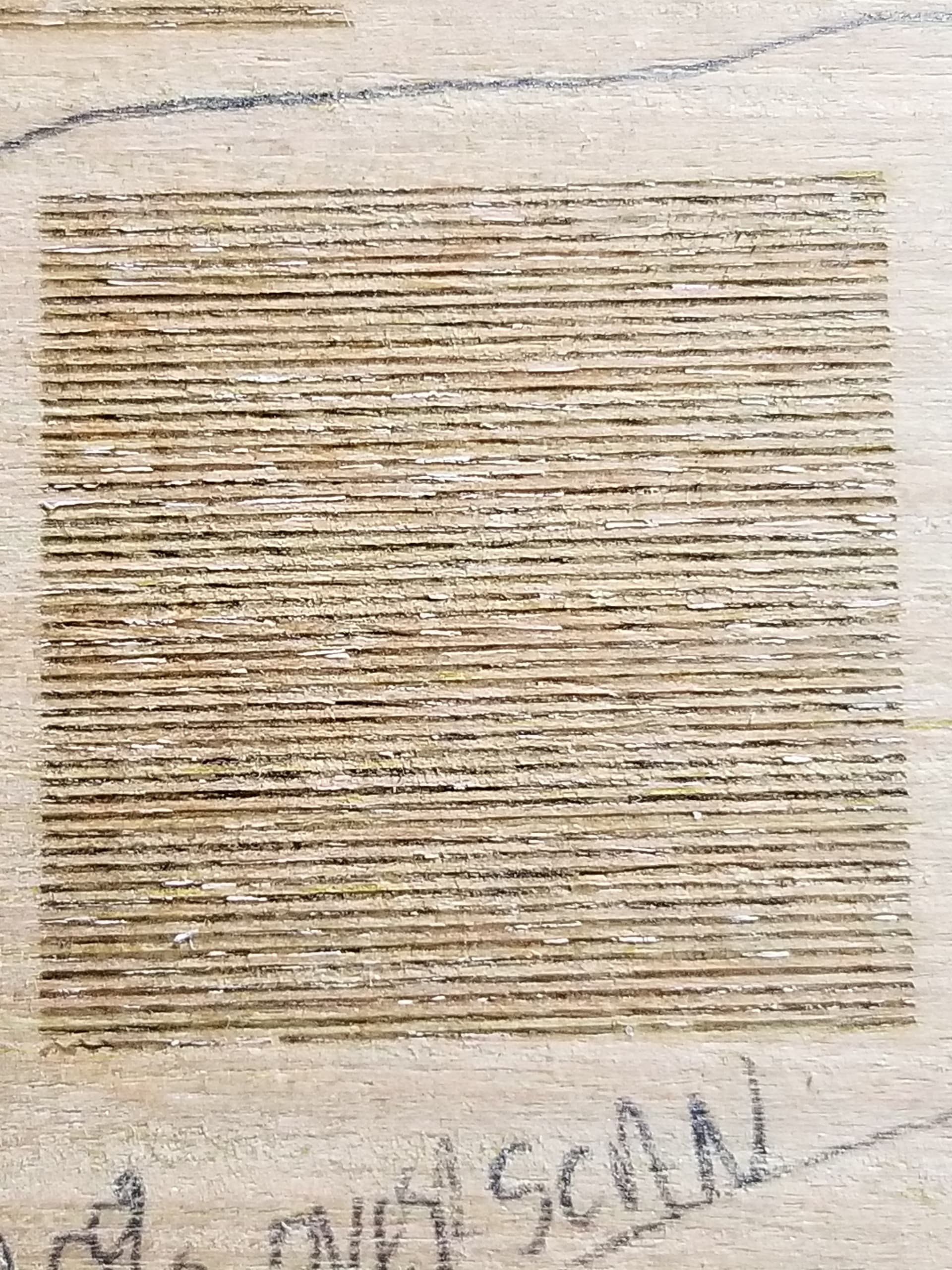

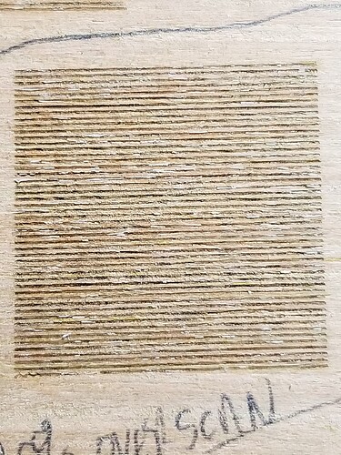

I have to set my overscan to 10% and it is not visible… Without overscan, you can see it wobble in the Y direction…
Here is a < 10 second video of the Y wobble.
This is no overscan
10% overscan…
About the best compromise…
Yeah, your video shows the wobble and it needs to be adjusted.

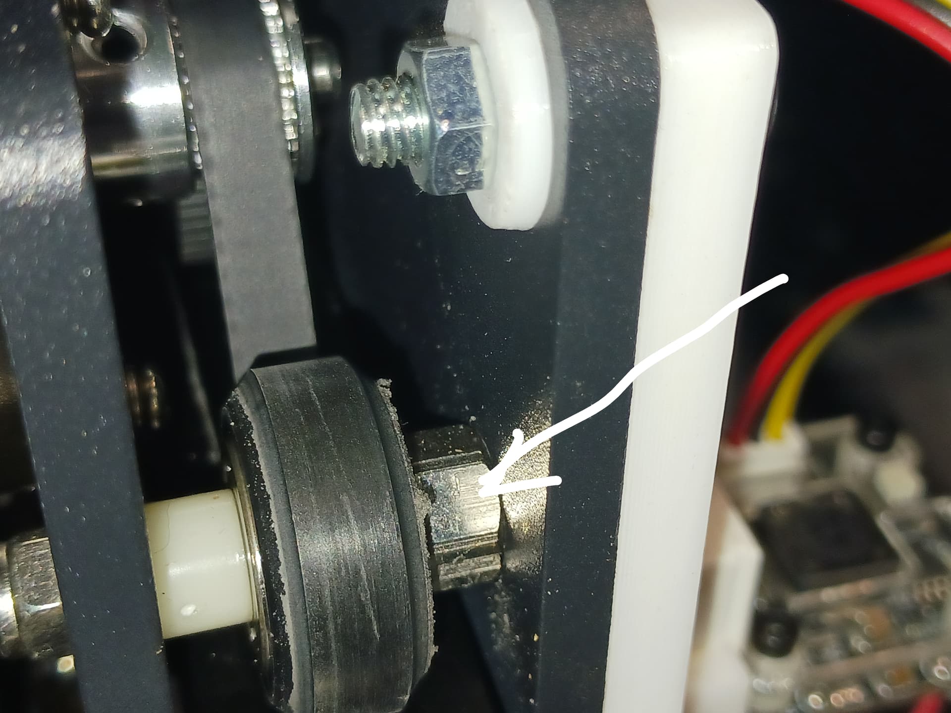

Note that the spacers on either side of the carriage’s four V-wheels are different… upper and lower. The lower wheel spacers are nylon and non-adjustable… and the upper ones are eccentric bushings and have a hex shape (under my white bushings).
Use an open-end wrench to adjust the wheels to be tighter against the V-slot extrusion.
You should be able to apply pressure from the bottom to push the entire carriage upward, away from the rail. As loose as yours seems to be, you should be able to roll each upper wheel freely with your finger. Now use the wrench to adjust the eccentric nut (< 180 deg) and keep testing with your finger until you feel the wheel just contact the rail and you detect some rolling resistance. Do that for both upper wheels and you should no longer see the wobble.
Note: you may need to slightly loosen the wheel/spacer “stack” to adjust the eccentric spacer.

I originally tried this, I could see where the ‘wheel’ axes bolts go through the frame and it wasn’t in the center … and somehow didn’t get the desired results…
After a little bit with it, I took the slack out, so thanks for the information… It’s much tighter now, so I guess I’ll have to go back a do the overscan/scan offset again and fix that…

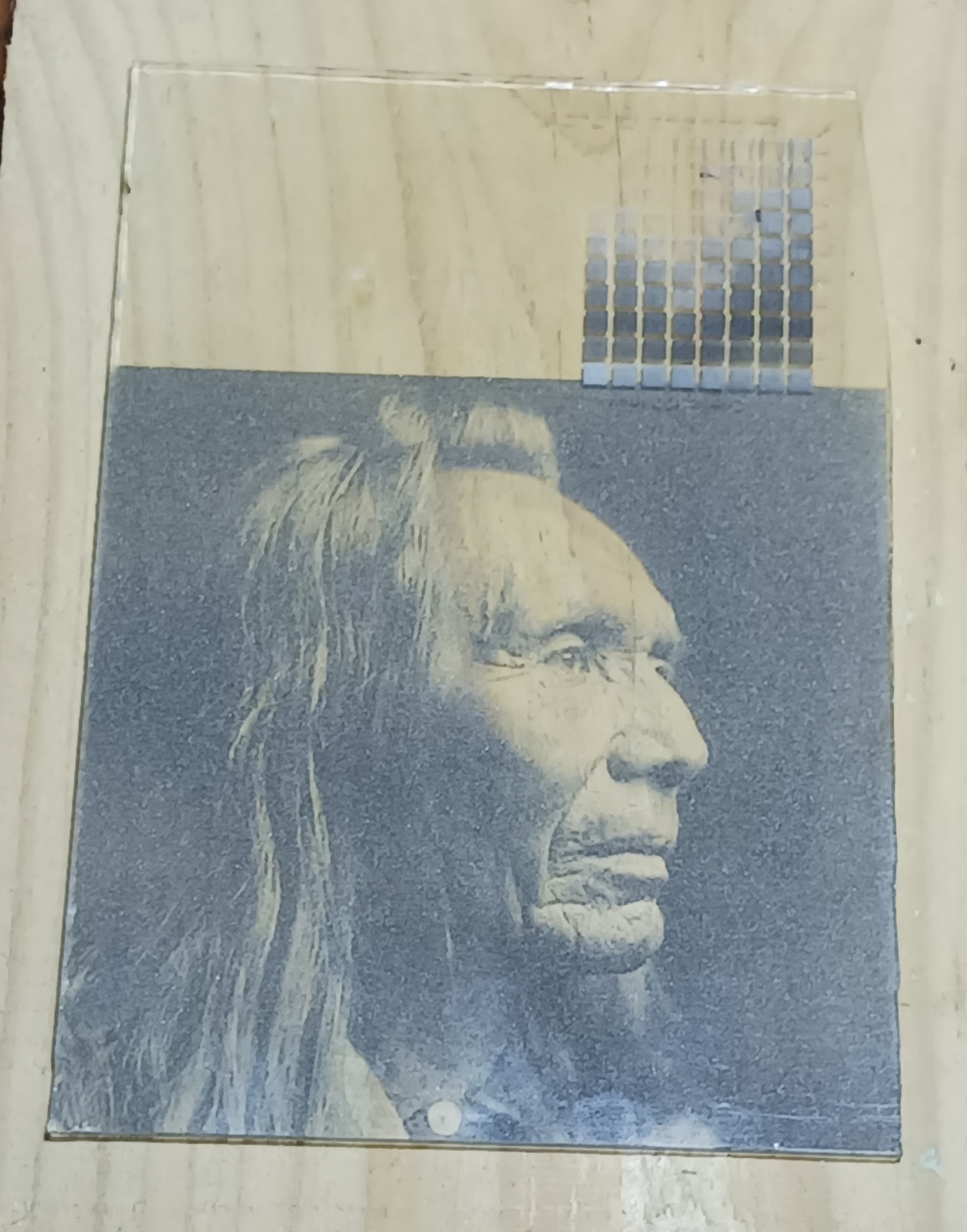

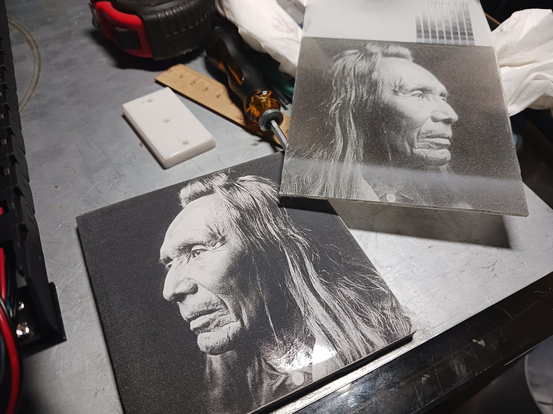

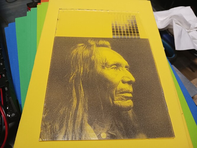

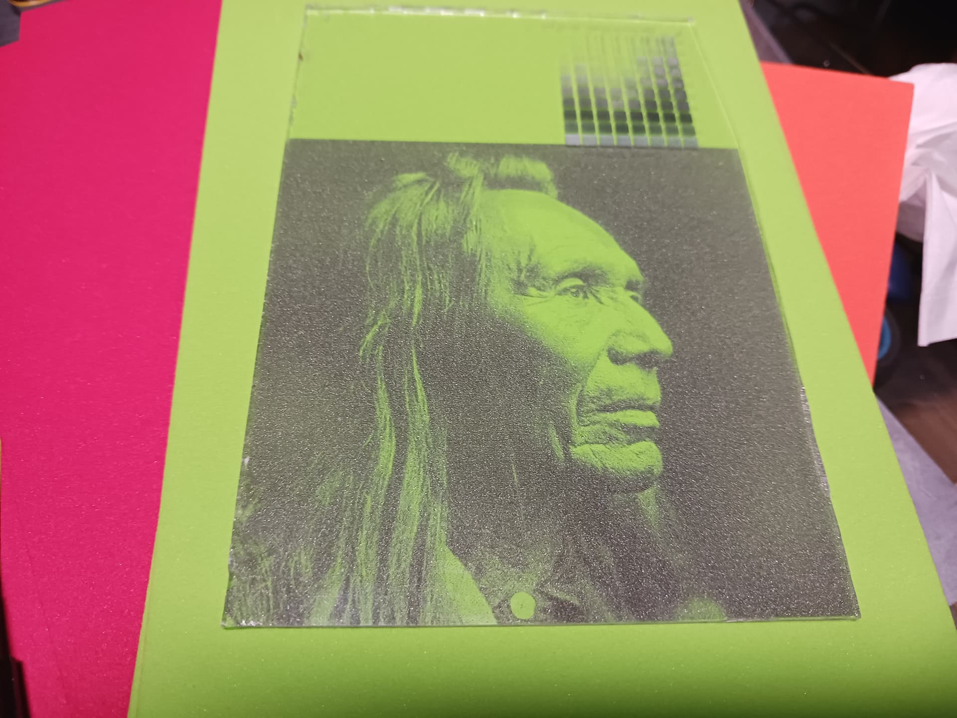

After doing the ceramic tile last evening, I decided to try transparent glass again… same flat-white paint and speed/power setting as for tile. After lasering…
Paint removed and held up against indirectly-lit wall…
Flipped to accommodate the glass thickness and placed on colored background…
Surely this should be good for something… :wink:

I had the same “wobble” + double image out of the box. On second day I took frame apart and discovered eccentric adjusters. After tightening these and all belts - all tight, no perceivable play of any kind at all.

Your rollers appeared to be worn out a bit.
How many hours (tiles?) you have on your machine?
Mine still looks new comparing to yours, but I’m just playing, no bulk work.
Conical races will definitely put more stress on the rubber. Then rollers will bottom out on the belts. Then the “wobble” will begin.
