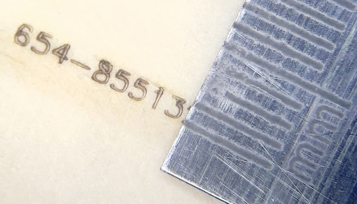

Fun stuff: JL1 microscopic engraving, 1mm tall serial number on birch. I use single line font at 1500mm/min - still minimal trajectory deviation.

that is crazy! Did you do it with the 1/32 microstepping hack or with the stock 1/16 microstepping?

Yes, this is the one with 1/32. But even if it is half of that - JL1 stock 1/16 still gets 80uStep per mm. I think result will be comparable.

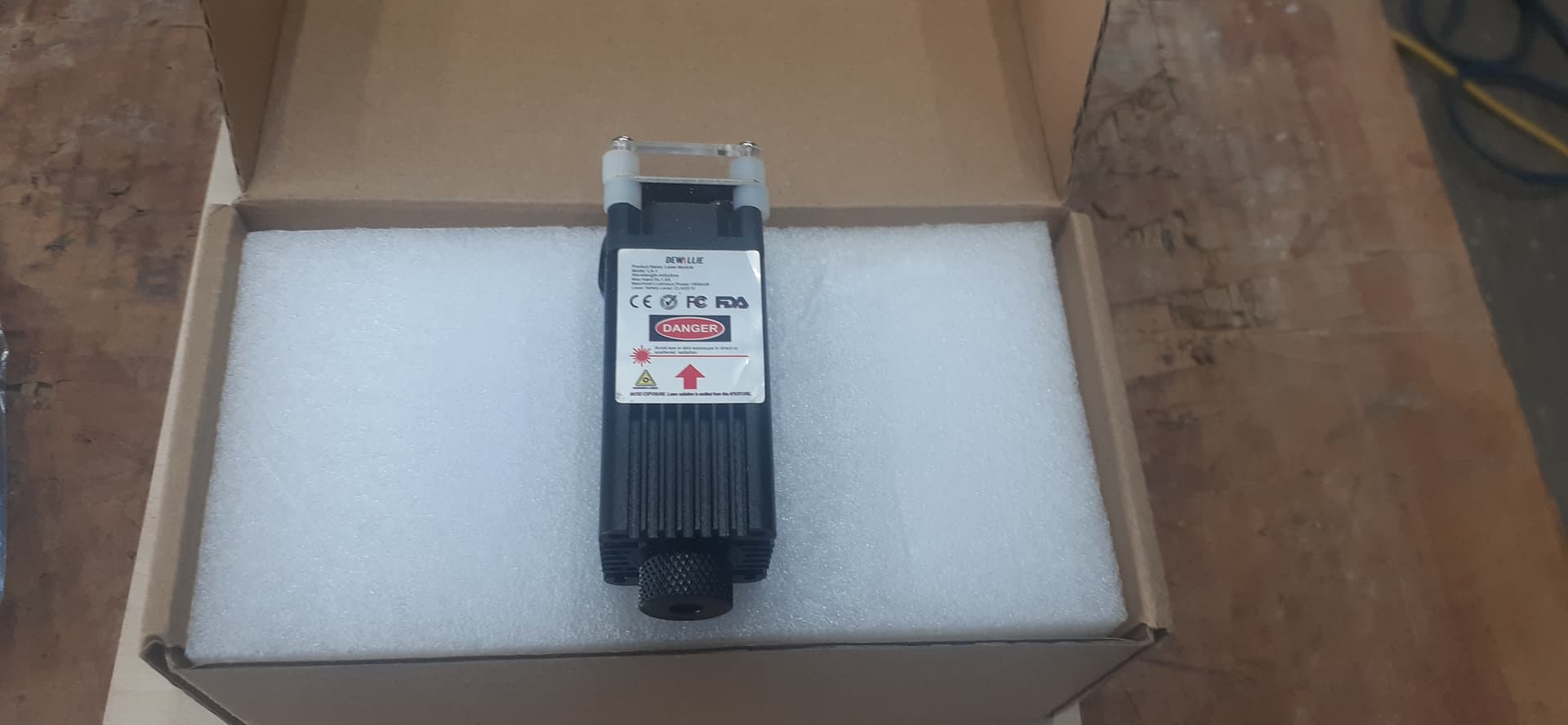

Ok,I made a mistake.
I bought this module for my Cenoz laser thinking it would be an upgrade. ($29.99 plus shipping)
I thought it would be plug and play, but its not.
I don’t know anything about wiring and don’t understand why there is what looks like a control board mounted to it.
So I need to get rid of it.
If someone wants to zelle me $25.00, I will ship it to you. (USA only)
Jan,
Does it have matching mounting holes pattern? If YES then you will not get more plug-n-play than that. Connector on JL1 laser is not common or standard. This one is common/standard. You need to address this adapter issue on JL1, or it will be the same with any other laser you get.
I understand you may not crimp, but there got to be somebody able to solder. You may buy pigtail on Amazon and splice into present laser cable. This would be the cheapest and simplest solution. Then you will be setup for most upgrade options.
What exactly the p#/specs of what you are thinking of to offload? (you may rethink it).
I think this is the one I’ve posted earlier when it was on sale.
Hi Sal.
Yes it is the one that you posted about earlier so I can only assume that the holes line up.
Part of my problem is that I don’t understand why there is what appears to be a circuit board attached to the top of the module.
And again, I’m just not comfortable with the wiring portion.
