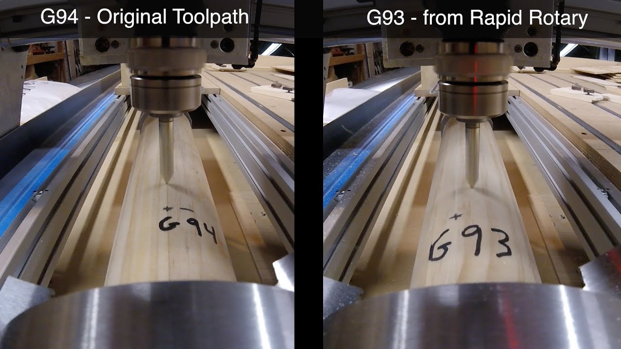

@mada , I agree with Oz @LightBurn .
However I’ll add that the slower feedrate you’re experiencing when performing coordinated G1XA motion may be due to a bug in Neje’s grbl controller firmware. I ran into the exact or similar problem and it lead to there being a bug in my grbl controller firmware, but not a Neje controller in my case. I am running a customized version of an open source grbl, however the bug was found to also be in at least one other grbl version since they seem to have a common origin. There could be more split threads of grbl versions with the bug also, such as the Neje version. If this is the case, you can refer Neje to the details and fix here https://github.com/grblHAL/core/discussions/241

and vote for this feature: Add option to use G93 Inverse Time motion mode · LightBurn

  1. Like Oz @LightBurn has said previously, you can’t drive the A axis faster than its maximum speed of 15,000deg/m (250deg/s). The gcode is produced in deg/m and is relative to the programmed circumference of your cylinder on the A axis and your desired surface speed of 9000mm/m (150mm/s). Line 58 of this file is driving A at F103132deg/m, so it will only move at max of 15000deg/m, and naturally that motion will run much slower relative to other G1XA motion even if your grbl does not have the G94G1XAF bug.
  2. your shape design is fairly complex for trouble shooting a motion problem, suggest you use something very simple to diagnose the problem. I’m providing a simple test case here.
The shape photo and .lbrn2 file are for you reference and extended use if your choose. You can simply run the .nc.txt file, you don’t need anything in the A axis chuck, the laser power is zero. Motion begins at current position, make sure your laser will clear the chuck if it mistakenly moves over it, chuck on left, X moves right from current position. I used a cylinder circumference of 50mm to gen the code. The lines in the the shape are all 50mm length, each one should “cut” (traverse) in approx. 3 secs. If the 135 deg line (last one to cut) does not traverse in 3 secs but rather 22 secs, then your grbl controller has the G94G1XAF bug; Neje will have to fix it. They can use the grblHAL link as an example of the fix and grbl code/bug definition.

I’m not sure the previous questions matter if you follow the next step. Are you confirming my test case proves the G94G1XAF bug in your Neje machine? If not, what were the results of running my test case?
Agreed. Contact Neje, give them the simple test case to proved the problem, and ask them to fix it please.
