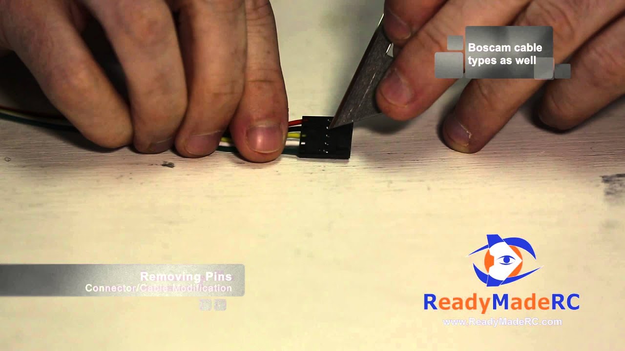

The correct place to do this is at the 4 pin connector… IMHO … the easiest place is probably the white motor connector.
You know how to find the pairs… whatever you find to be the path of least resistance.
These connectors release the pins pretty easily when you can press down the flange that locks it in place… Usually a sharp object…
Here a 6min video… if you haven’t…
Good luck
