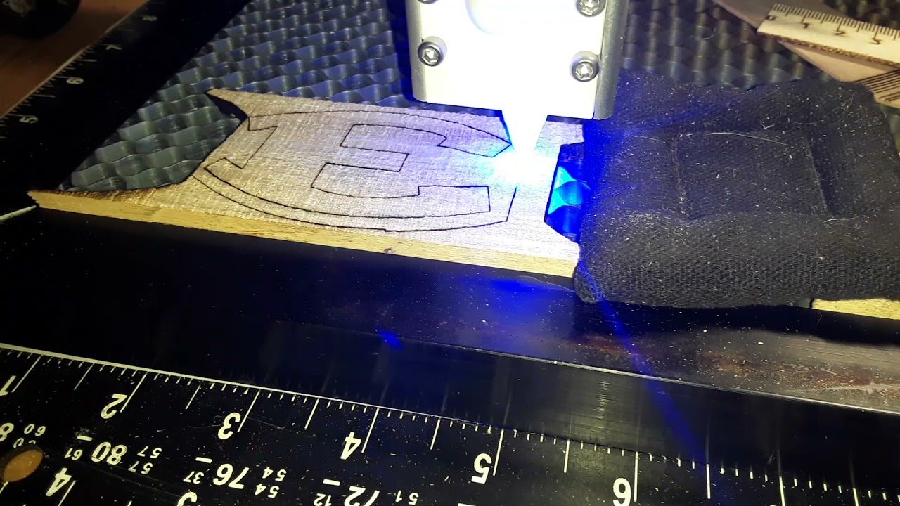

Not the best video but gives a clear view of the NEJE A40640 ~15W laser module air-assist in action. Bandsawn ~5mm willow plank (not very well-centered) cut in one pass at 150 mm/min and 100% power… the piece fell out on its own when picked up
– David
The Neje A40640 is a dual diode laser with Fiber to a FAC Lens (Fast Access Collimating Lens -Aspheric micro-cylindrical lens), It is two 7.5W diodes according to the manufacturer that is supposed to have an optical output of 14-15W. Realistically? Max power scientifically is about 14.2, but I would say this is closer to 10W. I own one.
The optimum focal length after running tedious ramp tests on mine is 19mm using an endoscope to find the best distance. If you want to cut wood, you would drop the focus by 1/2 the thickness of the wood. So if you were cutting 4mm wood, your focus would be 17mm.

My settings to cut 3mm birch plywood :
  • 150mm/min
  • 100% power
  • 1 pass
  • focus : 17.5mm from heatsink (laser focus length is 18mm).
Works perfectly everytime, piece drops neatly onto the bed.
See attached cut tests.
FYI i do NOT even have an air-assist when i did those tests ; with an air assist i might increase the speed by 50 to 100mm/min i guess.
