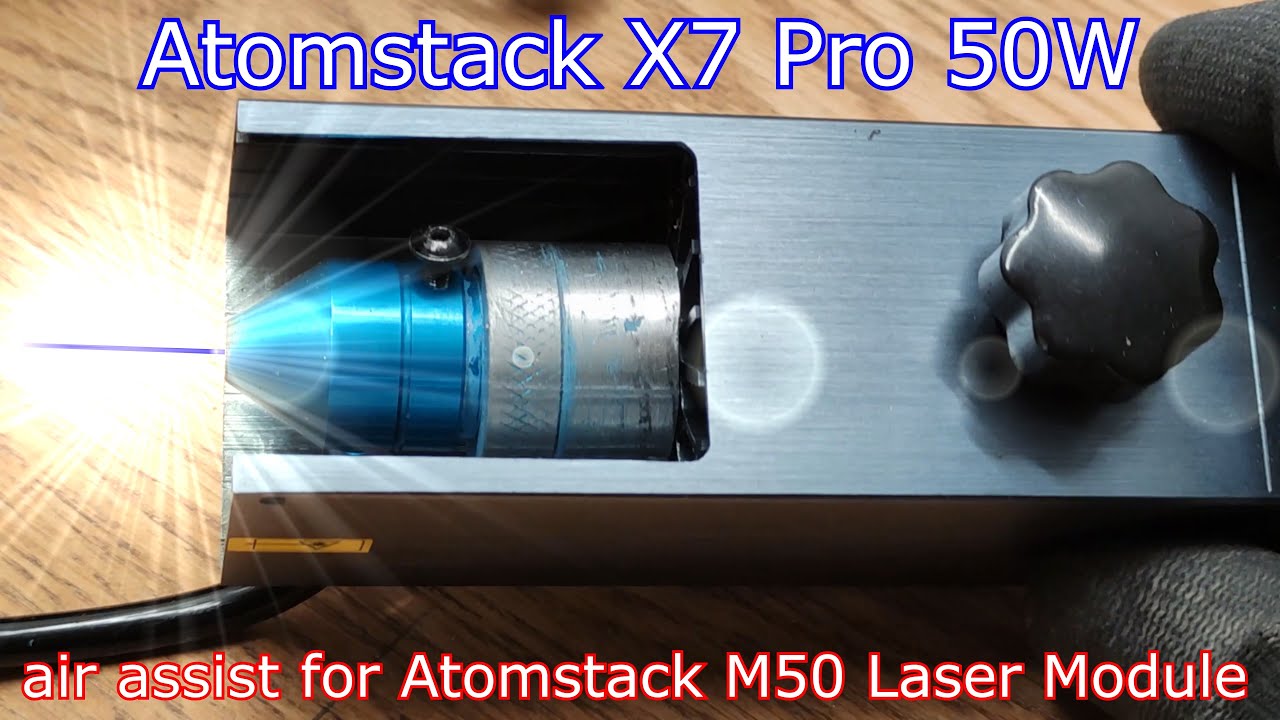

There’s a big demand for air assist for the new AtomStack X7 that just came out, and most people don’t have the ability to 3D print. Do you mind if I send them your way when they ask about it? I’m sure $20 would be fair (or whatever you deem) for the 3D printed parts.
I assume you are talking to me since I posted above about my printed air-assist for Neje lasers…
I don’t have any AtomStack modules/drawings to get critical dimensioins from. If you can point me to some dimensioned photos/drawings I’ll be happy to take a look but all the photos I see have everything surrounded by a shroud/shield that hides all the module details.
To be honest I think it’s the same module, just rebranded as AtomStack. Looks similar but might not be. I see lots of people asking about it and no one has an air assist solution. Maybe they can connect with you and you back and forth. It would go great on an Etsy store.
Looking around I found this… not printed but a reasonable DIY air-assist solution for AtomStack X7 Pro already exists
Nice find! I’m sure it’ll help others.
