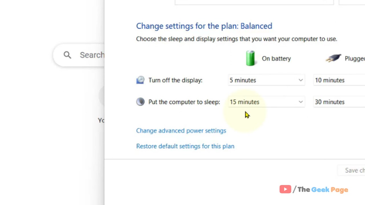

When referring to the users manual about this it gives a solution to change power settings in Windows 10. The problem is I’m running Windows 11 which does not give me the same options in the control panel under the power settings. Does anyone know what I can do or how to change the settings in Windows 11 to fix this problem

I am presuming this is referring to the message in the console regarding my problem. Someone please correct me if I’m wrong.
Taken from Lightburn user manual troubleshooting:
USB port sleeping
If it thinks a connection is idle, Windows can put the port
into a power-save mode, which can make your device stop
talking to it. This is especially common with laptops.
If you are having issues where you often lose the USB
connection after a period of time, try the following:
Windows 7: Support Home Page
answers/detail/a_id/14917/~/disable-power-management-onwindows-7-machines 54
Windows 10: https://www.windowscentral.com/how-preventwindows-10-turning-usb-devices 202

I think this is what you want to do… stop it from timing out…
Let us know if it fixes the issue…
