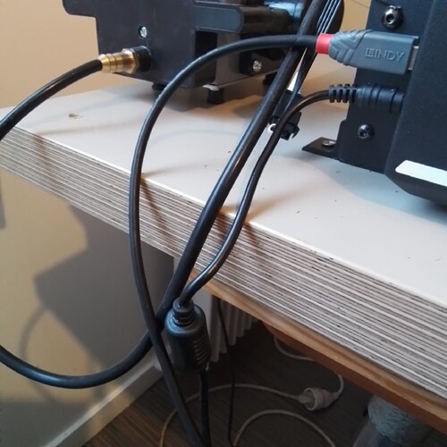

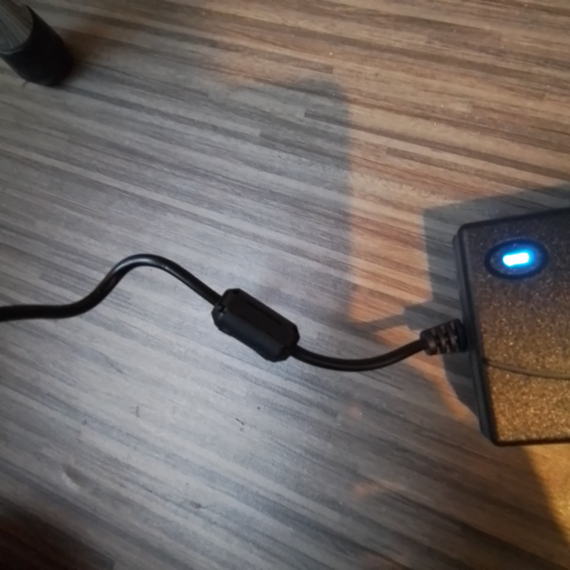

I can’t finish my post on grounding and emi waves (if an administrator can contact me, so I will continue my post here. As asked here is how I filtered the EMI, using ferrites, they simply clip near the connector you want to isolate.
Here at the outlet of my power supply.
I did the same for air assist etc. By the way I switched to a high quality OFC copper shielded USB cable quality.

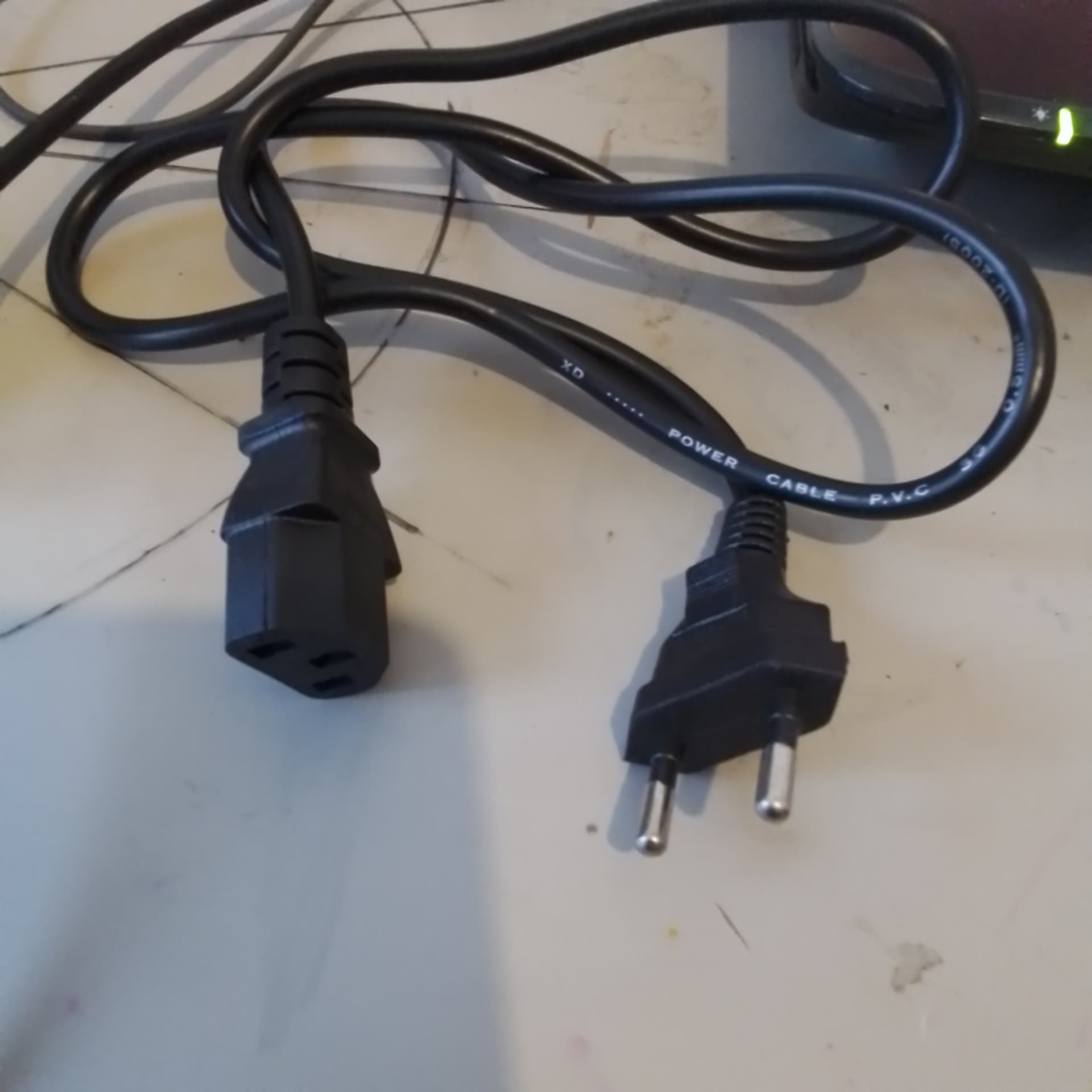

I received my new 4A power supply, which completely removed my worries about stopping in the middle of work. In fact when I engraved at 70% of power all the work stopped without reason, suddenly problem solved BUT
There is still a GOAL…

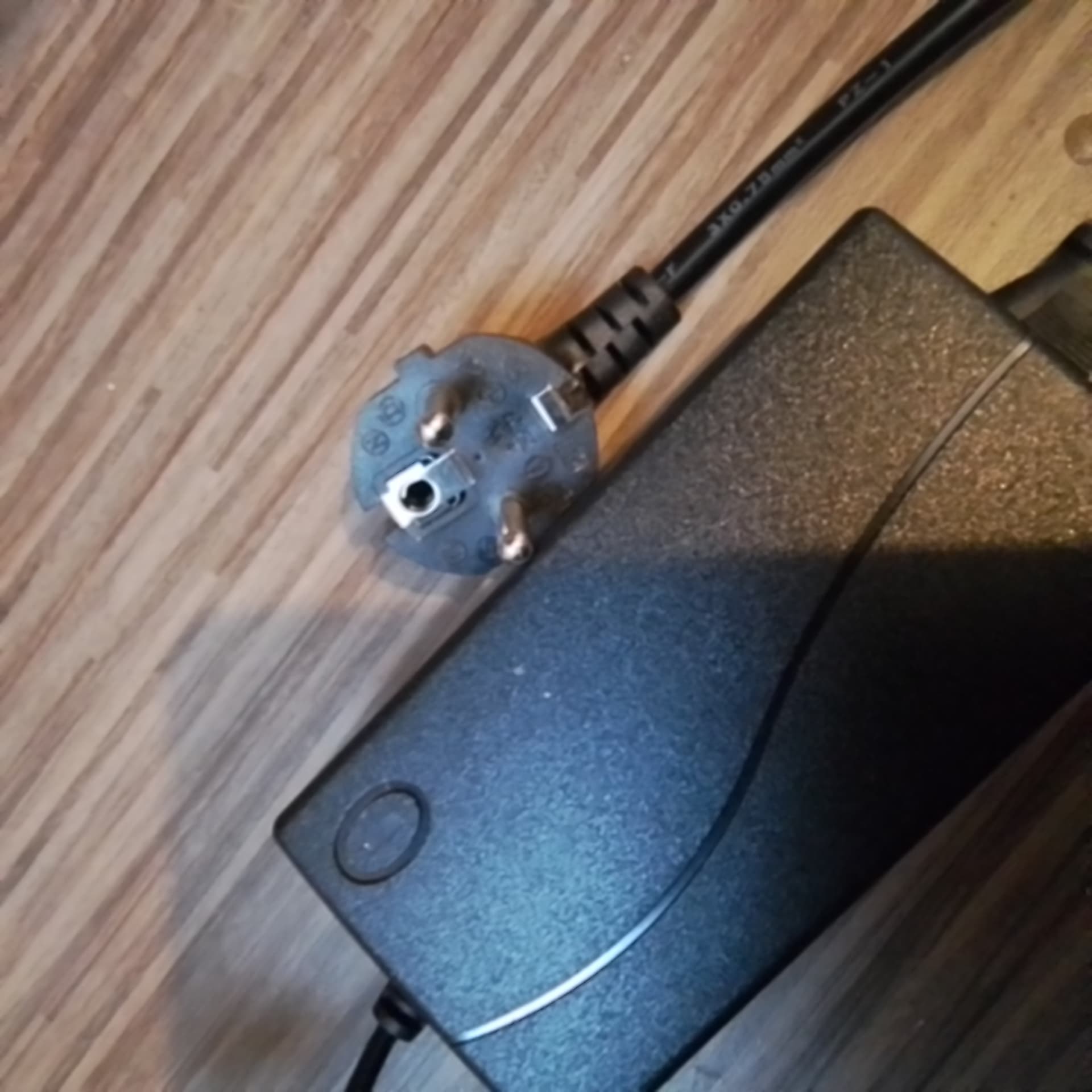

I focused on the original power supply, which being undersized, I discovered a major concern and DANGEROUS!
here is the socket for the new 4A power supply.
Standard socket with a well-sized three-conductor cable, 1 phase, a neutral and an earth.
Let’s compare to the original shot!
One side seems normal, three holes supposed to be 1 phase, a neutral and an earth, BUT it is vicious and dangerous as desired,
Look at the other side, the power outlet, a phase, a neutral and OOPS no earth!
What would happen if there was a problem, overheating, electrocution, fire?
I am lucky my home is equipped with a differential circuit breaker (mandatory in France, but especially old homes are very often without one), which would prevent me from electrocution or a fire, before I could feel anything, I tested with a nail driven into the socket (don’t do that at home or anywhere else!!!) I am still alive because the differential cut the electricity in 1/1000th of a second.
In short, all this to say that the machines are often sold for savings, with power supplies specially sized in amperage, unfiltered, not EMI shielded, and without grounding! To good readers.
Not enough information to make a safety determination. Not all devices must be grounded. Neither of my laser power supplies (USA) came with a ground wire. The risk of starting a fire with the laser head is much greater than starting one with the power supply.
We do not have the same electrical standards, here we are in 220v and, beyond a certain electrical power, a 3-pole conductor is MANDATORY, as is the use of a differential circuit breaker.
Read my post carefully, the passage with the photos of the original socket which half copies a 3-pole socket (just and one plug and not two) and the socket of a quality power supply with poles at each end. With a 2-pole socket that could be disconnected in the event of a problem. There is not even the bare minimum to protect you from electrocution (grounding).

I did read it carefully. I am also aware my 120v can kill you just as fast as your 220v.
Terminology is different, but devices are the same. The real question is whether or not that device is approved for sale in your country. Made In China means it may not be, but as the consumer, you have to protect yourself. If you do not feel safe, send it back and get an acceptable replacement.
90% of machines or almost 95% of their components do not come from Mars, but from China,
Yes, but do they meet electrical standards mandated by your country?
the goal is to warn people and make relevant observations to improve the machines with simple updates, the pleasure of engraving but also the safety of users. I am an informed person due to my technical background. And I’m not kidding about Chinese equipment, it is omnipresent in all areas, even in rockets and satellites, as in processors and other cutting-edge uses of technological advances, and what everything that comes from China has not invaded all the countries of the world, technical or electrical standards respected or not?
Likely the standard is to the receptacle and not to the actual device. Where exactly are you located ? You are correct with most EU plugs have to have the safety insulation on the plug terminals. Most china plugs will not have compliant cords… even worse when you open the power supply and find there is not adequate mains separation / isolation. No ground is usually not a safety concern as much as actual mains isolation.
If you are concerned I would simply replace the power supply with something compliant to your local electrical code.

All of this doesn’t ensure safety. Only if you get across a hot pin and earth ground will the gfi be able to detect it.
If you get across the mains, you’re just another load for the 240V system.

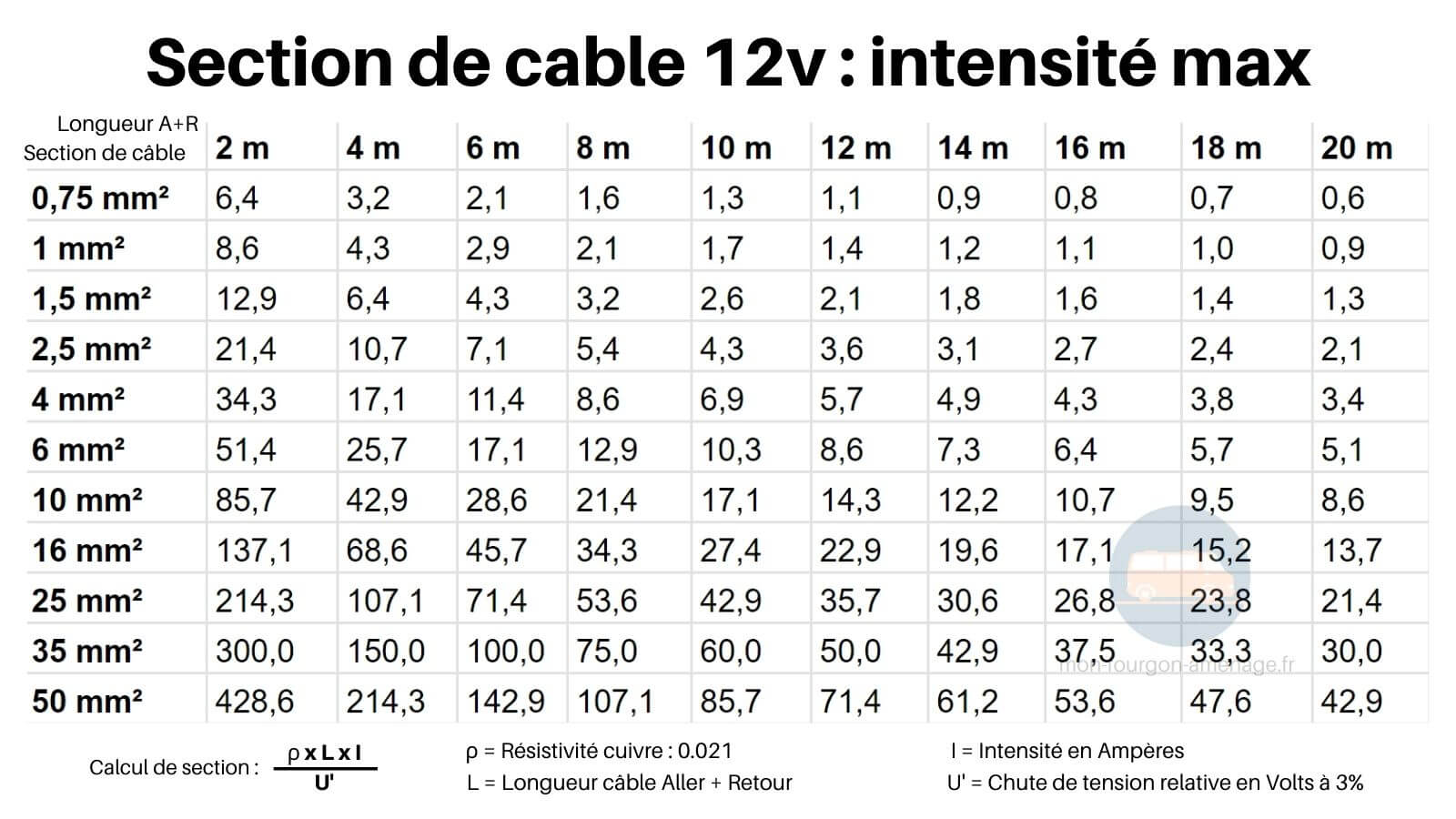

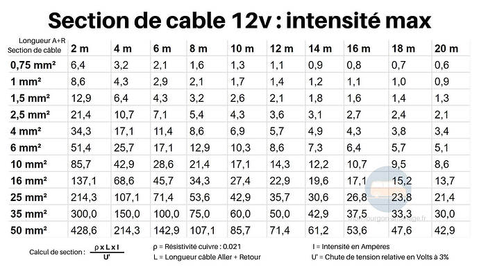

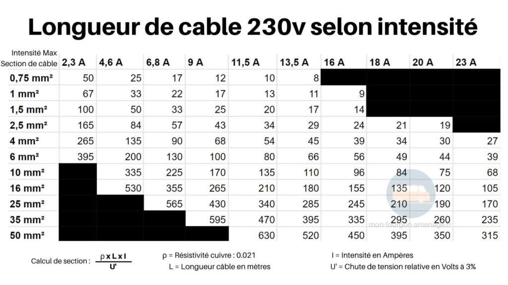

I see what I think is a 0.5mm wire guage on the photo of your power supply cord which as far as I have read is the lower end of CE guage.
My question regarding this is. Does a smaller guage wire generate more heat, and therfore give off more interference…and of what kind.
I have located a company that sells plated USB cable conectors that use gold and nickel for good clean data stream and speed.
I also did some very interesting reading since your last post on this subject and found conflicting opinions. I can only assume it is related to individual, environmental and set-up situations.
Good evening and thank you for reading
This is a very, very complex subject that can go as far as the quantum level!
To answer your question simply, you should never use wires with a lower section, risk of fire! Current folds in a thinner cable create, in addition to EMI waves, significant heating through a combination of effects such as Jouls, Foucault, Laplace, Lorenz,… it is very complex,
A conductor section is adapted to a certain voltage and has a cert in number of amperes, i. it is obligatory to respect these standards of section of wires.
The high voltage cables of the electricity pylons are very thick, there is a reason for that! Conversely f Passing a low voltage through a large cable results in a huge loss of current, the electrons are slowed down or even completely converted into heat, which is itself dissipated in the conductor and therefore not necessarily observable with the hands.
and the mandatory standard in France with the cable section in mm².
