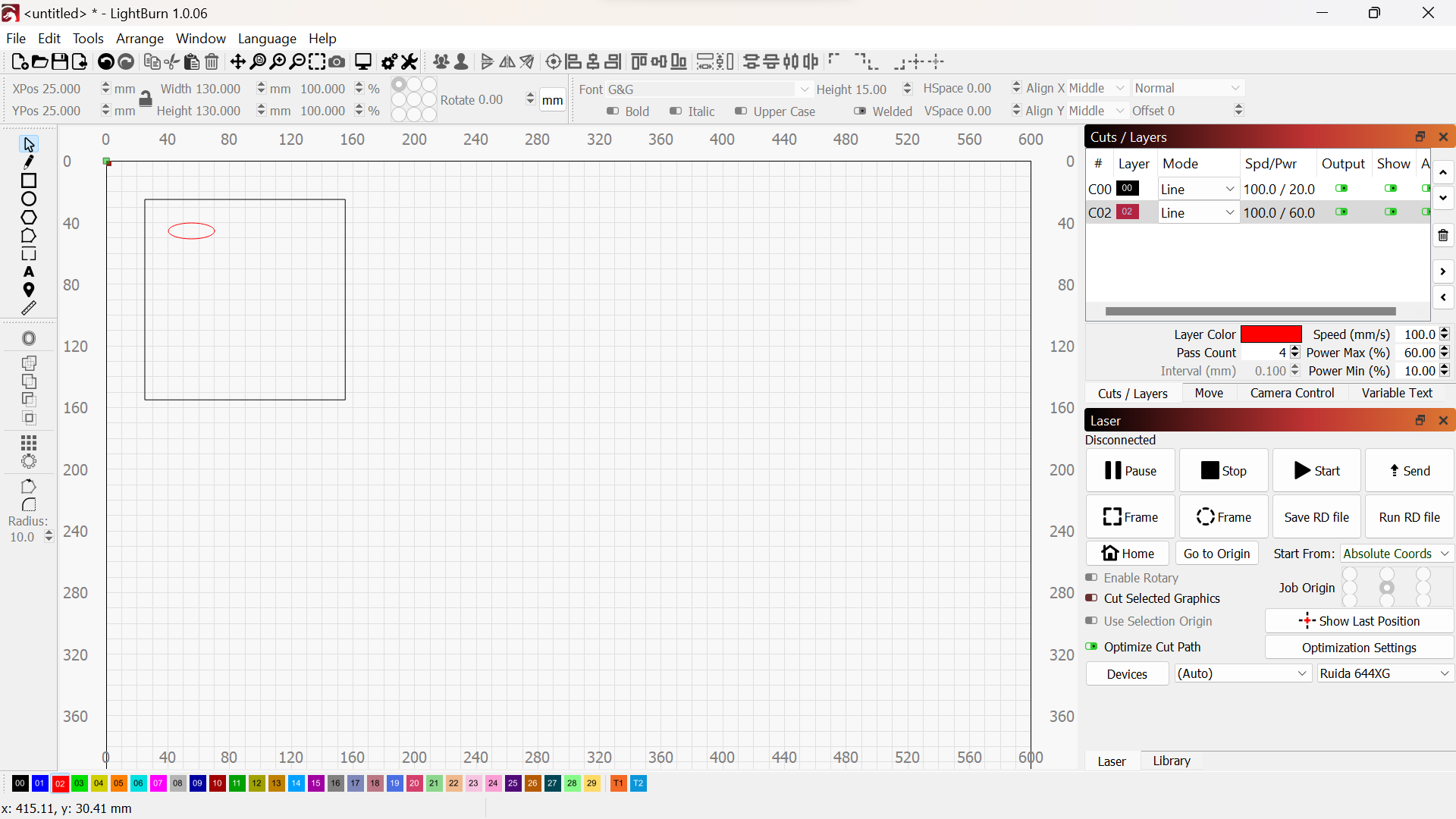

OK, so now I want to cut something from both sides, say a simple oval, it doesn’t matter. I placed the oval to be cut in a square that doesn’t cut, but that I can use to place the drawing in the upper left corner at 0,0. I then cut one side of the material, with no problem. Now comes the hard part for me! No matter what I do, I can’t get the laser to properly recognize that I have dropped the drawing down 255mm (the inside of my jig) and flipped the drawing. The laser wants to cut too far to the left and too far down or it just wants to cut in the old place depending on what coordinate system I use, even though the drawing is now showing that it is 255 down the Y axis. The Absolute choice just recuts in the same spot as the first cut.

You should use Absolute Coords for both sides of the cut.
When using Absolute Coords the design should burn to the matching location on your bed as it’s located on your workspace in LightBurn. This is irrespective of when trying to flip the material. A shape positioned at 10,10 on your workspace will always burn at the corresponding 10,10 location on your bed. Similarly, a shape positioned at 10,50 on your workspace will always burn at the corresponding 10,50 location on your bed.

I’m trying to understand in what way the behavior is somehow different on the flipped side of the burn? Are you saying somehow that the burn is occurring in an unpredictable location but only on the flipped side?
If so, can you do this:
  1. Take a full screenshot of LightBurn with the front side setup. Please save and upload the .lbrn file here also.
  2. Take a full screenshot of LightBurn with the reverse side setup. Again, please save and upload the .lbrn file.

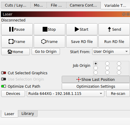

Yes, that is what I thought, but it doesn’t do that. I got it to move down in the Y axis now, but not to the specified location. Do I have to change which corner it uses in the 9 dots in the top menu or what?

What you are referring is the job origin… if you run absolute coordinates, there is no job origin other than 0, 0
If you use another start from value, would need to change the job origin in the laser window…
If you want to go ahead with his instructions… use absolute coordinates for both halves. Move the position of the job to the exact location of the position of the flipped piece. Where ever it is on the workspace it will be placed for the laser. You can enter these manually at the top left…

if you post screenshots of LightBurn during front and back side burns it should be straightforward to determine what’s going on.

The fundamental setup seems okay.
So to confirm, you’re saying the jig that you were using was positioned such that top-left corner was exactly at the 25,25 mark, and then had another horizontal component at coordinate 25,390? So the overall height of the internal portion of the jig was 365mm?
That is why a tool layer is used. Just to use as a reference… you have T1 and T2 on the right of the selectable layer/color…
Yes, exactly.
