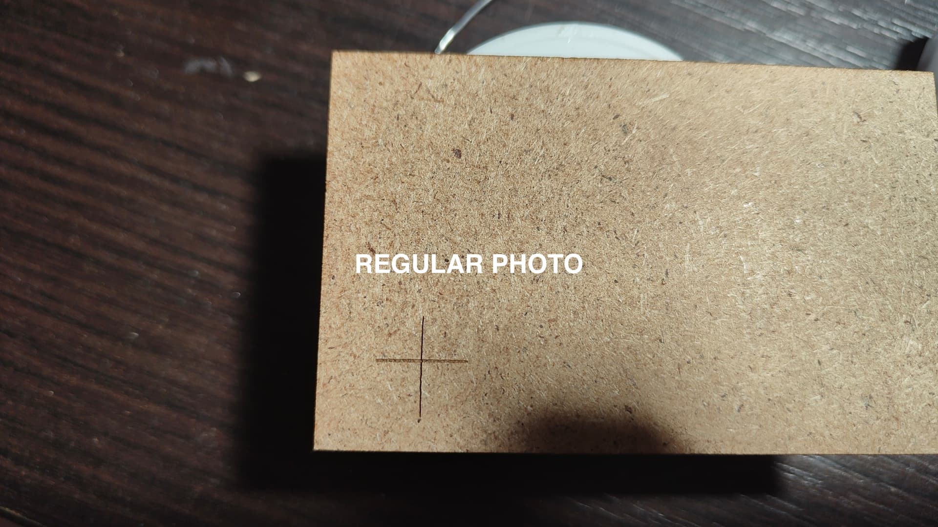

I recently purchased the ACMER 20W Diode Laser Module (ordered directly from their official website) as an upgrade for my ACMER P1 S PRO. I was previously using their 6W module and was very happy with it, but wanted more power.
After installing the 20W module and running some tests, I noticed a serious issue:

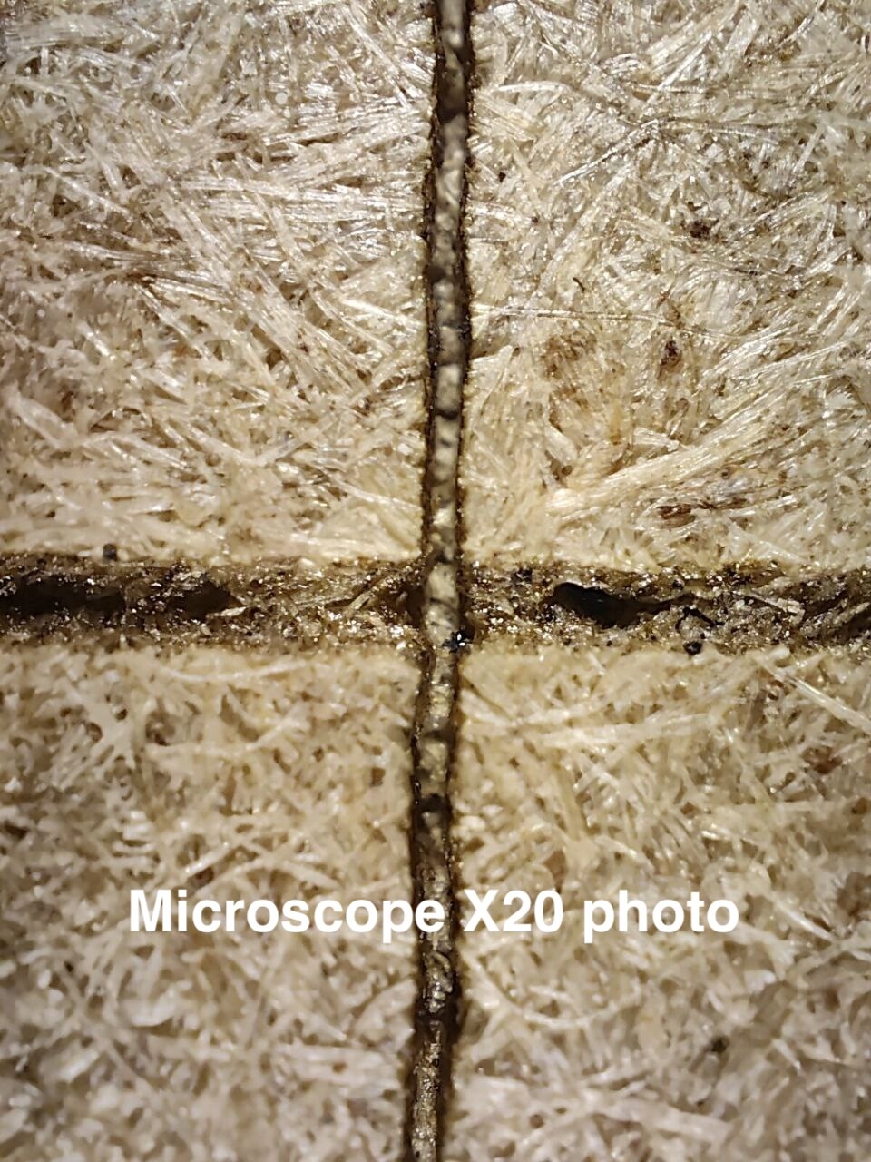

- Vertical lines (laser moving along Y) engrave perfectly — thin and deep.
- Horizontal lines (laser moving along X) come out blurry and wide (~0.2 mm) — almost 3× wider than advertised.
They claim a spot size of 0.06 × 0.08 mm, but I’m clearly getting something like 0.06 × 0.2 mm, which causes major distortion, especially when engraving text or patterns requiring precision.
I did all the proper setup:
- Correct Z-height / focus with the original metal gauge
- Tested on MDF and black anodized aluminum
- Tried various speeds and powers — issue is consistent
- The spot shape appears stretched into an oval or bar
I reached out to ACMER support several times, but they dismissed it as “slight deviation due to material burn” or claimed that “advertised spot size is only from optical measurements.” They refuse to acknowledge that this might be a defective module or lens alignment issue.
I’m honestly disappointed — this doesn’t feel like a “slight deviation,” it’s a massive distortion that ruins precision work.
