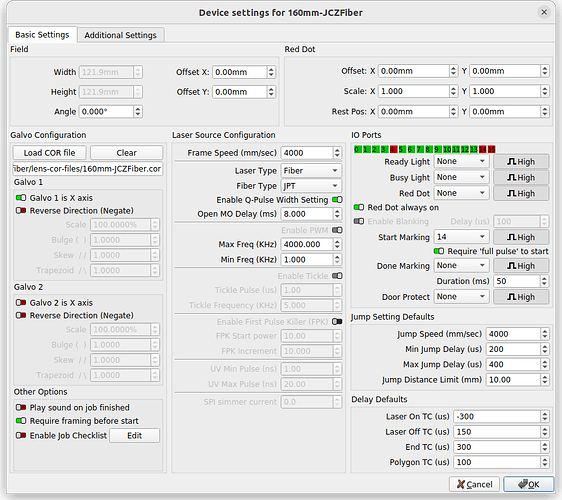

So, it might be helpful if I start at the beginning…sorry. I’m trying to get a bright mark on some anodized aluminum. I can get it on the business sized cards no problem. On these parts I’m not having any luck. So I was playing with the kHz but couldn’t get over 80. I found the setting in Lightburn to change it but someone said I needed the markcfg7 file. Now it looks like I have the file installed but I have no way to know if 600kHz really is 600kHz. I still can’t get a bright white mark…A competitor can so I know it’s not all the anodizing.
Some machines have a more limited range of frequencies that are available. Some machines have a fixed pulse width or one related to the frequency and not user adjustable.
My source is a JPT MOPA M7 and will accept frequencies of 1 to 4000kHz, whereas many other machines have it limited to 600kHz and some to less than that.
Which machine/source do you have and what source is your device settings set?
50W JPT should be up to 600kHz
Is the device setting configured for a jpt source?

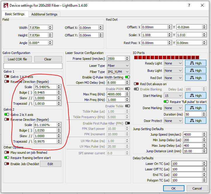

I don’t know for sure there is any way to make sure after the fact. If you’d have taken a screen shot of your Device Settings before, you could see if it changed any of the Bulge, Skew, etc. settings for your galvos, which would all come over from the markcfg7 file.
That area is grayed out and useless when you load a cor file…
OP is asking about loading a markcfg7 file though, not a cor file. :slight_smile:
Yes, you are correct… I use both import markcfg file and cor file…
The best way is to drive it around or engrave a box or something… basically use it.
