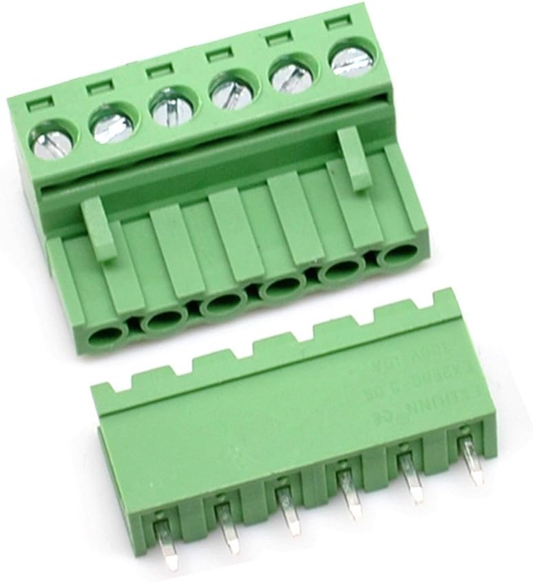

Do yourself a favor and order
You only need the female…
