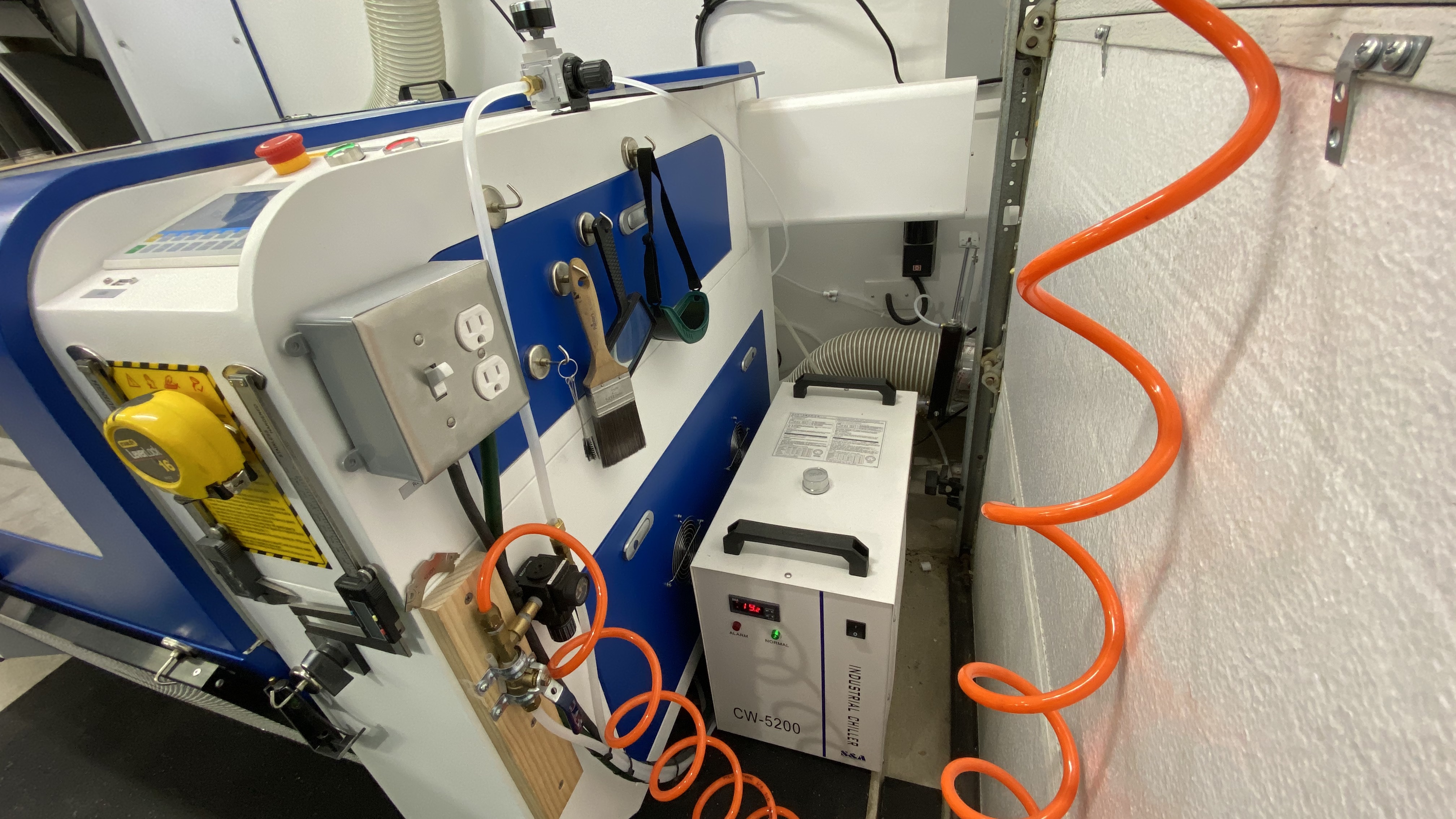

I can say for certain that the 5510 can with my Thunder Nova 24. I’d be surprised if the larger one couldn’t, though it will depend on the size of the output nozzle you have - A smaller opening will allow for more pressure buildup.
Thank You for the reply … and you set the regulator on the Compressor to 40 psi right ?
Brian
I’d highly recommend the installation of a low range pressure regulator at the machine. This will provide much easier tuning of the desired air pressure for the specific job you’re running.
My air is plumbed in the shop delivering about 100 psi to all of my hose reels and to the laser.
At the laser, I have two regulators. One regulator controls the flow specifically for my blast gates linear actuators (which are automated to open when the fume extractor is running).
The second regulator is plumbed to the solenoid that is controlled by the Ruida and then routes to the nozzle.

I’m not sure what you’re asking about specifically, so I’ll guess from the picture you referenced.
The blast gates and the actuators were purchased from amazon.
[Blast Gate](POWERTEC 70227 6-Inch Aluminum Blast Gate for Dust Collector/Vacuum Fittings https://www.amazon.com/dp/B071RSDH23/ref=cm_sw_r_cp_api_i_GQ.zEbWKWHTYA)
[Air Cylinder](Sydien 16mm Bore 150mm Stroke Air Cylinder Double Action with Y Connector and 2Pcs Pneumatic Quick Fitting (MAL16x150) https://www.amazon.com/dp/B07DYNXDV8/ref=cm_sw_r_cp_api_i_nU.zEbWH5GPM1)
I made the blast gates pneumatically actuated on my own by creating my own brackets.
The air lines to the actuator are controlled with an electric 2 position 5 way solenoid valve Solenoid Valve along with the addition of a muffler / speed control.
[Two Way Valve](Baomain Electric Solenoid Valve 4V210-08 AC110V 2 Position 5 Way Inlet 1/4" https://www.amazon.com/dp/B01D9GXJSQ/ref=cm_sw_r_cp_api_i_kZ.zEbBS8NEN4)
[Speed Control](10pcs 1/8 Pneumatic Muffler Silencer Filter Air Flow Speed Controller Sintered Bronze NPT https://www.amazon.com/dp/B07D47VNKP/ref=cm_sw_r_cp_api_i_TV.zEbA5C1XWP)

I should note that I added an air intake plenum to my machine and that my machine is almost completely sealed when the lid is closed.
I have an outside / fresh air intake as well as fume extraction connected to my machine.
My fume extractor sits outside of the shop built into the exterior of the wall.
The blast gates on the intake and extraction are critical. Otherwise hot humid air will condense inside of the machine (because the machine is in air conditioned space).
