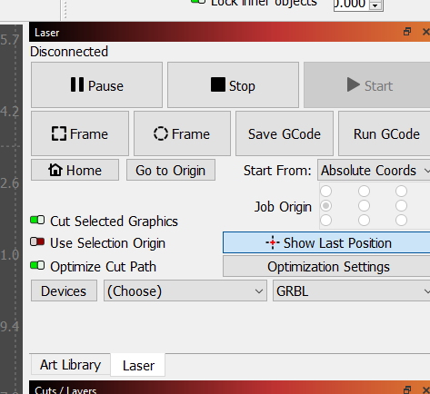

I am new to using a camera with Lightburn. I have the Genmitsu L8 40W. I can get the camera working OK and can see the bed. I place a printout of some labels on the bed. I have a selected vector of a rectangle, which I have placed over a label to be cutout using the camera to position the rectangle. How do I now instruct the laser to cut out the label?
When your laser is connected (mine is not in this photo) … press the button with the triangle “START”
Wear your eye protection 100% of the time the laser is working, put it on BEFORE you press START.
I used Frame to see where it would cut but it doesn’t Frame in the correct place. Would Start behave differently in this case? Does it matter where the laser is when I press Start. Don’t need eye protection because the case is eye protection.
