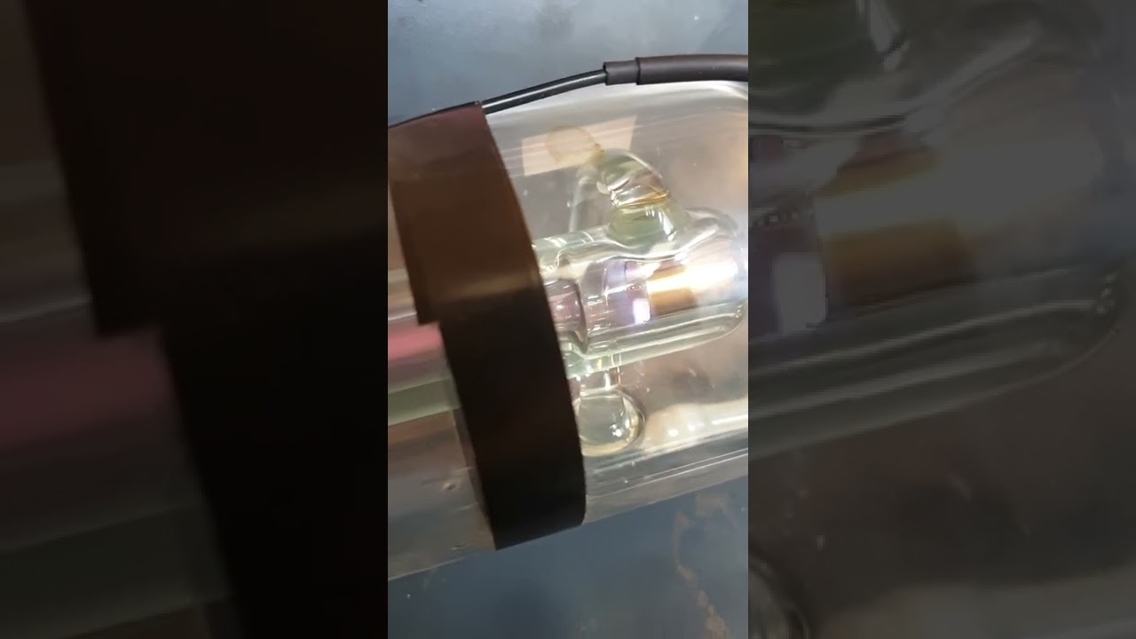

Today I went to look at the tube to see on it’s sticky label what model and the date on it. The label was under the tube, so I rotated the tube to see it, and noticed another label. Bright yellow…This side up!
So the engineer that installed the tube last August put it in upside down…
Also the mounting points are not where marked on the tube (1 is, the other is about 2 inches away) guessing this is less important
It is a EFR F4 tube.
I’m assuming it needs to be the correct way up, why else put a bright yellow sticker with this side up on it??!!
Could this have ruined the tube? (obvious answer I expect)
This is short video of the end of the tube when firing, should it be hitting the brass surround like this? is this normal?
