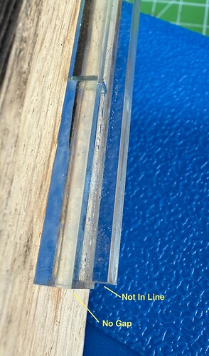

My question is about kerf adjustment. I have read numerous posts on here and I don’t think I have seen anything that is asking the same question as I am about, again sorry if I have missed it. I am making a small award for long standing members of our Newfoundland dog training group. I want the main body to be in acrylic with a wooden base. The acrylic fits through a slot in the wood and is held in place with a key…

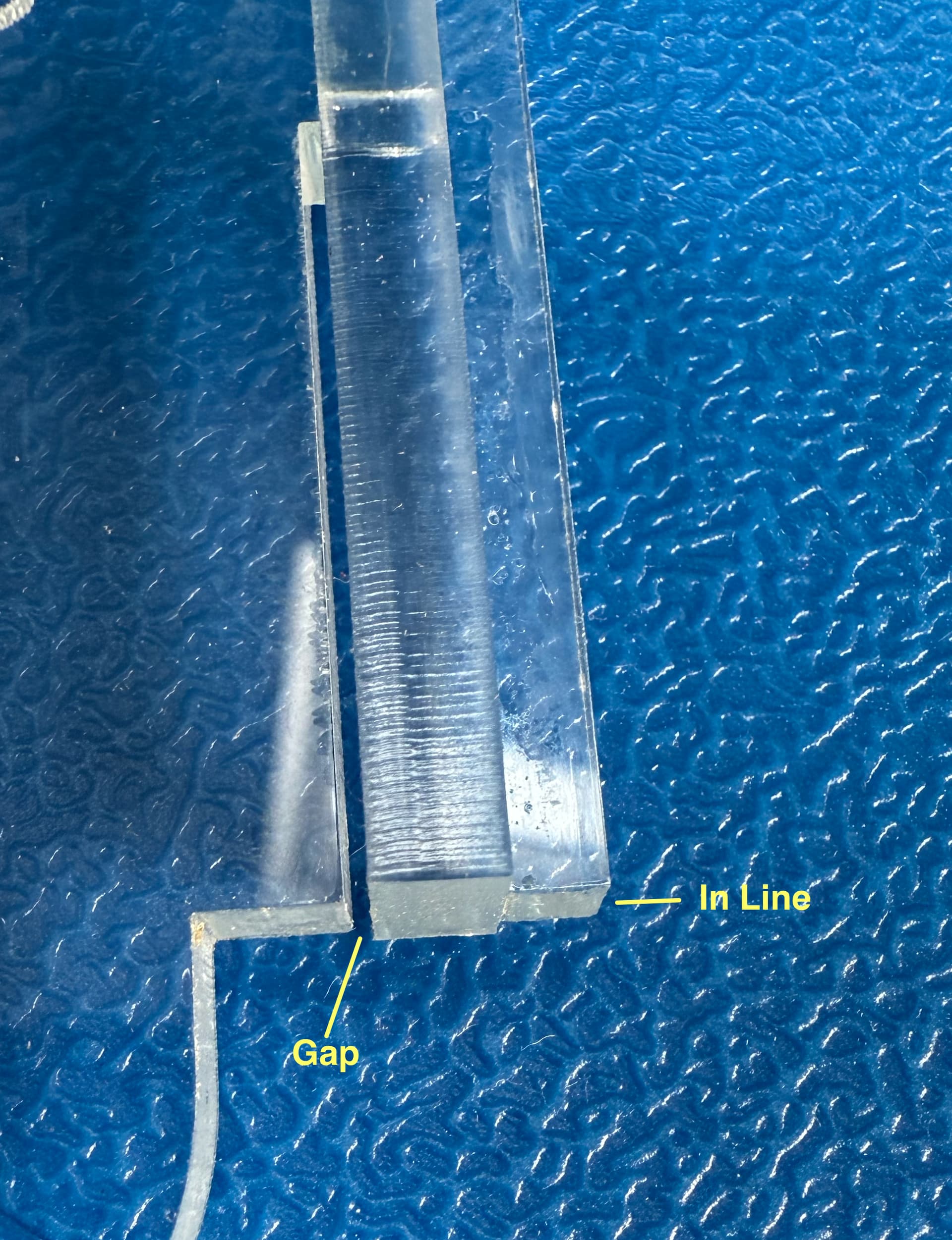

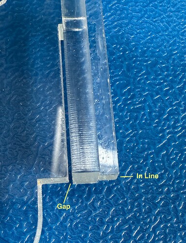

… the first test piece I didn’t apply a kerf offset and it was all too loose…
… so ran the kerf offset calculator on a spare piece of acrylic, and cut new pieces…
… the fit was now perfect with no gaps and locked in to the wooden base perfectly. However, I am puzzled by the fact that the key and the main acrylic panel edges no longer line up as demonstrated in the attached pictures. It would appear that the edges are out of alignment by 2 kerf widths yet all the cuts are set to use the same kerf settings. What am I missing?
It is not at all important in this application, but will be at some point. My inexperienced brain tells me that there should be a misalignment with no kerf and perfectly aligned with kerf - so I guess there is something I am not understanding.
Thanks in advance
Pete
Before digging deeper into the actual question: your kerf offset seems to be huge! It’s usually around 0.1 mm or so, but it looks more like 1mm in your case.
Are you sure your axis are running as expected?
To me, it looks like the y axis movement is not correct.

Hi guys thanks for responding. My kerf (as measured by using kerf measurement topic) is 0.125mm - this is on 5mm cast acrylic at the whatever the power speed are for this cut (I am currently away from my LightBurn machine). I have entered the full kerf as a positive offset are you saying I should only be entering half of that amount?
I do agree with your bullet points and hence my confusion… with NO kerf offset I would have expected the cut out to be wider (and it was) but also longer and it wasn’t. with no kerf the edges of the main piece and the key, when inserted together aligned perfectly albeit with a lot of vertical slop as shown by the “gap” in one of my pictures above.

If you want the edge to be where the black box tool path is drawn, you use 1/2 the measured kerf.
Make sense?
The software is pretty smart.. if you have a circle within a circle, the software will attempt to place it in the correct relationship.
So just to make sure I fully understand what you are saying Lightburn adjusts by the offset you enter NOT half the amount? So if I measure the actual kerf to be .1mm I would enter an offset of 0.5mm?
And my other point I can answer myself: the depth of the slot will always be 50mm (as per my drawing) as kerf compensation or no kerf compensation will be applied equally at each end of the slot. I can only assume that in my kerf compensated cuts I didn’t managed to engage the two slots together enough as they were too tight - I can’t test now as it is all glued together.
Thanks for all the input on this - I am loving Lightburn and my laser… SO much to learn, every day is a school day! :smile:
Pete
Not exactly, 1/2 of 0.1mm is 0.05mm
But that’s the general idea for most applications that use a kerf adjustment.
Just like a hand saw, you move it over 1/2 the kerf (blade width), that’s the kerf adjustment.
