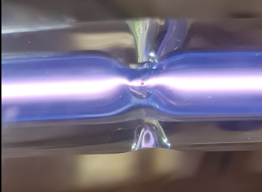

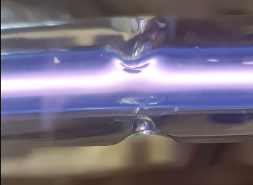

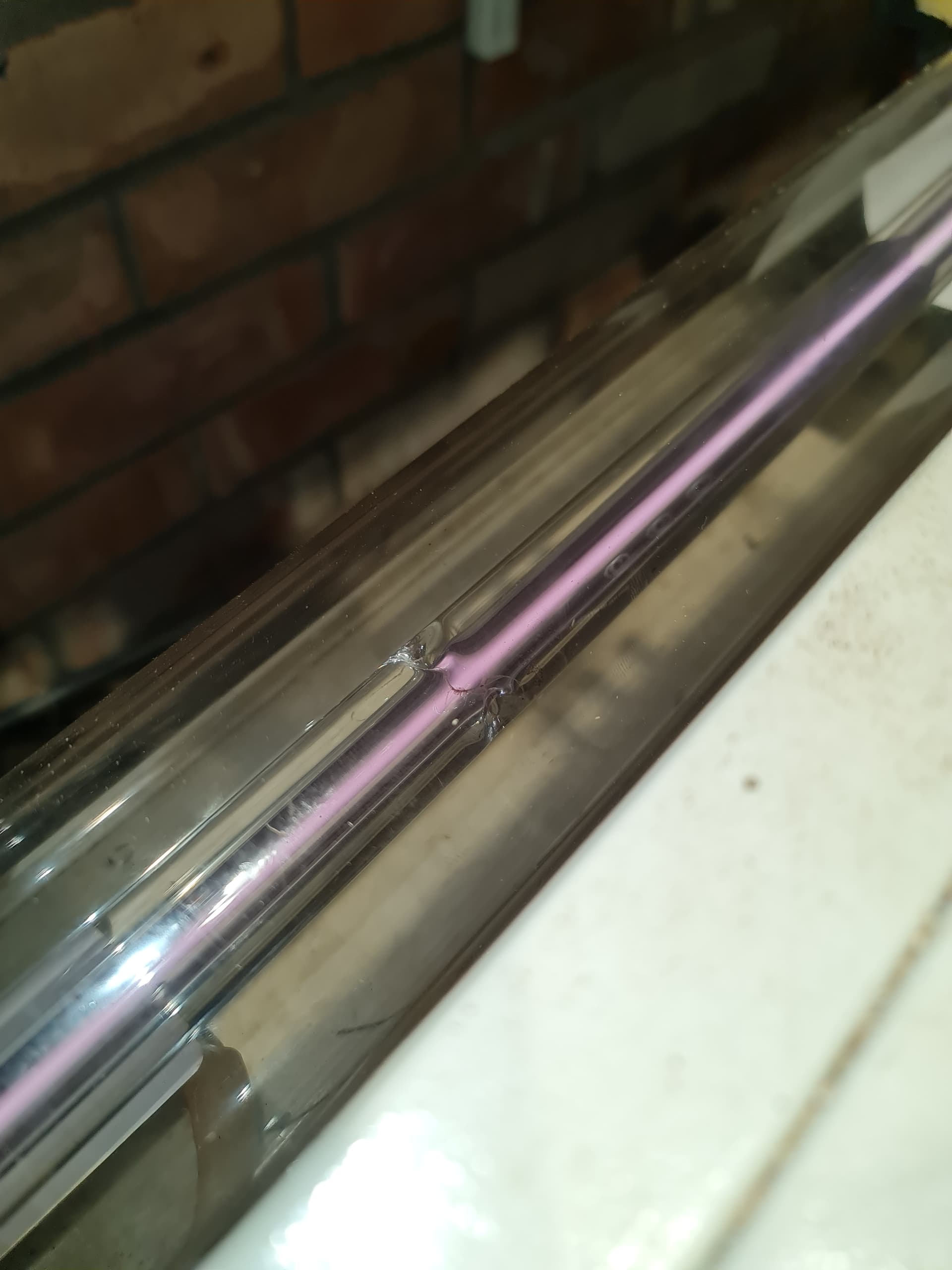

Anyone ever had a kink in the laser beam?
I have an 80w tube about 2 years old and recently ive had a real loss of power. After doing the usual checks, mirrors, lense and alignment i was still low on power. It was then i noticed this KINK in the laser.
I think this has to be the problem but not sure how to fix it. Any ideas?

With what I know about glass tube lasers, I cannot even imagine how that is possible.
Hi.
First of all, thank’s for sharing @Gary_G , that’s an amazing pic, and at least for me a mindboggling fault.
What little -mainly teory- I know about CO2 lasers, I’d say that it’s a miracle to even witness a bent/melted discharge tube.
From what I know, the discharge tube should shatter immediately when something like that happens.
Also, the tube shouldn’t be able to fire anymore, the fact that it does is simply amazing.
There are folks here who are very well versed with CO2 theory, I’m anxious to hear what they have to say about this.
I think it’s very unlikely that that’s not the problem :wink: .
Well that’s at least an easy one, a new tube is the fix.
As for what caused something like that to happen, I can only speculate, but since the tube has been in service for 2 years, a material or manufacturing defect is an unlikely -but always a possible- cause.
A some sort of coolant mishap is obviously always a safe guess with any mechanical CO2 laser tube malfunctions and troubles, so my guess will be that as well :slight_smile: .
There’s all sorts of other possible causes that comes to mind, like the internal mirrors being out of alignment, somehow bent discharge- or water tube, etc. but it’s probably best to left the deeper speculation for those who have a strong first hand experience about the inner workings and ā€œfault modesā€ of a CO2 tube.

If it’s not an AI generated image or fake dated April Fools’ Day joke :wink: , I think you should go to ā€œThunder Laserā€ with this tube. They must have the greatest interest in explaining to their customers how it can happen.
To get this deformation in glass it must be heated up to approx. 600-700 degrees Celsius over a certain time, the water in the cooling tube that contains the laser beam tube itself, will even with a high flow (which there is not) boil, expand … I don’t know if this type of damage can happen when operating without water…, ask Thunder.
And yes, this tube is dangerous and not suitable for use.
I can’t fathom a guess what’s going on there.
Can you show us some pictures from a couple of different angles… can you rotate the tube and take a look at it from another angle? Are you sure that’s not just distortions in the glass bending like an optical illusion?

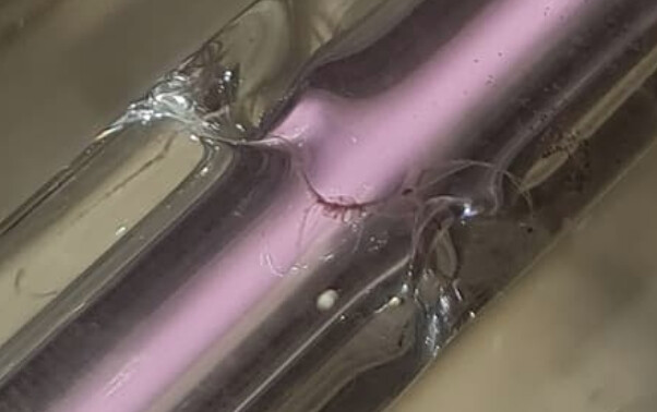

It’s no joke or cgi it is at the point in the tube where the inner tube is attached to the next tube.

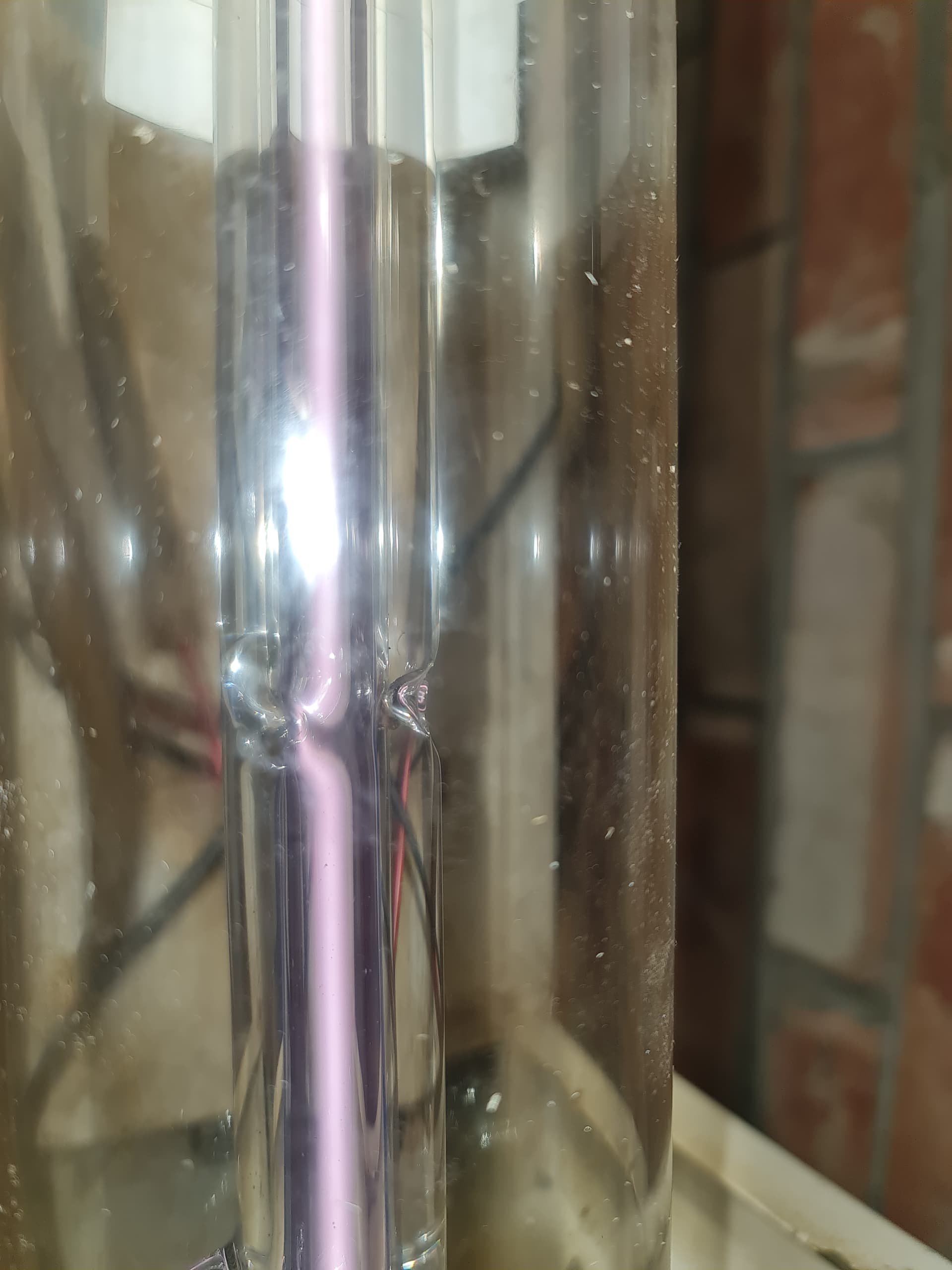

To me, it looks like an optical illusion due to the glass around it. The beam looks undistorted in the new pictures.
I’ll do a video today, there is another weird thing further down the tube.

is that a crack ??
…in my opinion, yes. It could well indicate that the cooling system has ā€œfailedā€ at some point.

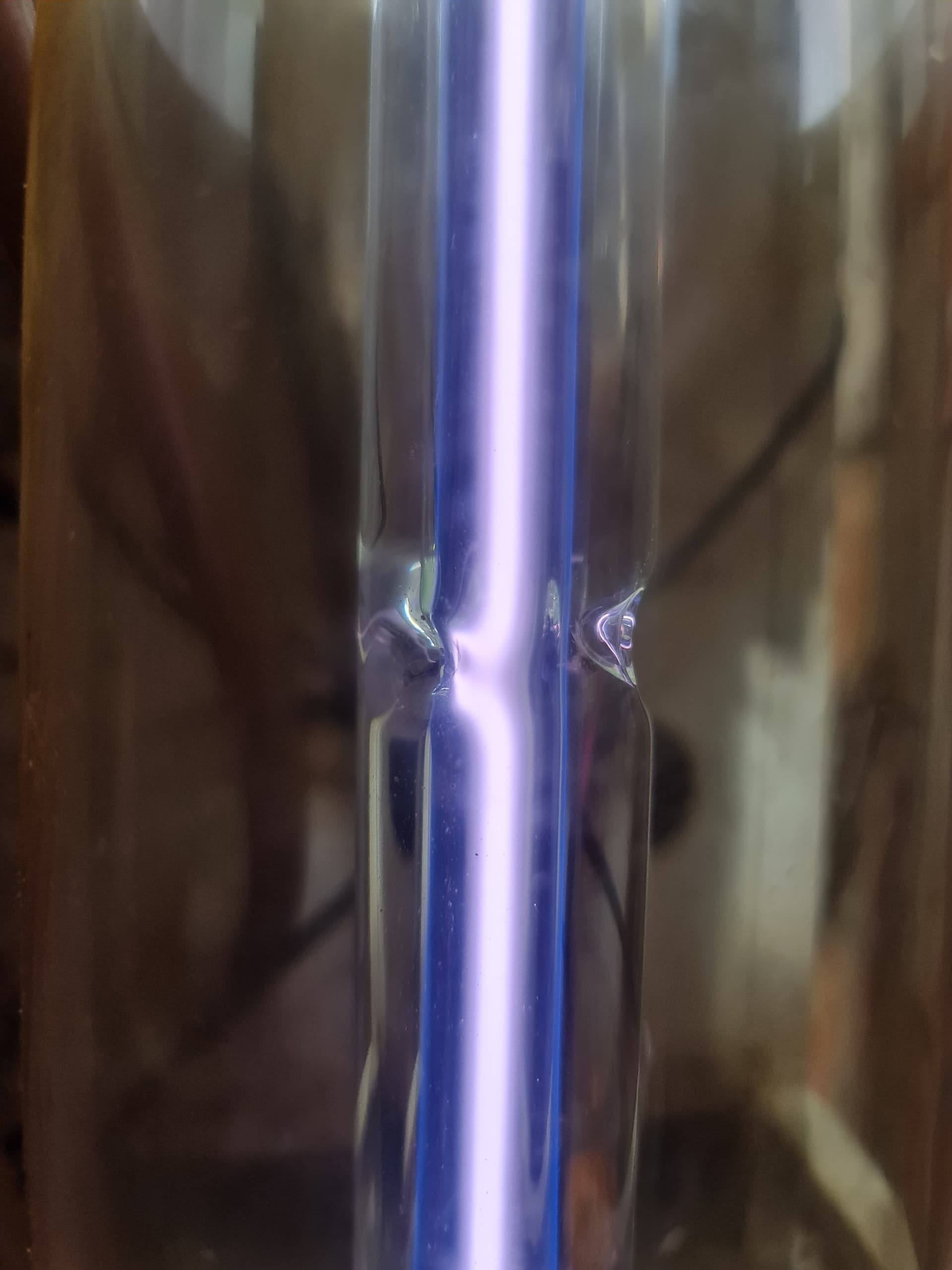

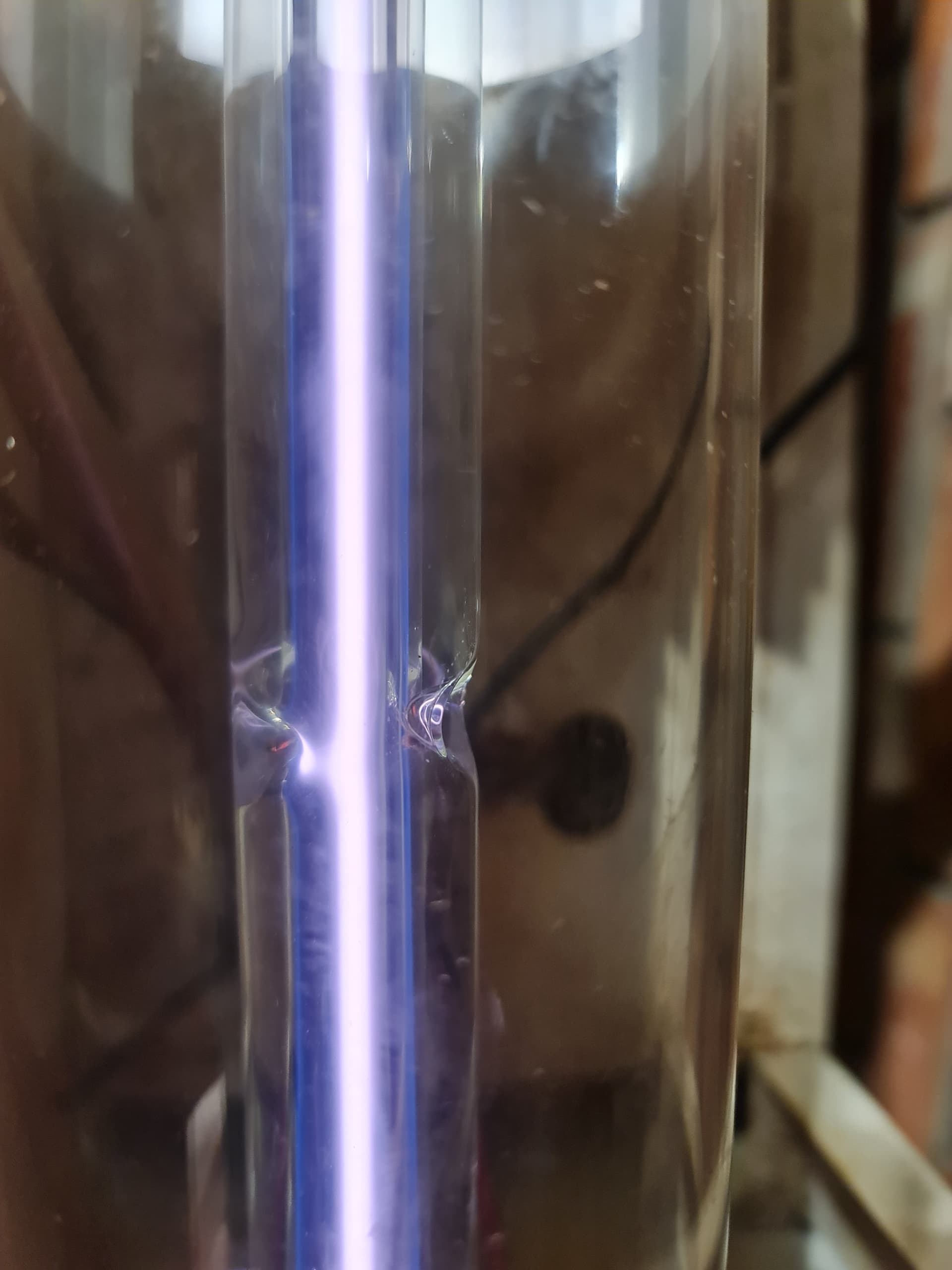

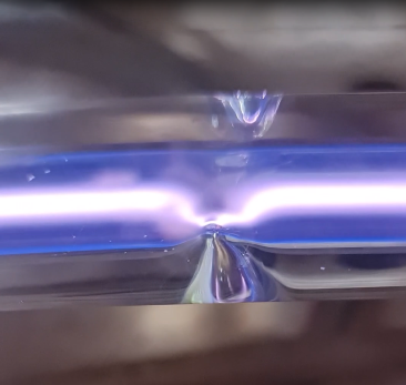

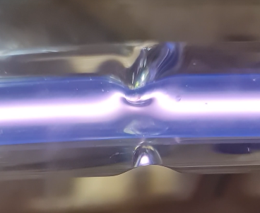

It should be pointed out, that the Pink you are seeing is NOT the laser. The laser beam itself is invisible to the human eye. What you are seeing is the excited plasma that is created inside the tube. In a healthy CO2 laser, the plasma inside the gas tube glows a pinkish-purple color. This emission comes from the excited nitrogen gas within the laser’s gas mixture, not the invisible CO2 laser beam itself
That makes sense. The inner glass tube is distorted, not the beam. Thanks for the new perspective!
That’s not a crack its a bit of plant I think, I’ll be flushing it out later.
As far as the ā€œkinkā€ goes it is the plasma being distorted by
the glass joints in the tube.
OK this still makes me think the tube is done, picking one up in Germany 24/29th Which is nice.

I cross referenced this with the only comparison I could think of ā€˜plasma physics Birkland currents’ and was led to Gas ionisation ā€˜Glowing’ while the beam itself continues uninterrupted.
The position of the ionisation in the tube and the abnormalities in the tubes structure suggests possible gas contamination rather than power supply or tube component issues which would have different appearances.
Are there micro-cracks in the glass?
No cracks as I rotate the tube they come and go due to distortion in the glass.
Visually the tube looks ok, I’m goig to swap back to the 60w power supply and check it out.
I will not do that. The tube is finished and dangerous to use because the glass has suffered damage and has become thinner in the exposed areas.
Send it to your dealer or to the factory and install a new proper tube to continue production.
I’m sorry but the tube is fine there are no cracks or damage, it was a visible distortion of the plasma due to to joints in the glass. I’m still picking up a new tube from Germany as we are visiting friends in Colne plus its about a Ā£150.00 cheaper.
