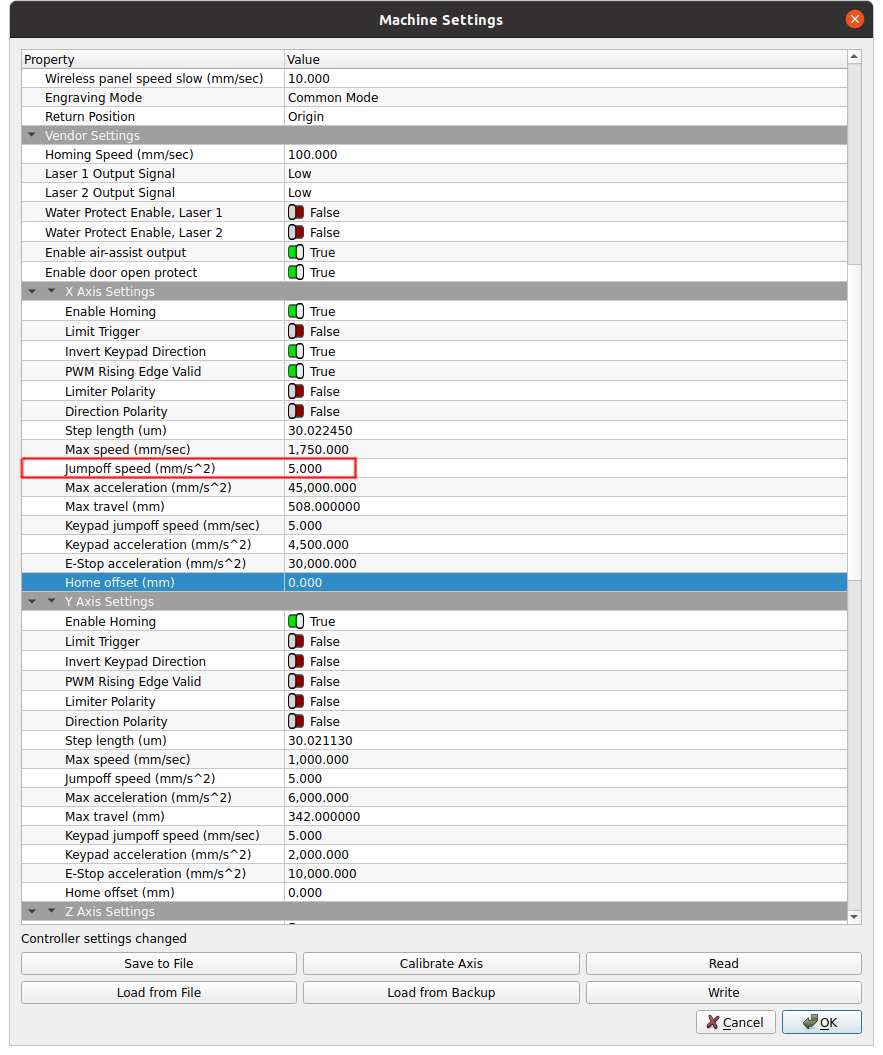

Hi all. I am very new to laser cutting and bought a small 65 watt used Boss LS machine to see if it would be wise for my company to invest in a new huge machine. I went through it and installed a new lens, mirrors and belts. I also gave it a full alignment. I set it up to cut some test patterns in 1mm and 2mm acrylic in Lightburn. The cuts were perfect. I made a change and tried to cut 4.5mm acrylic. I set the machine to something like 30/60 (30mm per second and 60% power) and it cut at about 22ma. The cuts went about half to 3/4 of the way through the material. I then backed the speed down to 10/60 resulting with no change in the cut depth. I then went to 15/90 with no change in the depth. Out of desperation I set 5/90 and still cut about 1/2 way through. I then noticed that the current was now low at 5/90, about 5ma. I then jacked the speed back to about 25 and the current came back up to 22ma. Why does the power drop as the speed drops? Is there a setting for this that can be changed? I would imagine that a high power fast cut would be be the ultimate goal of laser cutting. In the end I managed to get through the material with terrible frosty looking cuts at 1/90. Yes, 1/90 @5ma. (: What am I doing wrong? Ultimately it was a terrible cut and took forever. BTW, the Rudia max is set to 80% and I tried various focal depths with10mm being optimal. It seems counterproductive that at lower cut speeds the power isn’t available. Please help as I am very hopeful that we can use a laser machine for production.
It’s likely that your slow speed forced the Ruida to use only minimum power.
The minimum/maximum power range is used doing vector cuts/engravings.
The minimum power level is used anytime the start speed is equal to or greater than the current speed.
Most of these controllers have the start speed set to around 20mm/s, so you’re right there.
I think it works like this.
These values are in the Ruida and you need to change them via the Machine Settings.
Great! At least there is a reason for the seemingly strange behavior. I hate to claim ignorance but in looking at the two setup screens in Lightburn I see no provision for modifying this information. Is it that it needs to be changed via the keypad on the Rudia? In setting up the default autofocus I had used Laserworks to interrogate and change the value. Do you know if this setting can be changed there? Thank you very much for the reply. I would have never figured it out on my own.
You should be able to change some of this via the machines console.
The machine settings in my 1.7 version of Lightburn has the Machine Settings under Edit, newer versions are in Laser Tools I believe.
Each axes can be set differently.
Jack, Thank you again. You are correct, in 2.0.0.2 the settings are in ā€œLaser Toolsā€. I will work with the settings and report back.

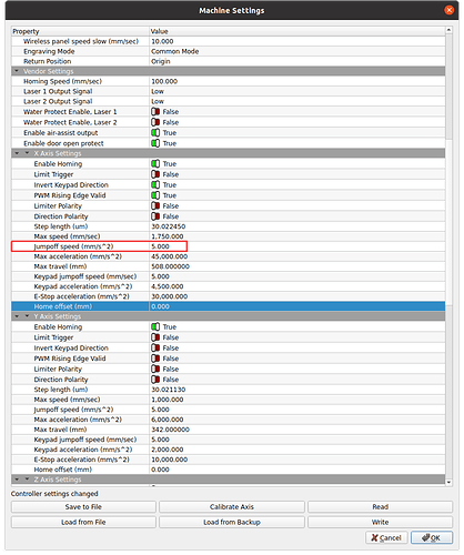

I am not on site but through the magic of the internet I just managed to interrogate the machine. Interestingly, the X and Y settings are set to different values. Do you know if there are any ill effects by changing the values?
I dropped both of mine down to 5mm/s^2. I can’t think of anything this could harm.
I’ll give it a go and let you know. (: I got pulled onto another project today, ): but tomorrow I should have the time. Thank you again.
Sorry for the late reply. I set mine both to 5.0 as well and it worked line a charm. I can’t thank you enough. The sample part came out better than i had ever hoped for. I am curious, how is it that you know so much about the machine setup? Do you work for a laser equipment manufacturer or service organization? It is a pretty obscure setting and you knew right where to go to fix it. I would have been lost without your suggestion. Thank you again.

Have you changed the Jumpoff speeds?
Those settings should (AFAIK) be left alone, as they are factory-tuned to your machine, reducing them might slow your machine down - particularly for the X-axis which should be a much higher speed than Y as it has less interia to overcome (at my machine these are set to 21 and 10mm/s respectively).

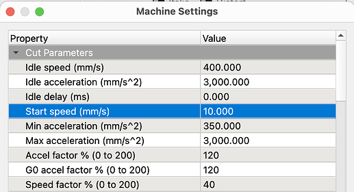

Probably best just to increase the Min Power% of the job in these circumstances where job speed is at or below ā€˜Start speed’ , and if you really must change the Start speed you can do that here under ā€˜Cut Parameters’:

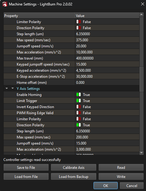

After you advise him to change the jump off speed, and then you state he shouldn’t change these.. you kind of lost me there.
From my experience using my rotaries, the jump off speed is where the acceleration starts to be applied. If your jump off speed is 30mm/s the 30mm/s speed will be applied initially then at or above that value, the acceleration for that axes will be applied.
If this is too high, the mug looses traction with the drive wheel at the start. If anything slows the machine down, it’s lowering the jump off speed.

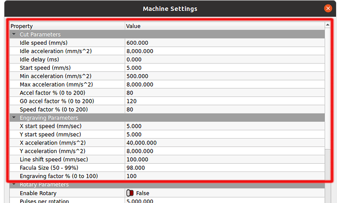

All motions are subject to acceleration limits at each end, but ā€œengravingsā€ have pixel-by-pixel power variations during the constant-speed section. The difference may be as simple as an array of power values covering the length of the vector, with ā€œcutā€ vectors having nonzero power values up to the endpoints and ā€œengravingā€ vectors having zeros beyond the constant-speed section.
I haven’t been able to figure it from the reverse-engineered code:
At some point I must set up MeerK40t and feed a simple design through it to see what the decoder has to say.
AFAIK, if you are using ā€˜Fill’ or ā€˜Image’ in LightBurn the ā€˜Engraving Parameters’ of the controller will be used (anything that uses line shifts, and scanning offsets) - otherwise I’m fairly sure everything else from LightBurn will use ā€˜Cut Parameters’. (@LightBurn might confirm?)

We officially advise changing Min Power% to fix this issue:

Got it. It will definitely slow down the machine. Of course, if I’m doing mugs, I’d rather have them come out slowly and not garbage.
Advising an increase in power means one of us doesn’t understand what’s going on, as it will still go to minimum power, which now would be too high. So IMHO, increasing power is clearly the wrong answer.. As you read @Gearbreaker advises it fixed his issue. Thanks Chris.
The Chinese know everything about these and all applications is a poor assumption. The only way to make a mug stay on a roller rotary is to reduce the jump off speed. Of course it’s going to go slower, but as an operator you should understand that.
