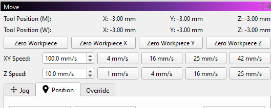

Regardless of where I tell Millmage is machine zero the position of the probe point is about -3x -5y and moving away to over the work area is a negative number as shown in the position display. Z I have set to up as positive but if I initiate a probe it hard limit triggers I think on the Z

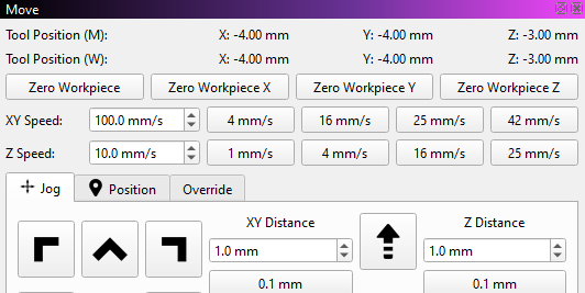

No matter how I set it up in the device wizard for machine orientation. The back right corner reports as x and y zero and moving over the work area is negative.
In device setup I have 0,0 back left and after homing all:
If I jog left forward from here
After changing to front left I and homing:
I did get tool change probe to work, the Alarm was due to the G0 to 0 on X and Y since the machine is already at -3,-3 and over the work area is negative.
It seems no matter where I define 0,0 it is being ignored

That device sets 0,0 in the top right of the workspace and the machine coordinates are all negative. This is pretty common with GRBL devices.
You would then jog to where you want your project’s origin to be and click “Zero Workpiece axis” buttons accordingly.
