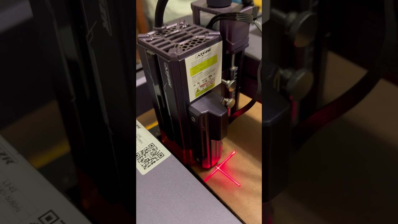

My Atezr is home and framing fine. When I click on “autofocus” it does the usual routine BUT when it touches the project, it’s like it keeps wanting to go down onto it, like it’s bogging down. I checked the little button that does the autofocusing and it’s not stuck or anything. I can depress it fine with my finger. Any help is greatly appreciated. hopefully the video is helpful. At the end of the video, I show what my screen looks like, with the error message.
Would imagine it to be a hardware issue
Try this.
a) triple check all cables are correctly set and healty
b) move the Z all the way to the top, trigger auto focus (unsure if you can do it disconnected from computer)
c) before it reaches the material trigger the switch with your finger.
Does it Z? if not odds are your switch is faulty
I did as you said. It did not bog down like it does on the material but now it says “Machine exceeds maximum range of motion”. This was just on me autofocusing on my finger.
Make sure you have your Z axis enabled on the Device Settings window
Also after you manually home it
In console in lightburn type
Press enter and see the Mpos values Should all be Xo Yo Zo
Then make sure you re in absolute coordinates and not in current position
Still strange it has a fault homing on material, is it reaching the end of travle of the motor before touching the switch?
I am homing it from the console on computer, not manually.
I’m sorry, where do I press “Enter” at on the console?
It is on “absolute coordinates”
I understand now. I typed “?” and everything is at 0.
if its all X0 Y0 Z0
And your work is not bigger than the frame you should not get the error
Your Z enabled right?
If you disabled it error persists?
Work is very small…1" x 1" and I put it out to the center of the frame just to see if that helped. Same issue.
Z is enabled.

scratches head… odd
Any chance you can post a full screenshot of your lightburn with the project in place?
Also the copy/paste of the full console when it errors
Sure. Will do so right now.

I unplugged the laser…not sure what the laser module is (sorry). Can you explain what run the frame only is? Sorry again.
this is the module
Unplug the cables that go to it
Then run the job as if it was normal
We are removing a lot of power demand and running only the “frame” As in the chassis of the machine
I unplugged both lines going into the laser head. One just turns off the light to the laser I believe, it’s on the side of the laser head. The other one is on top…not sure what it does but I can find out. Anyway, same problem persists with both of these unplugged.
