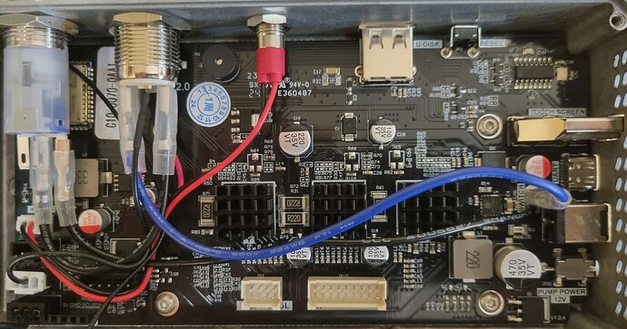

Does anybody know what board I’m looking for? Atezr doesn’t seem to offer spares on their page.
Can you share a image/photo from the board itself?
I thought that once I had it open it would be easy, but I can’t find it on-line :confused:

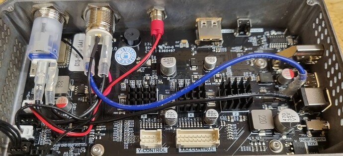

From this screenshot of the board, it looks like there is some breakout board to connect your motors and endstops.
Can you send us pictures of the PCB that’s connected to these Y-Control and X&Z Control plugs?
We might be able to recommend you a suitable controller board replacement. Just note, that any controller other than the original one will not be a drop-in replacement and will involve some custom firmware tweaking.

No break out board that I see, just a large connector that heads into the gantry frame. I’ll disassemble further to confirm.

The oem board looks just like the one in the picture you inserted.
