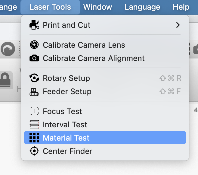

My Di-pro was almost an ‘out of the box’ experience, but I have to agree with the above - without running some tests first this is going to result in some scrap being produced.
I sympathies with the impatience but the material test, for example, is going to provide you with a handy reference for many future jobs. A focus test is vital too, before any other test is run.
Your using underlayment. This doesn’t appear to be a do or die problem. In 10mins. you will know how well it worked. Adjust and repeat.

The focus Test requires a powered Zaxis. Can I get around this issue by raising one end of the work a fixed amount specified amount (Start Z) in the test?
Commonly referred to as a “ramp test”. Several good videos explaining this on YouTube.
