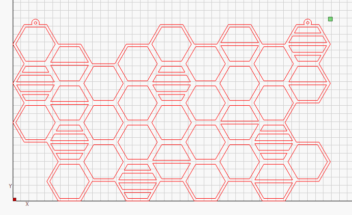

cggorman [Chris] Can you message me directly on here? I have some photos and curious what tuning you did. I’ve done material testing, and auto focus. I’m sure a lot of my issue is with speed/temp and kerf. Ive watched so many videos and material tests, nothing is cutting nice and straight. Small circles look like pin holes, or nothing at all. This new template I have is pretty simple and should easily cut with no issues. Especially being 1/8" underlayment. I tired a simple logo last night on same material and the sharp edges are a bit rounded and/or extremely burnt. (anyone that asks, yes i have done tons of material testing)

This is what I got. It took about 5 mins…but then again, I have been using Lightburn for 4 years. There is a HEXAGON shape tool and just make it the size you want and then I offset it .125" and then DUPLICATE (Right mouse → Duplicate) and then move and places. For the horizontal patterns, I just drew a rectangle with the rectangle/square tool, duplicated it 3 times and moved them. I then used the boolean subtract .tool.
I would suggest looking up on YouTube “Lightburn 101”…there are many there and that is where you will get the most help.
Honey comb.lbrn2 (81.8 KB)
There is a trace function. Here is something quick I came up with. You will have to learn about nodes. I’ve used Lightburn for about 2 months and it’s a great program. Learning about nodes really helped me fine tune my creations. So this is a start for you.

HoboWithWood just released a new YouTube on node editing that covers it pretty well for beginners at node editing.
I recieved it. Thank you. My honeycomb bed is currently out for delivery so I will be giving my it try again. I have’t had anything holding the wood in place and i think my last one i tried, it moved. I’ve received great advice from here and other forums as well. My speed and power seem to be ok. my workspace is 401mm x 410mm and this project is just a bit smaller than that. I’ve resized it, and I’ve checked all my settings. Hopefully with the 500mm x 500mm bed and holder tabs, i will finally have a successful cut tonight.
