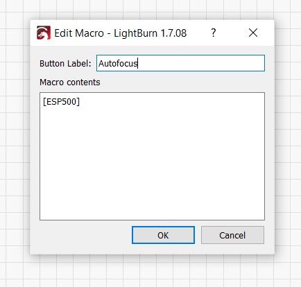

HI.
Cant get the ESP500 working.
It doesnt do anything. Laserhead rises, lowers and does anything I just figure to ask ( and know how to) but ESP500 autofocusing doesnt do anything.
I can HZ it to home Z. I can lower it so it stops to probe hitting material, I can rise it and lower etc…
HZ rises to laser and touches 2 times top. Starting to be really desperate
What is wrong, what can I do.?
Screen shot of your macro setting.
Do you mean the Esp500 auto focus macro?:thinking:
I can provide screenshot but it’s [ESP500]
That’s the correct code. It should work if your machine has that capability. I was looking on line and i dont see where the A24 Pro has a Z axis drive. Am I wrong.

Controller board too? The autofocus is a controller function. Lightburn just sends the command to execute.
The. Why atomstack studio can do it.
I tried. Worked. Just don’t want to use atomstack studio. It sucks…
There must be gcodes to complete auto focus.
And manual with the L2 says nothing about controller upgrade.
If it works with Atomstack Studio then controller must be OK. I assume Z axis is enabled in Lightburn and you can manually jog Z axis up and down
I can move it manually from. Top to bottom and both ends stops to microswitch. I can home z it travels up and touches 2 times and it’s OK. And all manual controls is OK. Just auto focus doesn’t do anything.
Does the auto focus button on the controller work? Or is there not one.

If you open the console then try the Autofocus do you get any messages in the console
Not now on the computer but I tried it earlier.
It says something like:
Stream started
Stream completed 00:00
I guess im out of ideas. The only other thing i can think of is look at the machine settings and see if there is anything there that may not be enabled.
I tried to look and as far as I know there is nothing what could be enabled. But I can’t be sure.
I think it would work if there just was some gcode lines to do the same as esp500..?? Maybe.?
Now o do it manually dropping it down to “alarm stop” and raising 4mm or 8mm with macro…
But can’t put them to same macro because lower stop causes alarm.
Some command should be put there to not make it’s stop fully from bottom switch…:grimacing:
One last idea… Contact Atomstack to see if they will tell you what will work with your controller. Although the Studio works, it may be doing it with discrete commands rather than the ESP500 macro. Your controller board may not actually support this macro command like the L2 controller board does.

Maybe try laserGrbl and see if it works there. If it does maybe there’s some way to see what code is sent to make the autofocus work.
That I was hoping someone would tell how…
