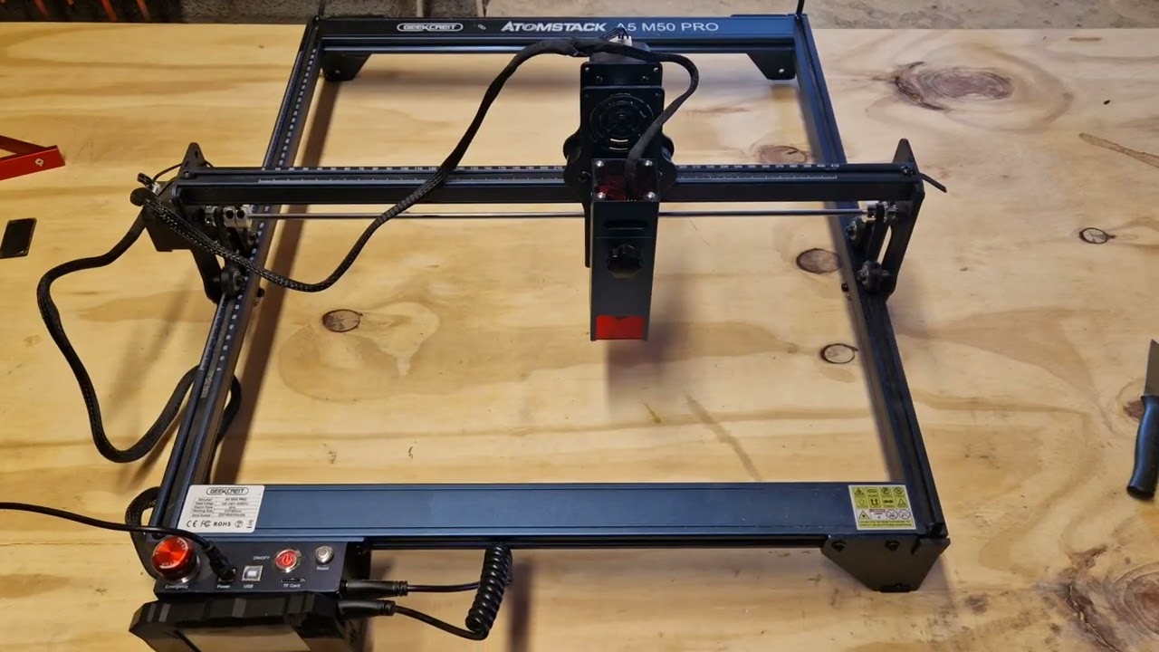

Atomstack A5 M50 PRO starts 'knocking' when powered on
My Atomstack A5 M50 PRO makes a “knocking” sound immediately after being switched on. With the same frequency as this knocking sound, a red and a blue LED on the motherboard are flashing.
This sound only stops when I disconnect both stepper motors.
I see exactly the same behavior even when using a different power supply.
Does anyone recognize this issue? I can’t easily find a replacement motherboard to test whether replacing that component would solve the problem.
Some videos of the described behaviour (with sound) below:

Looks the same, except your repetition rate is higher. My first guess is the controller board. Hopefully @raykipa has a better answer.
How old is the machine? Have you reached out to Atomstack?

That depends on how techie you are. It would likely require changing connectors and adjustments for the board mounting. You will also have to deal with a version of controller software. This should be the plan of last resort.
It will not be Plug ‘n Play unless you get the board from Atomstack. Have you tried to contact them?

Closest will be if the board is from Atomstack. But be aware the Chinese manufacturers will change things mid production run. I got a replacement Sculpfun board, from Sculpfun, that had a different connector layout on the board.
In my opinion, if it is a Chinese replacement, it is a Plug&Hope.
On the current motherboard I can see that it is a LaserBox ESP32 V1.0.
What I’ve noticed is that a replacement LaserBox ESP32 V1.0 is almost nowhere available for purchase.

You get Amazon there? Buy the ESP32 v1 from Amazon and use the links in this thread for the software. You get air Assist capability as a bonus.
You mean a LaserBox ESP32 V1.0?
That’s the same as the current board.
Only because I do not know if the v2 board is plug for plug compatible.
