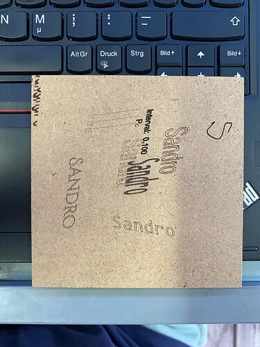

I created a text in Lightburn that is aligned straight.
However, the laser etched it diagonally onto the material.

that’s not so easy to solve. It can have many different causes.
Without further information, we can only look into the crystal ball, …
Here’s a list, though certainly not exhaustive, that you’d have to check:
- Operating system: Which one are you using? Are the fonts system fonts or did you install them separately?
Within Lightburn:
- Check the preview window to see if everything is correct.
- Did you convert the letters into path?
Further options
- Connection between computer and laser: Use a high-quality, not too long USB cable.
- Mechanical problems with the laser: Loose screws, insufficient tension on the belt, etc.
Simple test, for example, on a piece of cardboard: Is a circle burned round and closed?
