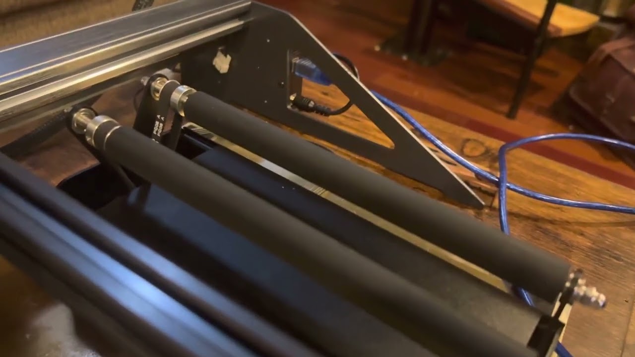

I purchased the atomstack roller engraver attachment and I am having an issue. The roller comes with two motor cables ( I have tried both in my setup) and the motor just buzzes loudly and the unit vibrates.
I have gone through the rotary setup tool in lightburn, and all I get is this!
Might want to post a screenshot of the rotary gui displayed in Lightburn.
This is usually step/rotation or deg/rotation…
What is that set to?
Screeshots are preferred, I couldn’t read anything on the screen in the video…
For future reference, it’s better to mark the original thread solved, the initial problem here, and start a new thread with the proper information. If this solves your problem, nobody will be able to find it buried down here in this thread…
