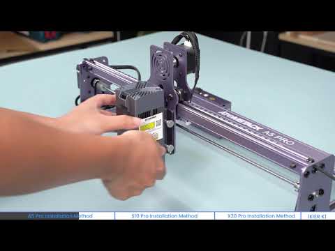

Hello, Brethren! I am a bit puzzled as to why my R30 Module will not fire. The laser that came with my X30 Pro works like a charm, but when swapped out it will not do a thing. On the manufactures youtube install video it does show my machine without the additional circuit board being used. Ive tried with an without and it will not fire. It will do everything besides fire the laser. Anyone have any experience with this???

It is the V2 and yes it is 12v. And yea i figured LB had little to do with it, but wondering why using the same cords it just wont fire on one module and fine the other.
any chance you can post pics of both connectors and board?
The video dont show the connections labels
Could you zoom in here
also what happens when you press the Fire button?

Nothing just red light on job and with button

So hypotetically, the module connected to the board directly, with the power adapter should fire when you touch the test button
Fan should trigger, and module should fire
As far as i know it does not have preheat so should fire right away
If it doesnt:
  • i would get in touch with atomstack for procedure of testing
  • any other machine you could try it with?
