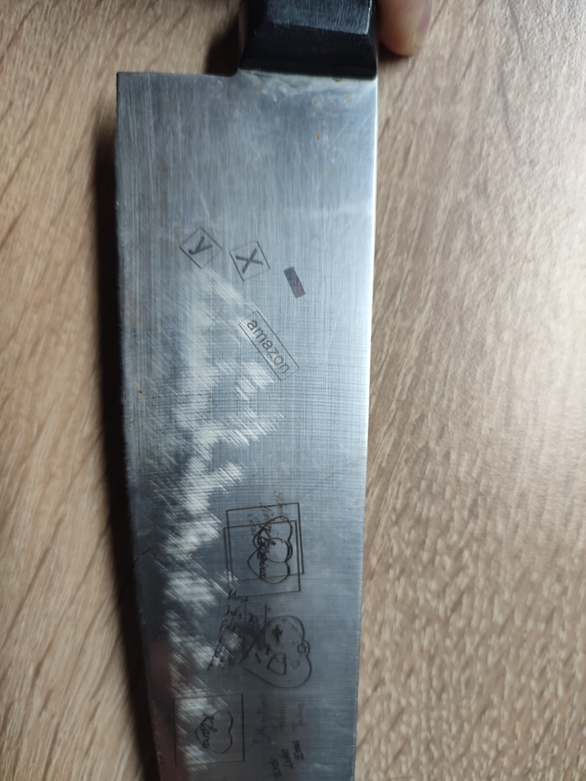

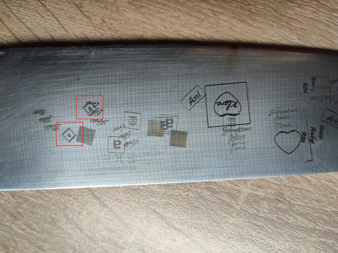

At one point Laser stopped engraving completely, it would move but it didn’t draw anything - even on wood. So I removed config files (prefs.ini and prefs.ini.old) and re-added the device - found this on the forum. That got it to work again but it works with much lower output. As you can see in the images bellow, those images with full black lines is how it worked before and those little weaker texts is how it works now. All with the same settings.

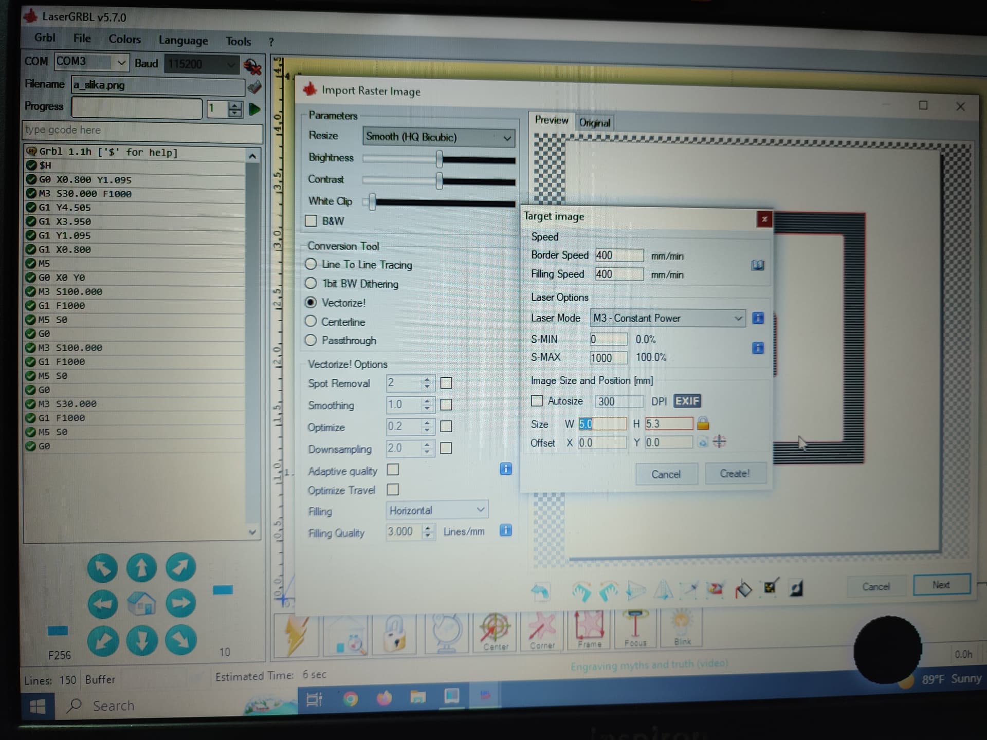

I would try this with lasergrbl and see if it is doing the same thing.
Sorry for the late response, I was trying to get an answer from Atomstock and to enable old Windows laptop for LaserGRBL. It was first time using LaserGRBL it’s not a nice image but I think I got the settings right. Still low output. Marked with two red boxes on the knife. Still much lower than the really black ones.
Also AtomStack asked me to try with 200 mm/m - letter X in the box
And I added a video of 200 mm/m with 2 passes - letter Y in the box
For viewing the result better here is the image of the result

Lightburn and lasergrbl giving same results seem to point to hardware issue. Controller or laser failing. Maybe try reflashing your controller firmware.

I had to provide engraving/cutting videos and images of different materials with different parameters. It was hard for them to estimate but in the end they confirmed that there is decay in the laser intensity of the laser module and they are sending a new laser module (waiting for it at the moment).
If anyone is interested in details. Last scenario where they actually confirmed it, is that they asked me to cut 3 mm plywood with 200 mm/m and 100% power. I didn’t had 3 mm one, so they suggested that I cut 2 mm plywood I got with the laser. Ofc, that cut it through since that parameters should be enough to cut much higher according to material parameters of the laser.
  • Basswood - 5mm → 170 mm/m - 80% - 1 pass
  • Bamboo - 2mm → 400 mm/m - 80% - 1 pass
So I sent another video where I used 2 mm plywood and tried cutting an example .nc file they provided with the laser - the file is acutally called 2mm plywood cutting dog.nc. That file was using 400 mm/m and 100% power. That wasn’t cut, it was clearly visible that lines in the Y axis orientation were cut but lines in X axis orientation weren’t cut.
