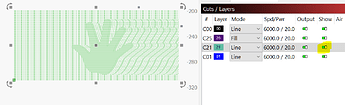

Make sure everything is selected and all layers are set to output.
Basically fill are just parallel lines, my example is not the correct way but a workaround.
You should know your laser spot size, to set a distance between the lines or defocus a bit and increase the distance winning less time engraving.
  1. Create an horizontal line bigger than your shape
  2. With the Array tool create Y (max 200) parallel lines at e.g. 0.1 mm distance between them
    If you need more height select all the above lines and repeat
  3. Group the lines.
  4. Place the closed shape that you want to fill over the multiline
  5. Select the lines
  6. Hide lines (Cut/Layer toggle show) then select the shape
  7. Click show toggle.
  8. Goto Menu > Tools > Cuth Shapes. . . (selection order matters)
  9. Move the cut aside to show your “filled” shape
  10. Select your shape then Export.
  11. Export as DXF and run on your laser.
Pay attention that this is a bit CPU hungry, do one shape each time then join all in a new project file.
Do some tests with distance between the lines (it´s your interval test).
