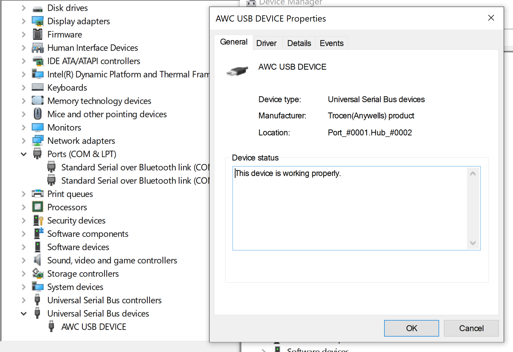

Howdy There! New user testing out the trail of lightburn and I am unable to connect to my AWC7813 controller. It works just fine with laserCAD. I have done/tried the following things:
1.Uninstalled/Installed the latest download of the USB driver that comes from Trocen.
2. Tried the auto detect wizard and it doesn’t find anything. I also made sure laserCAD was shutdown.
3. Manually adding a laser both with just USB and USB/Serial and it just says disconnected and wont’ send any signals.
4. Swapped USB cables (LaserCAD works).
5. Went out and installed the FTMI Drivers hoping it was an issue with the virtual com port, but it doesn’t look like this is how that driver works as it doesn’t show any com port or VAP in the device manager of windows 10.
6. I have restarted the computer and the controller multiple times.
What else should I try? Trocen says this controller is supported by lightburn and I would love to get away with LaserCAD. Please take my money :stuck_out_tongue:
Hi James, It should be connecting to a Com port in ‘windows’.
On the laser panel next to ‘devices’(think it says ‘choose’) change that to auto and see if that helps.
Also have you tried right clicking the ‘devices’ on the laser pane?
Hey There Chris,
Thank you for the reply, yes I tried leaving that on auto. I don’t see an actual port light up. It is odd as it works in laserCAD.
Here are a few pictures of my ports in the windows device manager and also the laser config in the panel in laserCAD and lightburn.

I thought I would update the thread just incase someone runs into this issue. Here is my last reply from support. The windows update and restart didn’t take care of it so I am hopeful that the library update will take care of the issue:
Hi James,
The function we use to query the list of devices looks like it’s failing:
19:23:41.075 D: LibUSB get_device_list failed: -99
19:23:41.075 D: Other error 1
I’ve never seen that before, so I’m not sure why that’s happening.
Try the following:
  • Run Windows Update
  • Power cycle your computer
I know that sounds silly, but I’ve seen no end of weirdness when a computer gets into a partially updated state and hasn’t been allowed to reboot to finish it.
There is a newer version of the LibUSB library available. After our 1.0 release, I can try updating it and send you a version with that change to see if it helps.
Cheers,
LightBurn Software Support
