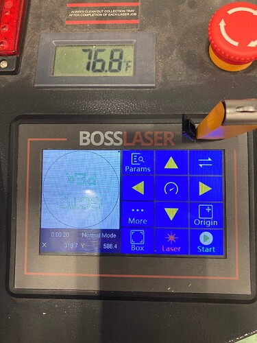

Our device is no longer recognized via USB connection and shows Disconnected in Lightburn. We are unable to send jobs to the laser. This error appears in Device Manager:
Machine: Boss Laser HP3655
Controller: I’m unsure which of these are the controller, or if both are controllers. The first is marked as FTC 61 series and the second is a touch screen which only has BOSSLASER printed on it. Trocen-AWC is what is listed in Lightburn, I’m unsure whether this is the Device or the controller or other. Photos attached.
Lightburn Version: 1.4.03. I believe this has been intentionally not upgraded to the latest in order to maintain use of the purchased license.
Desktop: Dell Precision 3460 running Windows 11 ver. 10.0.26100 Build 26100.
A similar issue happened before but was resolved, as best as memory serves us, by updating the driver. I thought we had to fiddle with COM ports before but I’m also finding info that indicates that they do not apply. AWC7813 Connection Issues

Your screenshot shows that the drivers for your device are not yet installed. If LightBurn identifies your laser as a Trocen-AWC, then this is where you can find the driver that you need to install on your computer for your controller:
Thank you. After installing, the Trocen controller USB driver at that link has restored the connection.

You’re welcome! I’m glad it worked for you! All I did was google ‘Trocen-AWC driver’ and Trocen’s page came up first.
“Might need to install LaserCad to get Trocen’s driver.” -This is because most LaserCAD software is associated with Trocen laser cutting machines, so the driver is usually referred to as the “Trocen controller USB driver.” So in short, it’s just another way to install the driver needed by your laser controller.
From what you’ve stated, ‘We have disabled then enabled, as well as uninstalled AWC USB device via Device Manager and scan for hardware changes with no change.’ - I think this is how the driver might have gotten uninstalled. :slight_smile:
As for staying up to date, I can’t imagine that the driver would be changed or updated anytime soon. Your laser manufacturer or the controller manufacturer would be the best party to ask regarding driver updates.
