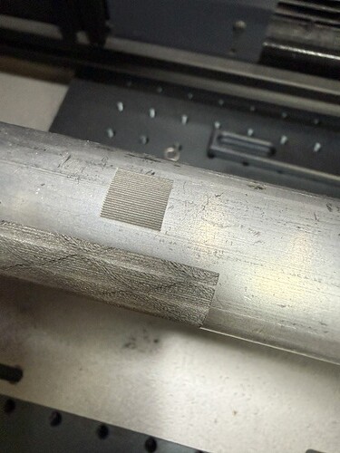

Here you go! 10x10mm square
I should also add:
Cloudray GM-100 100W
Cloudray D80 Rotary, 12800 steps per rev
I see the square… don’t see where the artifact is occurring during the splice edge. What is this stuff? It doesn’t look like it’s a crosshatch applied.

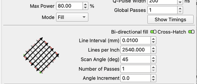

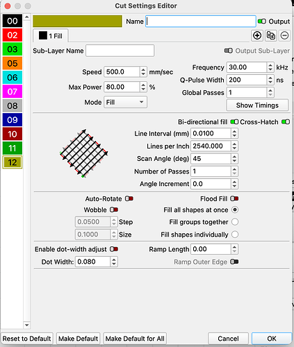

Im confused, you dont see the lines occuring ~0.4mm apart? cross hatch is turned on as per the config picture. If you have other settings you would suggest, i’m happy to try them
I’ll run one with a wider split size size and post it
Left is with cross hatch on, right is cross hatch off
all other parameters the same except split size increased to 0.904mm
I’ve used this and never had this kind of results generated by a crosshatch.
They are equidistant from each other, so that would point to step size or split size. Split size should be a multiple of the step size, so they stay in sync.

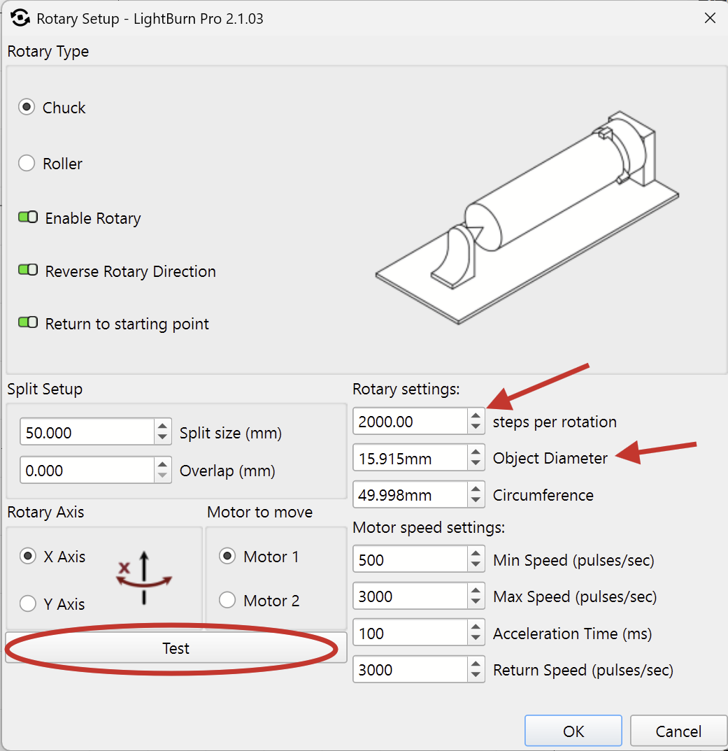

My bet is on a wrong “Steps per Rotation” or “Object Diameter” value in the Rotary Setup.
Let me explain:
The lines here are the individual segments of the splits (0.402mm in this case).
These 10x0.0402mm rectangles are being processed with Bi-Directional, Cross-Hatch and Line Interval 0.01, according to your cut settings
The gaps between the lines is your rotary advancing, what it thinks is 0.402mm, based on your input for Steps per Rotation and Object Circumference.
Solution (Hopefully):
Open the Rotary Setup window, and click the “Test” button:
The Chuck rotary should rotate exactly 360 degrees, and back.
If it rotates more than one full revolution - Decrease the “steps per rotation”
If it’s spot on, measure the diameter of the object in the chuck and update “Object Diameter”. This will automatically calculate the Circumference.
We also made a video explaining this:
I would get rid of cross hatch and change your angle to be parallel with the rotating axis for testing. Crosshatch and angle would be something to use with the “Run Whole Shapes” enabled and small individual shapes.
I agree. As explained at 3:05 in the linked video.
