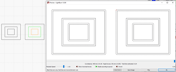

Kerf is applied in one of two ways - Globally, or per-layer, and which one is used depends on whether you have ‘Order by Layer’ enabled in your optimization settings.
This is with ‘Order by Layer’ enabled - The solid lines are the original shapes, and the dotted lines are the kerf offset versions. The one to pay attention to is the 2nd dotted square, inside the outermost one:
This is with ‘Order by Layer’ not enabled:
Because the job is processed all at once, instead of per layer, the “inside / outside” order of the shapes is identical to the “all on a single layer” version.

Okay, lightbulb moment. I assumed I had to do the thinking so I’ve been trying to tell LB what gets cut on the inside and what gets cut on the outside. It turns out that LB knows how to do that perfectly well and all I need to do is stop fighting it.
Everything now has the same direction kerf. Everything now cuts perfectly wherever I put it.

Since we already have to compute inside / outside shapes to be able to cut inner shapes first and for fill grouping, it was trivial to use the same assignments for kerf direction. It works exactly the same as the normal ‘Offset’ operation. I assumed it would be much easier to use it if we didn’t make you manually set all the directions.
