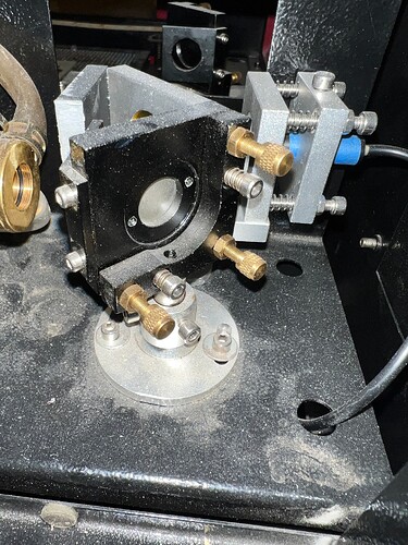

This is what I installed on my Omtech C02. I put it between mirror 1 and 2. It did require a fair amount of modification to make it fit. I didn’t want to mess with moving the tube to put the mirror 1 replacement unit in. Although I did have to replace the tube shortly after and it wasn’t that big of a deal. If I had to do it over knowing what I know I would have used the mirror 1 replacement instead.

I bought my machine used. It wasn’t cutting properly when the seller demonstrated it and he told me up front that it might need a tube. I did a fair amount of work, replacing the mirrors and aligning them and got it cutting again, but it never seemed right. It had approx. 250 hours on it at this time. I installed the beam combiner and didn’t really notice any difference as far as power output, but I was still pretty new to the laser business and the tube wasn’t functioning properly. After seeing similar machine settings and comparing mine, I realized mine wasn’t working right. I did some testing and discovered that it was out of TEM00 mode. After replacing and aligning the new tube, I’m very happy with the performance.
The beam combiner I installed has some issues. First, I had to modify the mount considerably to get it installed where I wanted it. Second, the red dot is not 100% in alignment with the beam. Trying to introduce a 4th mirror into the middle of the beam has proven difficult. The best I have been able to get it is about 1/2 the diameter of the beam off. I know where it is in comparison to the actual beam and have adjusted my mind to it. Nothing I do is that precise that half a beam width will make a difference, except doing a print and cut, there I get it close with the red dot and pulse the laser fo final positioning.

Here is how mine sits in the machine. I totally agree with @jkwilborn that before mirror 1 is the better location and if I was to do it again that is where mine would be. I didn’t want to use the mirror 1 replacement setup as it requires moving the mounting location for mirror 1 and I was afraid I wouldn’t be able to get it where it needed to be.
I think the type that mounts to the end of the tube is probably the best option. If I would have known that I was going to replace the tube a few months after I installed this I would have just purchased the tube with it built in.
The post mount that came with this kit was too tall and I had to use a different post mount. I had to cut off the edges where it sits on the deck so that it would fit between mirror 1 and the flange. I also had to modify the mirror mount slightly as you can see by the bare metal on the black shield nd the V notch in the bare aluminum.
Holy Cripes…
This is a tight spot :slight_smile: great job installing it…
Looks good…
Now it just needs a good cleaning :tada:
