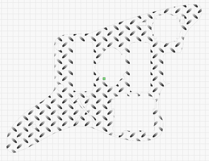

A friend is making a guitar as a present for a firefighter. I am designing and making the pickguard. At this point I am simply trying to figure how it will burn and what the end result will look like, vs anything to do with speeds, power and material. Specifically, will the base graphic burn as shown with the faux metal appearance. In preview the ellipses show as solid and not shaded or is that for simple appearance in preview. My understanding is that Lightburn works using hidden line removal. In other words anything hidden by an object at a higher level will result in the area under that object not being burned at the lower level. Otherwise things would be burned one on top of another. Is this correct? If so does the order of the objects in the burn list matter or does Lightburn work it out from the layering? The artwork was designed in Inkscape and imported into Lightburn. In Inkscape it is in layers but it did not import in layers when I thought that it might. I have included the Lightburn file

If something is in a layer in Lightburn and the output of that layer is “On” then it gets sent… regardless of whether it’s behind something on a subsequent layer… it gets burned twice.
If you don’t want that diamond plate to show behind those badges and other artwork… you need to cut out around them. Otherwise it will burn the entire diamond plate artwork and then also burn the badges over that. Lightburn won’t do that automatically for you.

Yes, overlapping layers will engrave/cut/burn on top of one another.
However, in this case it is relatively easy to fix this by “Masking” the background image using the shapes on top of it.
You’ll need to start by Tracing the images in the foreground. Since they’re relatively simple black and white images, it will be easy to get a good trace from them.
You can choose to delete the images altogether and just work with the vectors produced from them set to a Fill mode, or you can keep the original images, and delete everything you get from the trace except for the outline (I recommend either working with vectors set to Fill, or setting all of the foreground images to “Threshold” mode).
If you choose to work with all of the vectors, you’ll need to duplicate the outline. In either case, the outlines will need to be set to a Tool layer.
After you’ve done that for all the foreground images, create a Rectangle around the entire background image, and set it to the same Tool layer as the outlines.
Hold the Shift key while clicking the Tool layer in the Cuts/Layers window to select all shapes on that layer, and then Group them.
Then select both the background image and all the shapes on the Tool layer, and right-click, then select Apply Mask to Image. The area covered by the foreground images will be removed, preventing layers from burning on top of one another.

If you added new images over the background image, you would need to re-do the masking process to include the outlines of the new images.
In some cases tracing, outlining, and using the boolean tools as you suggest would be a better method. The reason masking is a better option in this particular case is that the background image has shading to it, so it needs to remain on an Image layer to capture that shading in the engraving.

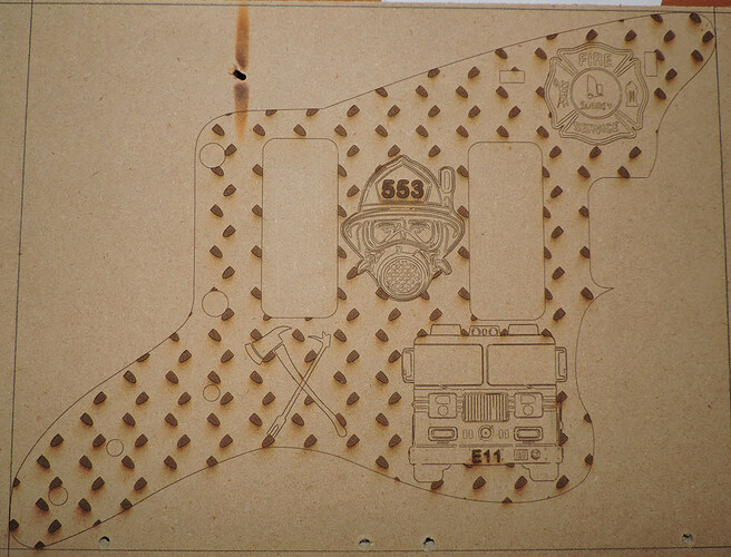

I did a test burn on MDF. Everything was Ok except the background image did not burn as shown in the Lightburn file. The shading did not appear. I have attached the burn and the background image. Is there something that I have to do to correct this?
What dithering method did you use for the background?
