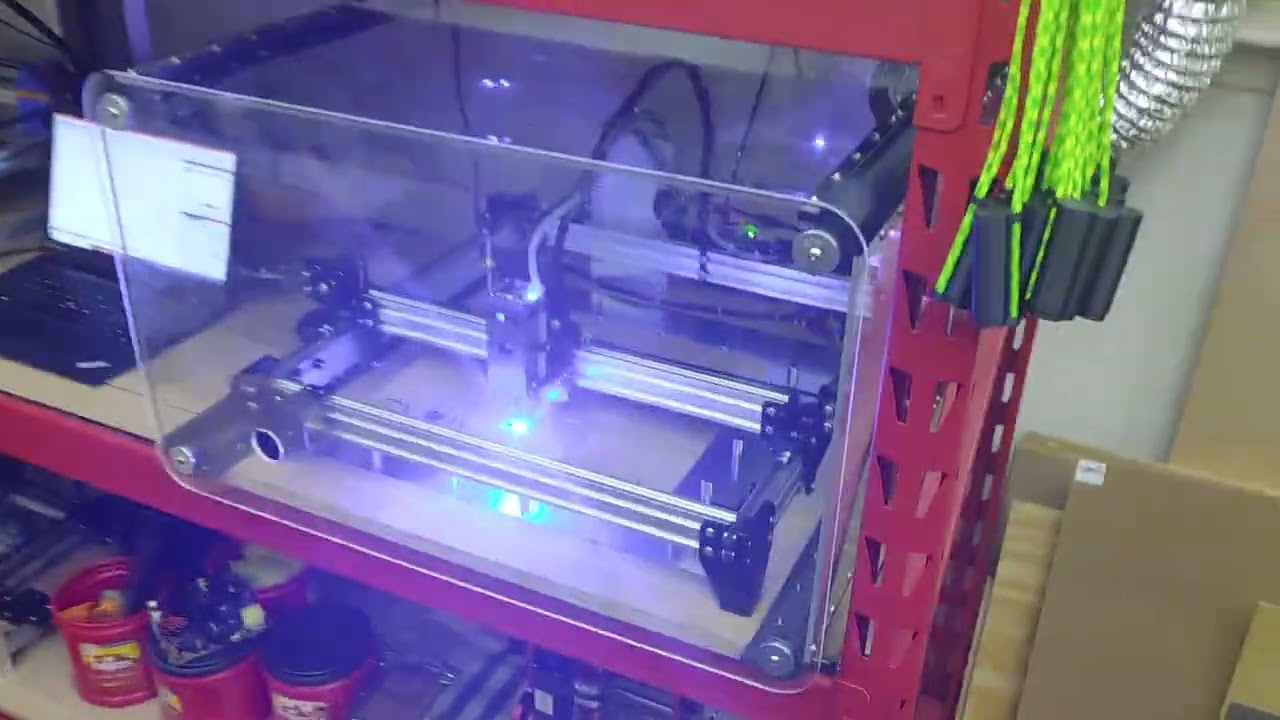

Finished building my enclosure/ exhaust. Works so much better but im still experiencing burning on the reverse side. I got rid of the grill and started using magnents with screws on top. I have smaller magnents coming in the mail today. The burningnonly happens when the laser hits the tip of the screws. I need find the thinnest alternative to the screws to get that to stop.
Burning on the back of a cut is somewhat inevitable, particularly with laminated wood filled with glue. The screw pin bed is awesome, great work with this little machine. I dig it. Now try some etching and see what sort of resolution it can pull off!

I literally just upgraded the magnet/ screw stands. So much better. I bought some 12mm counter sunk magnets and some #6 brass wood screws. I cut the screw heads down in my lathe so that they just protruded a tiny bit so magnets hold them down nicely.
