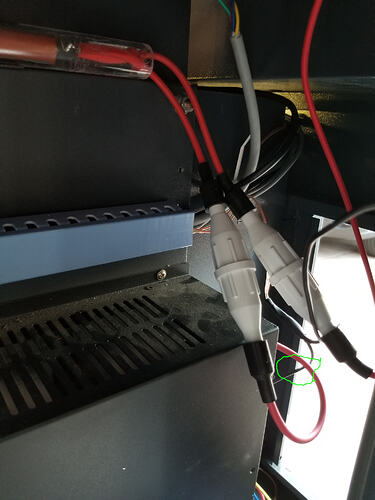

I suspect there is an issue with the anode connection, but I am a little bit beyond my expertise here so am hoping for advice before I go to far into disassembling and rewiring the work previously done.

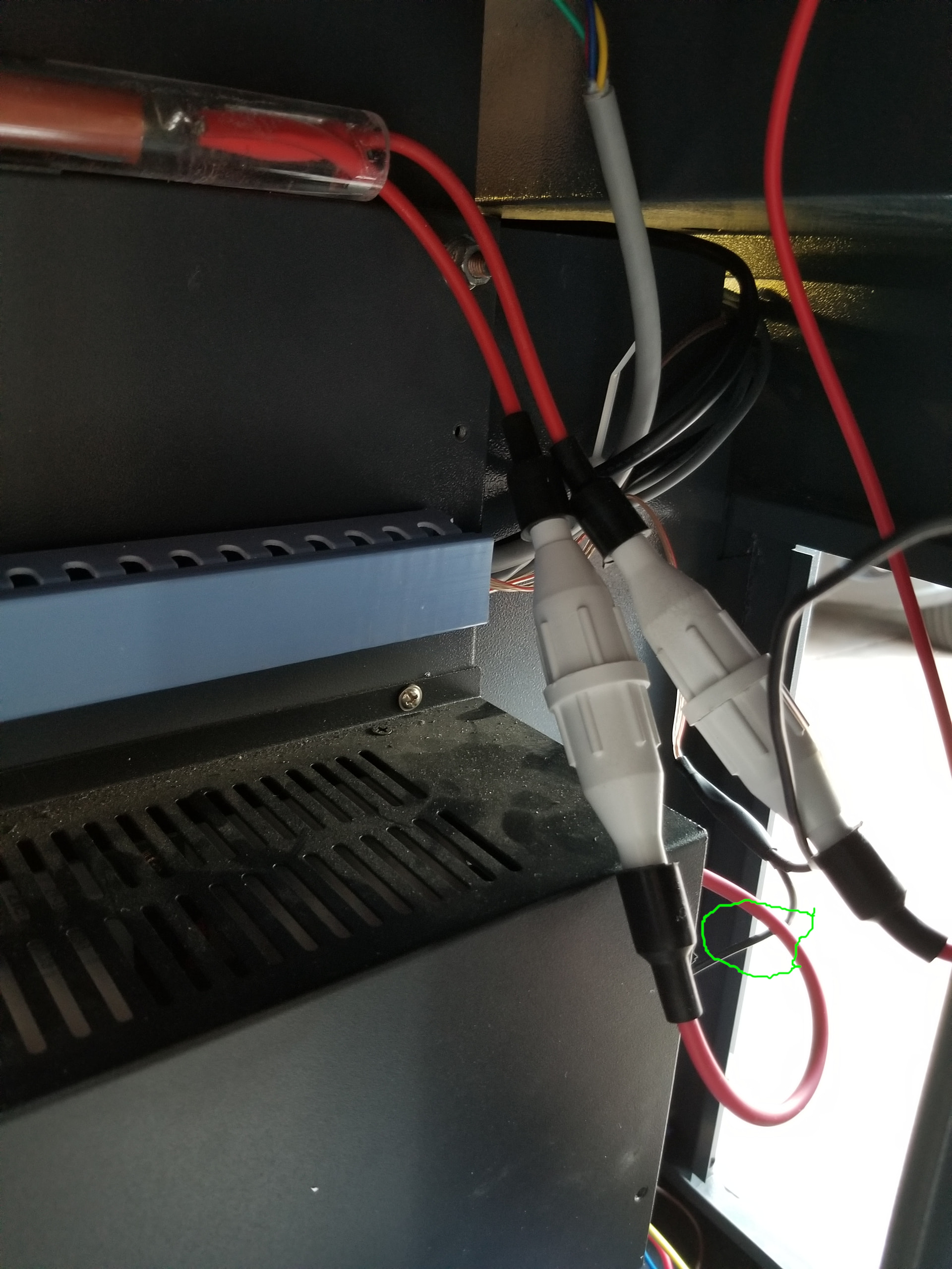

Because that is the high voltage wire, do not use DIY insulation. The power supply anode connection must be firmly attached to one end of a high voltage connector and the tube anode wire should be firmly attached to the end side. If there are any intermediate connections, replace them with a single run of HV-rated wire from the tube to the HV supply connector.
If the anode wire is arcing to the machine frame, the arc will have charred the insulation and you must replace that part of the wiring with a complete run of new HV wire. DIY insulation repairs will not work with high voltage wiring.
The cathode wire is (generally, see below *) at a low voltage unless it becomes disconnected from ground, at which point high-voltage hilarity ensues. The cathode wire in my machine had a loosely twisted-and-taped joint that I replaced with a crimped connector.

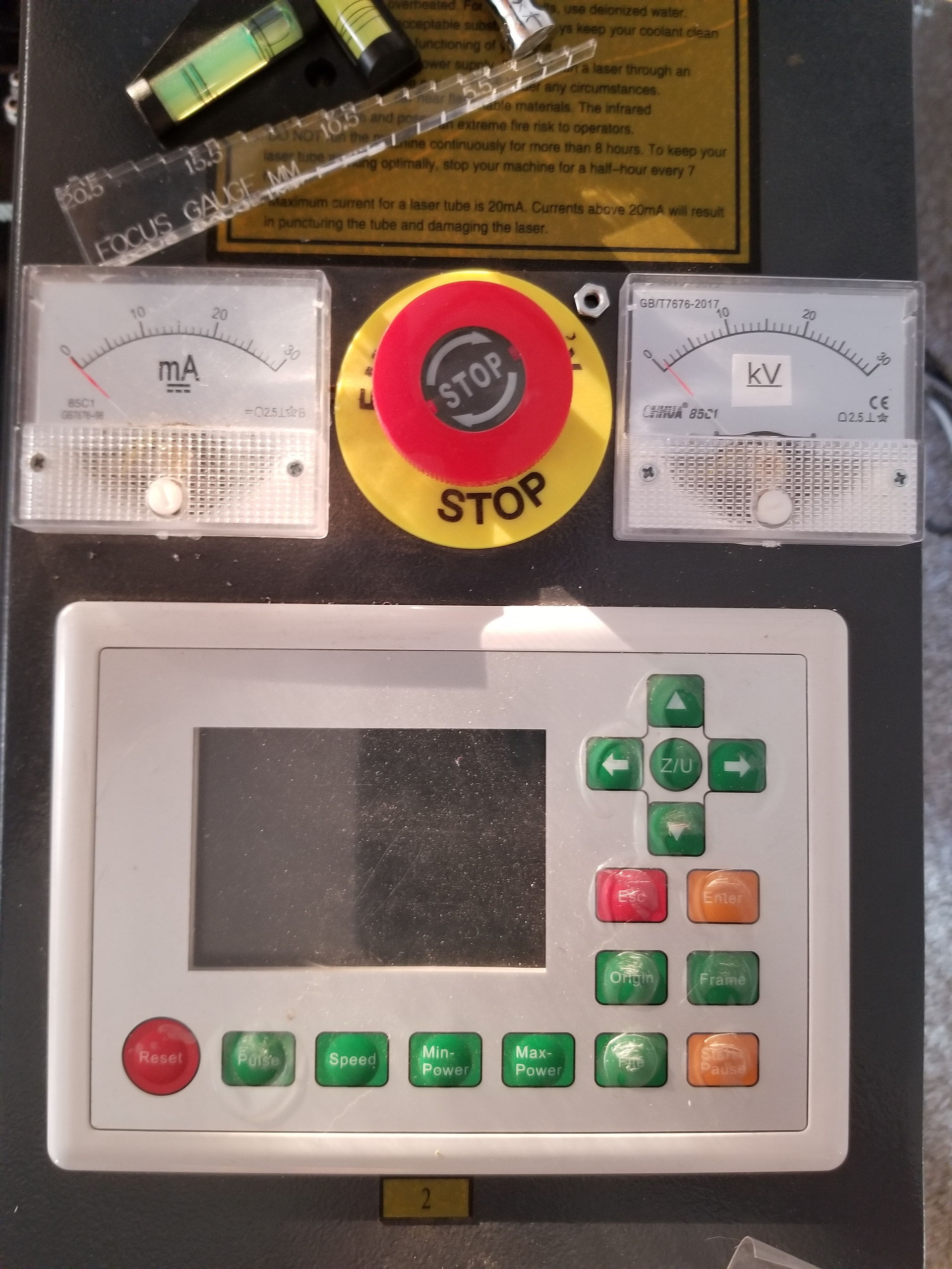

Stick a 30mA mechanical meter in circuit. Most meters read RMS voltage so it’s dependent on the waveform the meter sees, but mos of this is digital and depending on how the machine is wired up the readings could give you misleading results.
Most of us prefer a mechanical analog mA meter over a digital one. These are standard meters, left is a 30mA and right is a 50uA meter for voltage.
On my machine the ground return for the cathode is a small black wire, only the anode has a lot of insulation. The area circled in green shows the anode (red) and cathode (black) wires, only the anode has a thick coating of insulation. I get the white connectors from Amazon and use these exclusively for HV connections.
