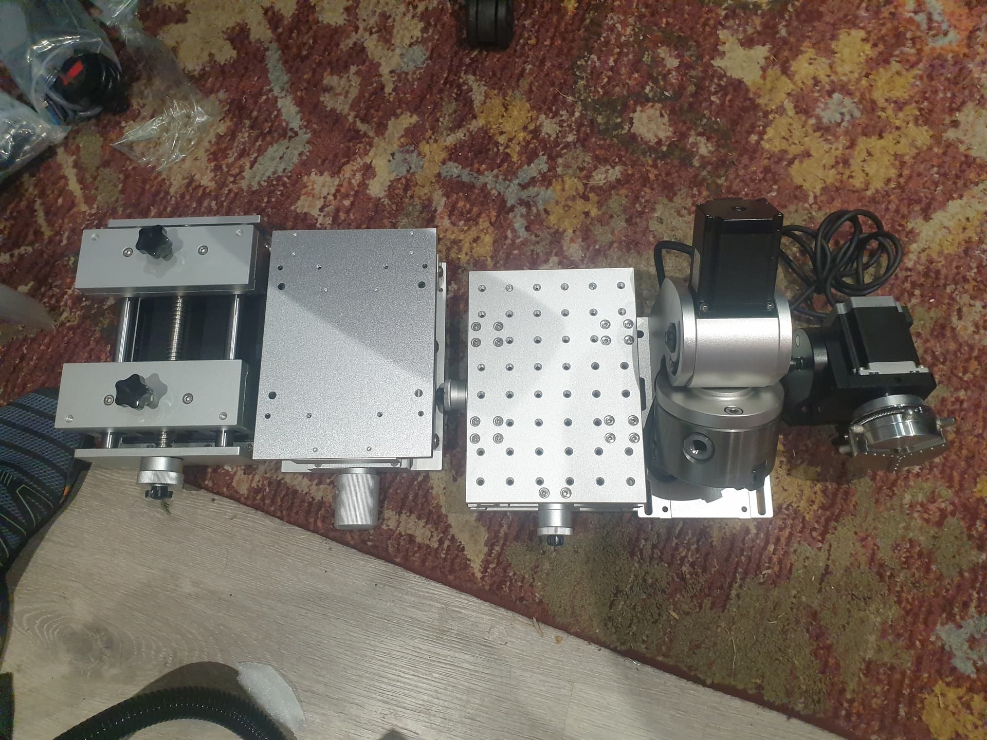

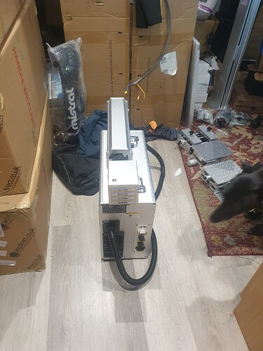

Received machine yesterday evening from Hoatian - 60W JPT MOPA EM7 laser machine, but without any instructions of how to assemble everything and set it up, is it straight forward to do?
Also, I believe I will have to purchase Lightburn, but after looking on their website Buy LightBurn – LightBurn Software I think all I need to get started is a trial version of LightBurn Software & Galvo license key. Is this correct, or will I need something else?
You should probably start a new thread, as it’s not the same question.
Pick up Lightburn trial and it’s usable on any machine, all different types are supported. Eventually you’ll have to purchase it with the galvo option.
