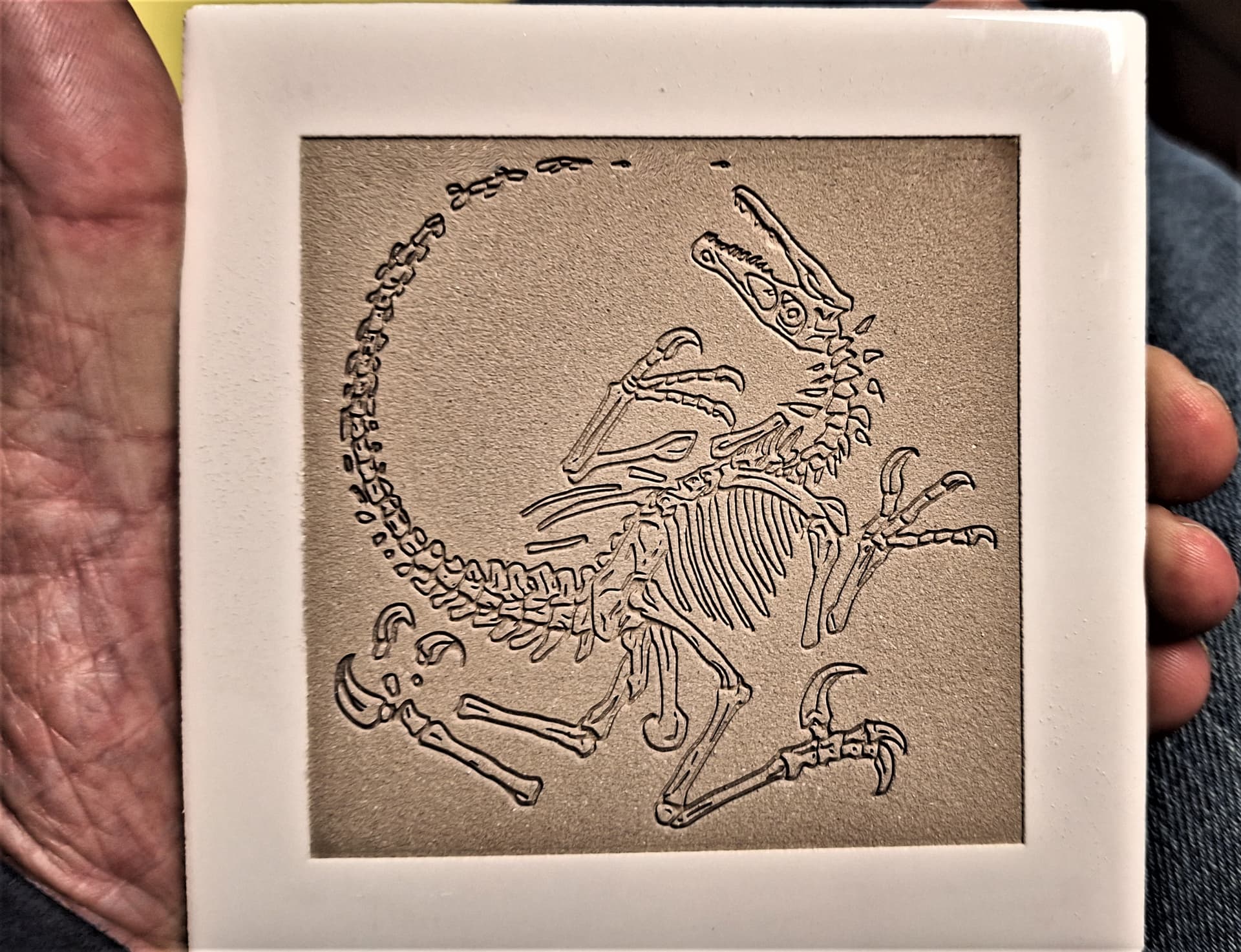

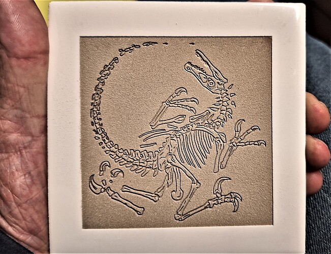

Rocks

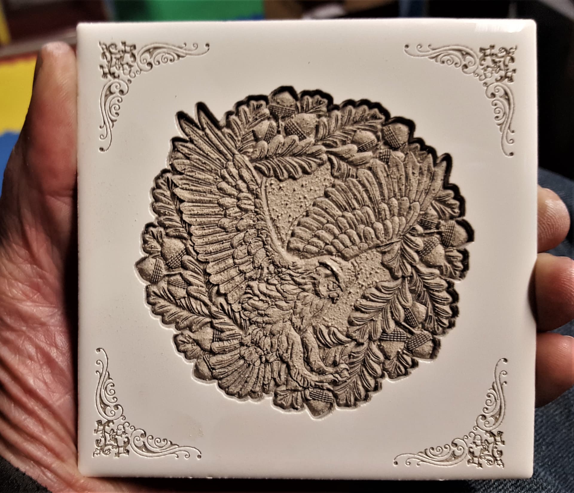

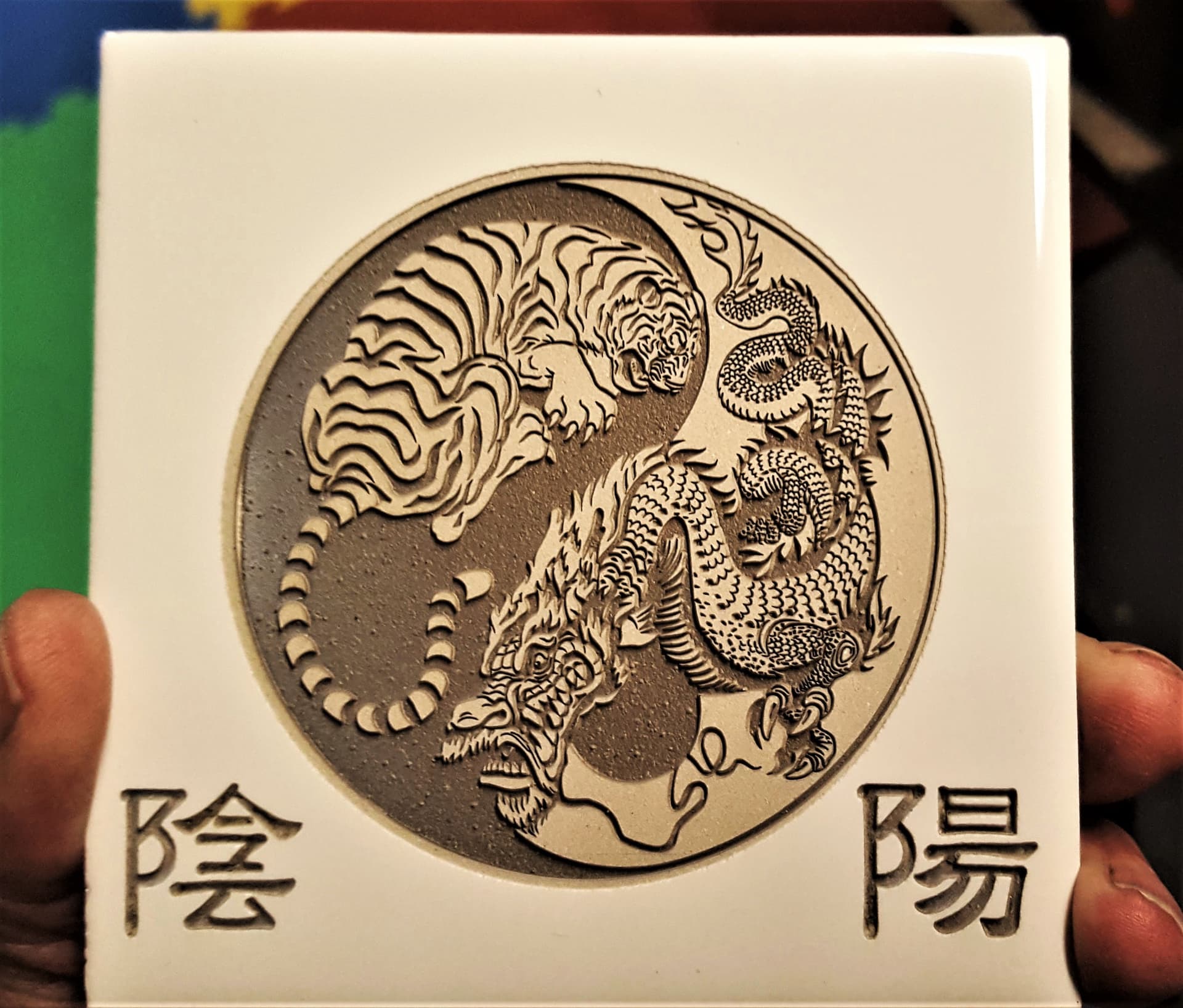

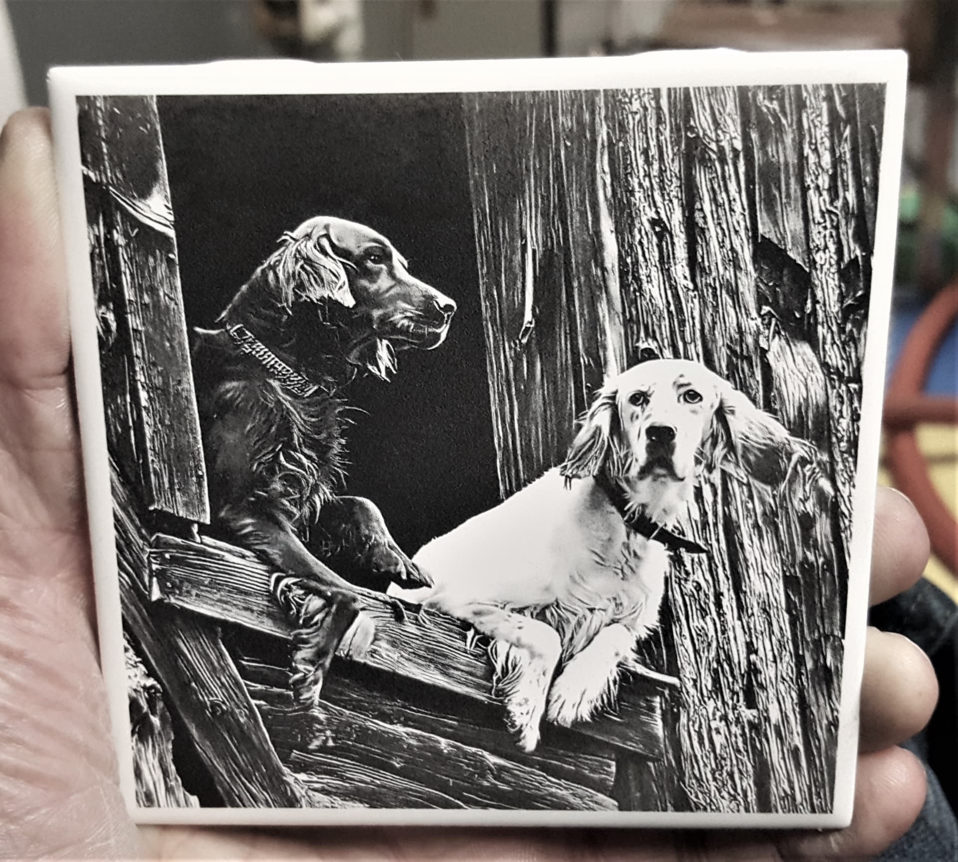

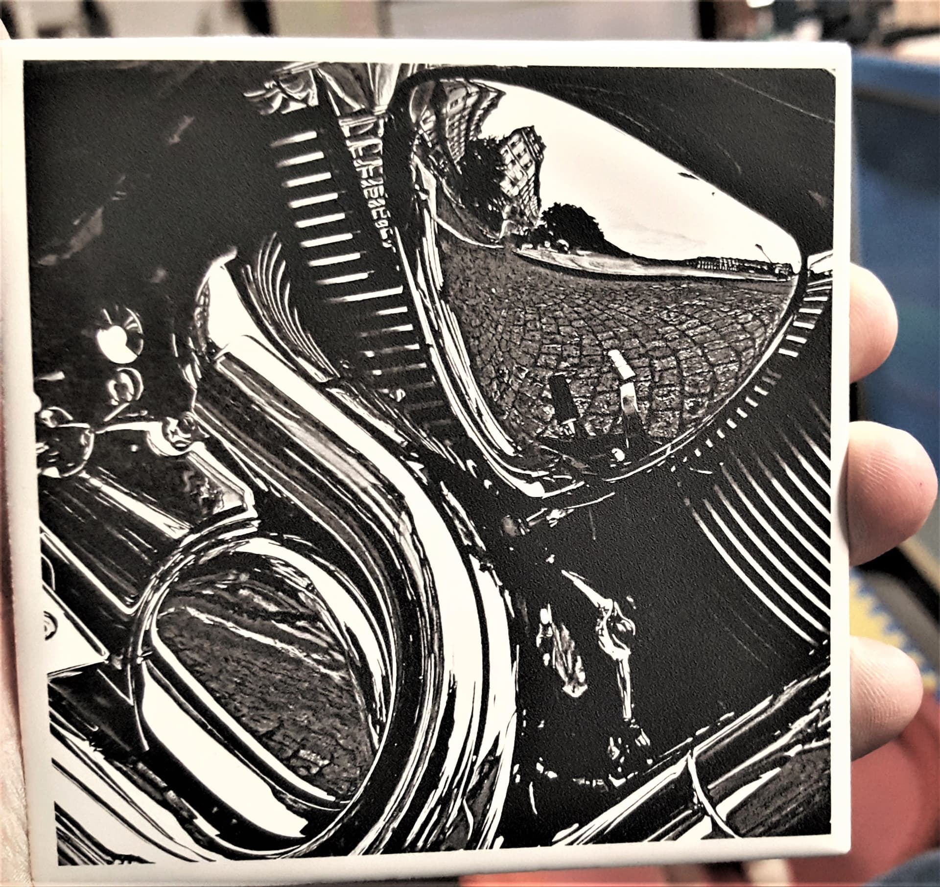

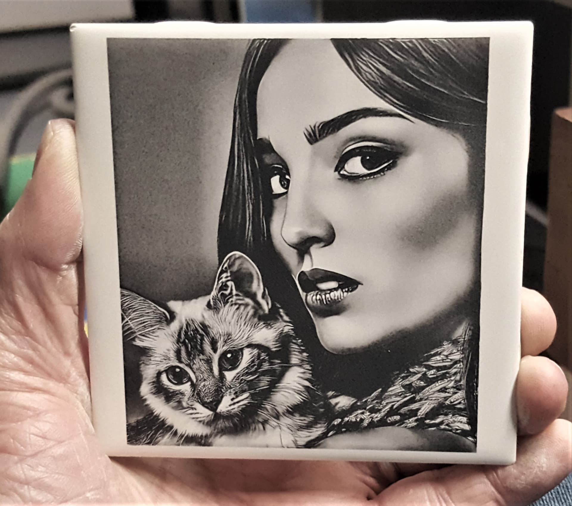

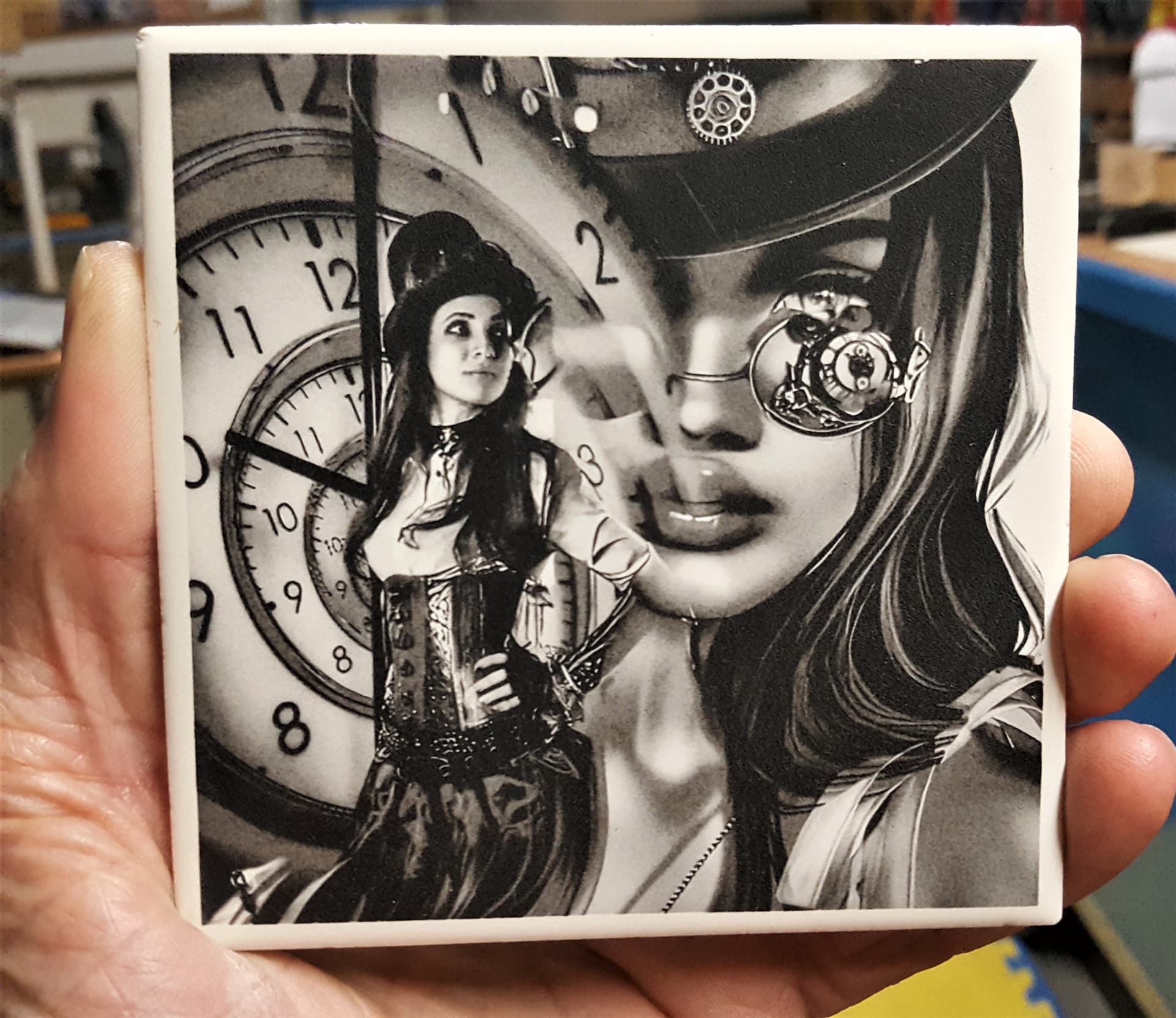

White ceramic tile

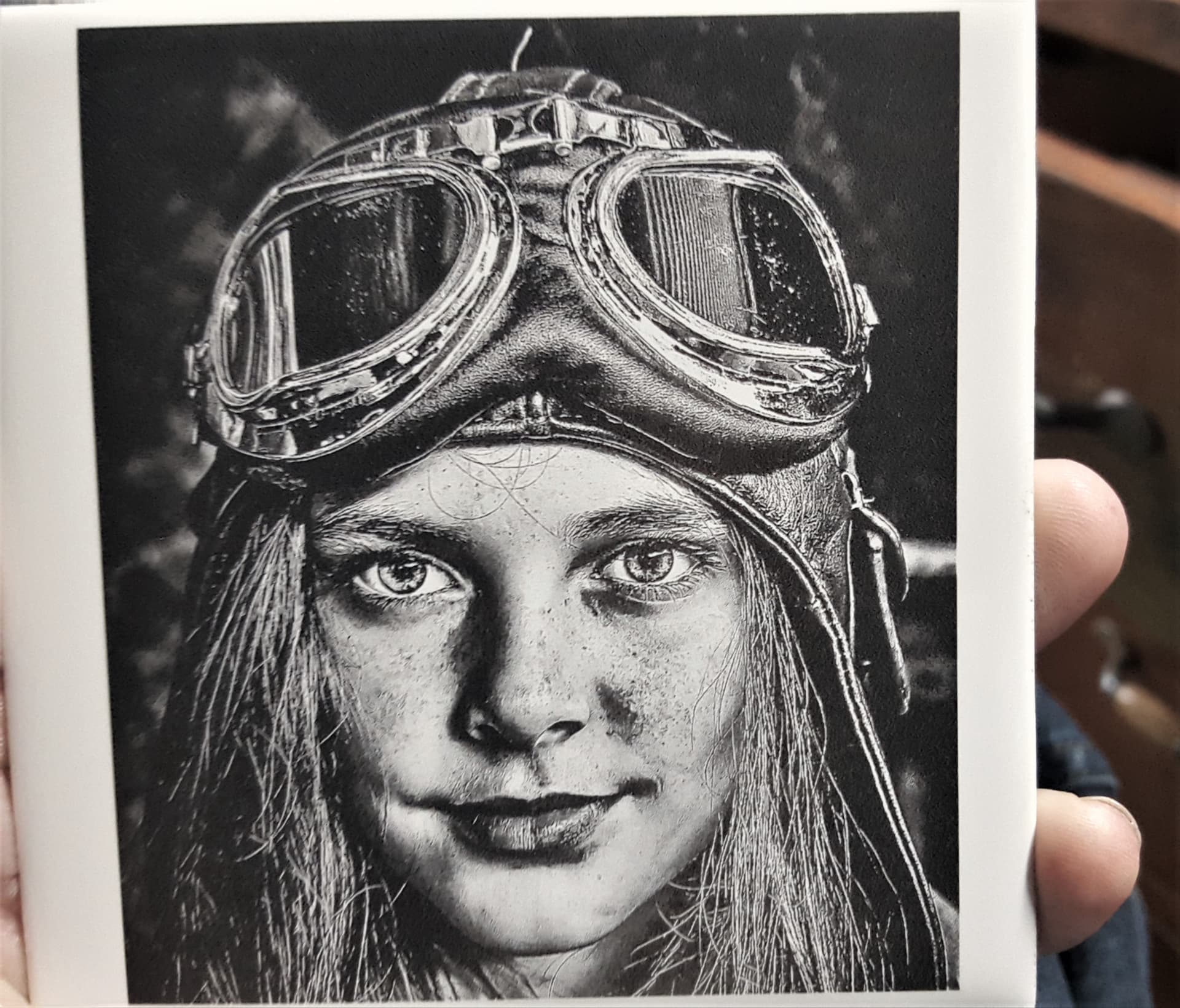

Norton White Tiles With JPT
60 watt MOPA

The fiber is a pulse laser… my 60W fiber produces 18kW pulses… this is much more destructive to a lot of material.
I have a few diode lasers, along with a China Blue co2 and a JPT M7 MOPA.
IMHO, for doing rock, you need a fiber… A co2 can mark stone, like slate, but it’s poor at applying any kind of depth.

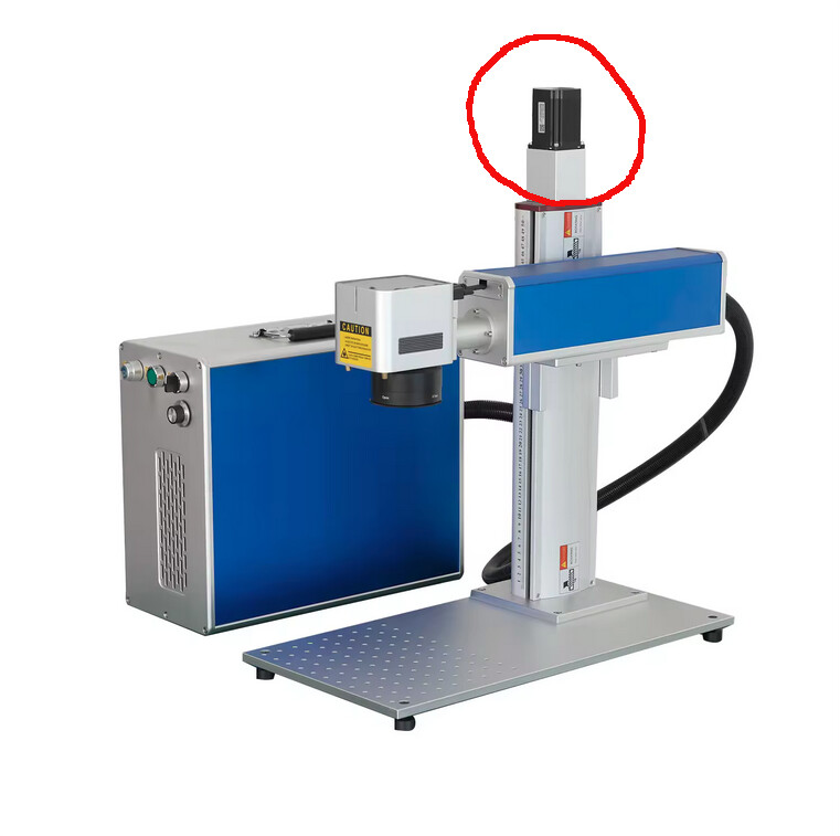

Most of the machine specification I can tell about are ok.
The only problem with this machine is that I doubt this machine will work with Lightburn.
It has a Z axes stepper motor. That usually indicates EZCad3, which isn’t supported by the current software.
It needs to run EZCad2 to be Lightburn compatible. Of course, the add says EZCad, no specifications if it’s 2 or three…
