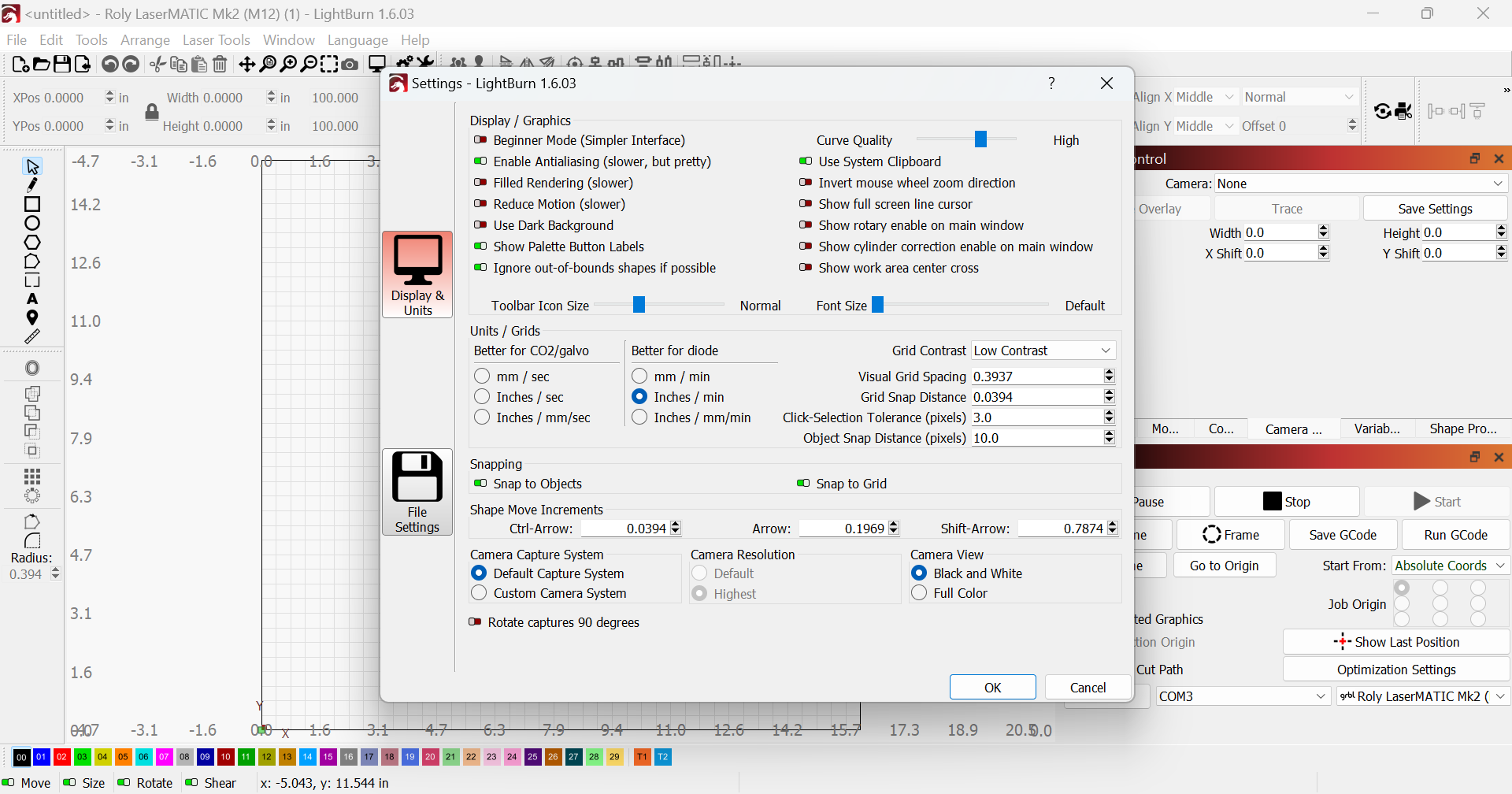

So my problem still exists with lightburn not seeing my camera. I have now gone back to version 1.6.03 thinking an older version worked for other people. Not so for me. Lightburn does not show my camera in the drop down box. It shows my computer camera and that may be where the problem is. In looking in the setting (attached) there is a section the states camera resolution. There is the option for default and highest resolution. It is LOCKED in the highest resolution which is my computer camera. How can I get this to let me choose default?
Well the problem has been solved. Since I changed out almost everything I could think of, I next got a new camera cable. That was the problem all along. With the way the cable is snaked thru the machine I felt there was no way that could be the problem. Sorry LightBurn for thinking it was the software and thanks to all that tried to help.
