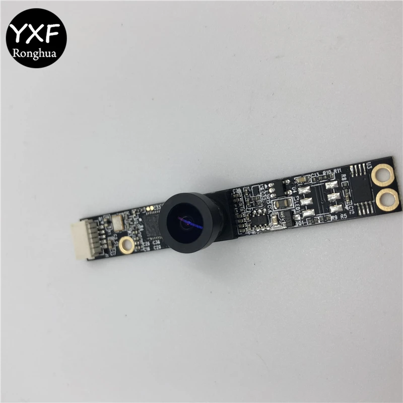

Hi, I got a new camera for the Ortur LM1 because I wasn’t satisfied with the previous.
But during the calibration of the lens after a random number of capture the all thing freezes.
It’s very frustrating because it’s very random, sometimes I can go through the first step and sometimes not.
What camera?
166° CMOS OV5648
