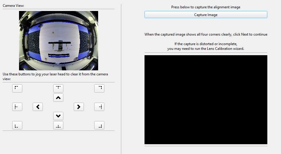

Anyone having issues with the camera in LightBurn? I have LightBurn Pro 2.0.02 installed. I had to re calibrate my camera but when I run the camera alignment I get a blank screen. I uninstalled, restarted and changed the USB cable. I ran the calibration wizard multiple time with the same results. Laser: 1Laser XRF
I have the same issue with the Falcon2 Pro 40W.
@ronselljr @RonPdm let us know if this helps:
Hi Aaron, thanks for the tip. The workaround was successful, the camera works.
However, with the default settings, the actual calibration using the âclassicâ method is inaccurate, especially on the edge. So the camera is not really usable.
That sounds promising! Thank you for the feedback.
By âclassicâ method, do you mean the old way of calibrating the lens with the circles pattern?
Yes, this is why the lens calibration with Tracking will become the default method.
Itâs important to know that the Camera Alignment can only be accurate at the height at which the Alignment was performed.
