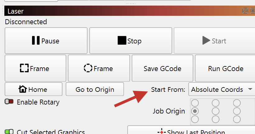

The “Start From” value should automatically change to “Absolute Coordinates” when doing a Camera Alignment.
I’ve also heard that this has been omitted in a new version.
If that’s the case, set the value manually to “Absolute Coords” beforehand.

It does automatically place the start from in Absolute Coordinates. That part is ok, but once the calibration has been done, I think my problems begin. Since the Snapmaker laser bed moves in the Y direction, The camera no longer has the same view of the job/placement as it had during calibration. It also seems to work from the Work Origin that is set on the Snapmaker and not the real Absolute Origin. There is something I am missing in this regard ad I am trying to figure that out.
