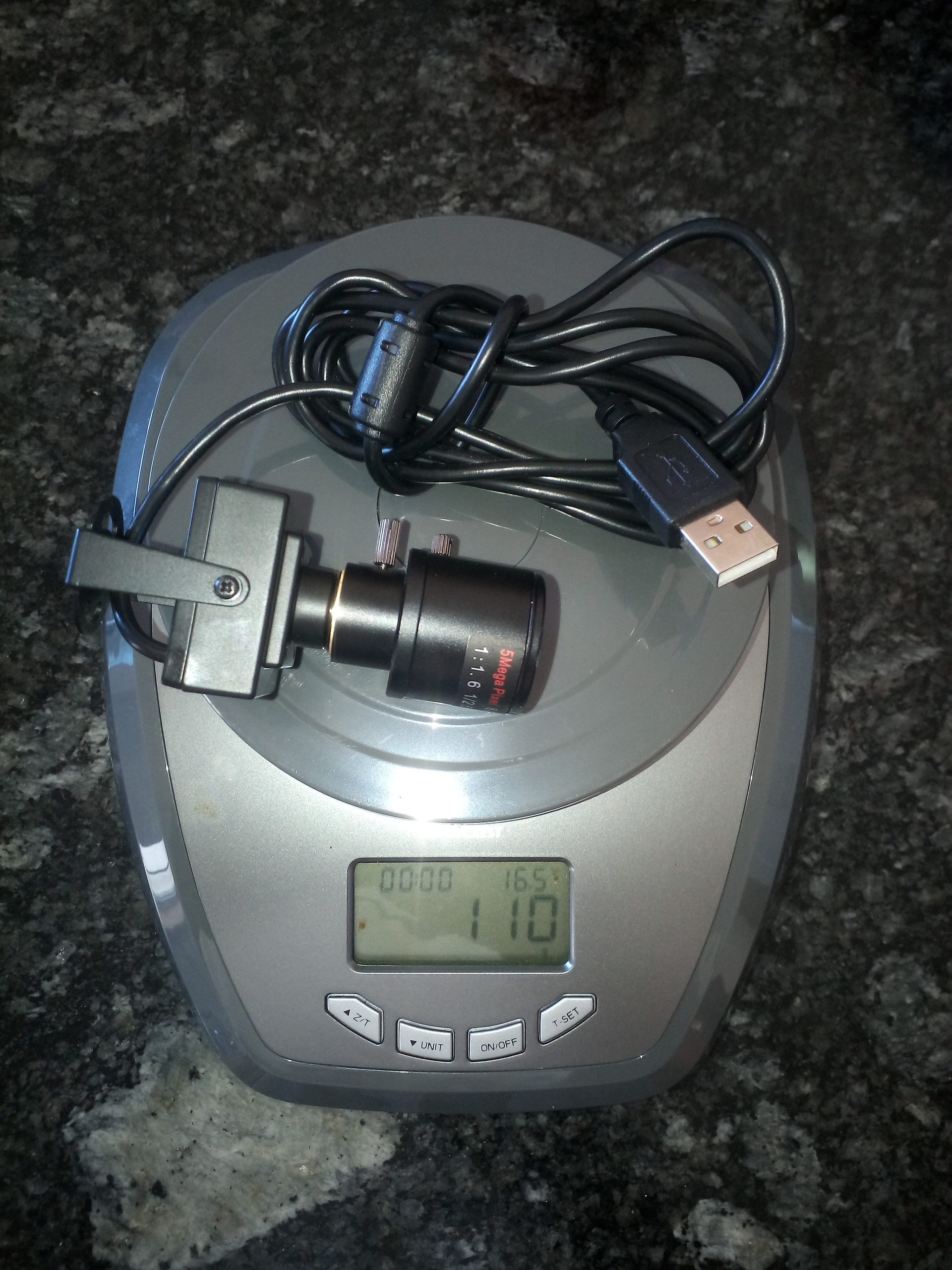

So, this is the camera in question, which cost around €45 and weighs 110 grams.

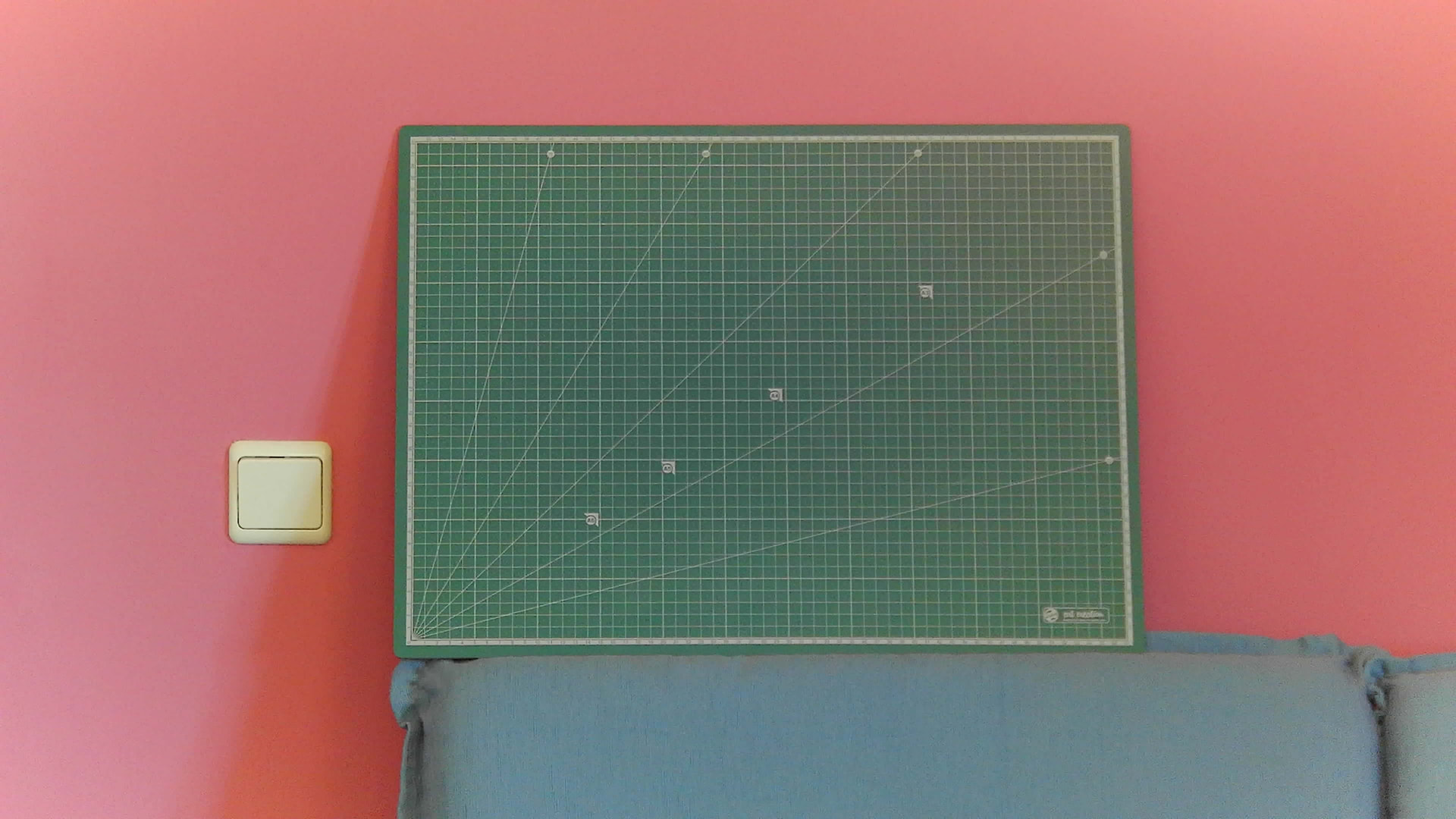

In a quick zoom test, I can show a green A2-sized cutting board at 4 meters (157-ish inches).
I was unable to test the honeycomb (40 x 40 cm) (15.7 x 15.7 inches) due to insufficient USB cable length.

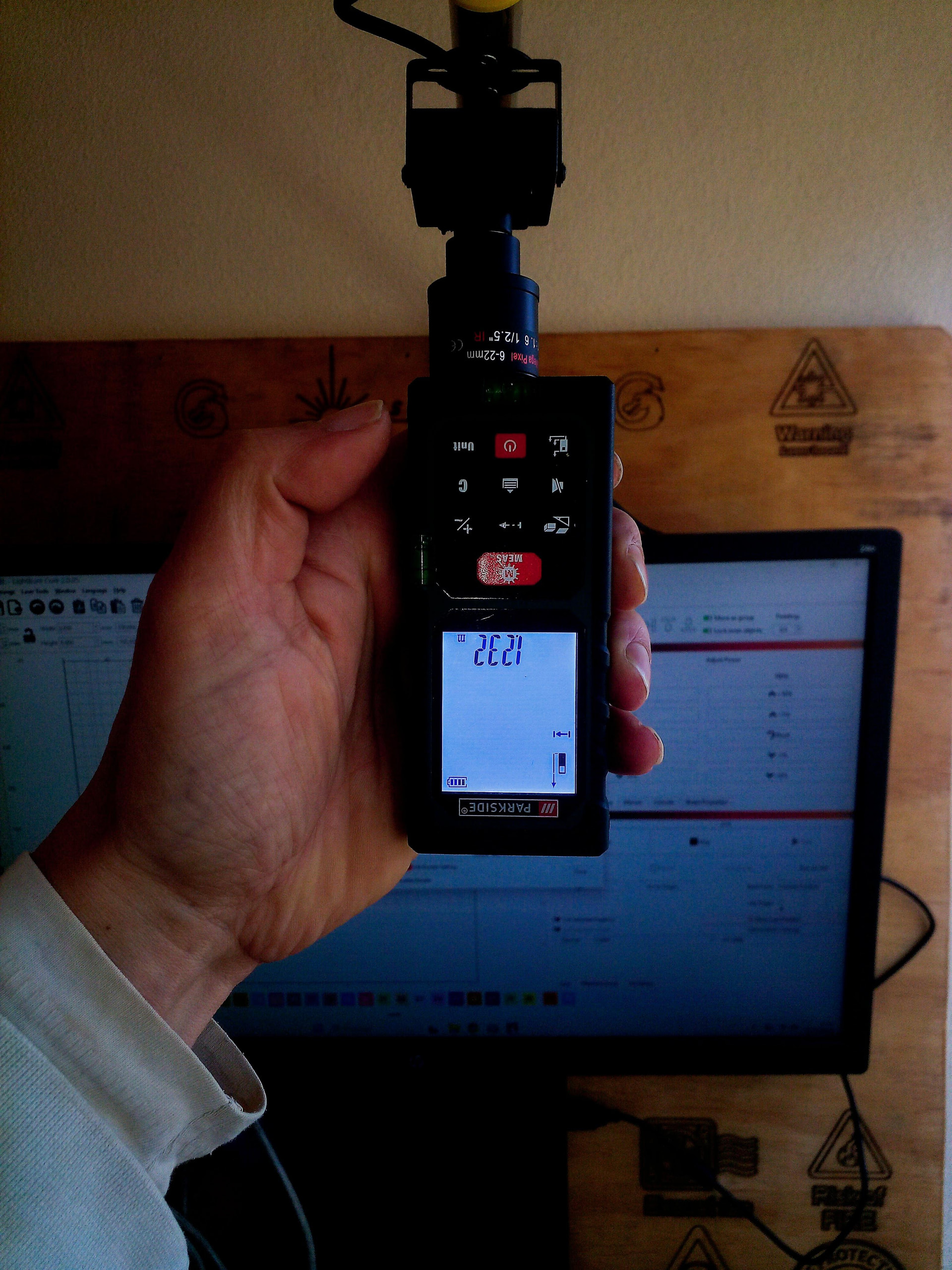

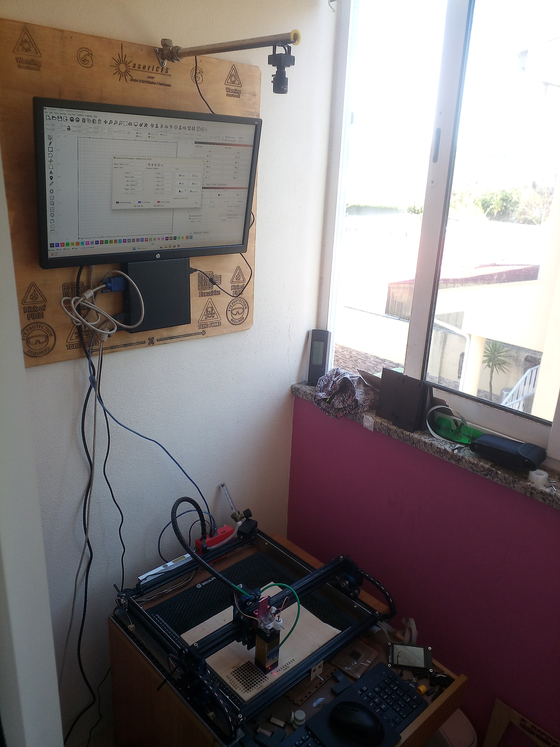

The camera was mounted on the panel where I have the rest of the setup fixed. I didn’t permanently fix it to the wall because I know the wall is made of brick and drilling holes as close together as I needed wouldn’t allow for an effective mount.
The rod is about 40 cm (15.7 inches) long and the height is 1.23 meters (48 ish inches) to the honeycomb .
It was also at this time that I realized how quickly I’m getting old… When I chose the camera, in my head, the height wouldn’t be more than 1 meter (39 ish inches) :smiley:

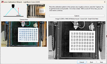

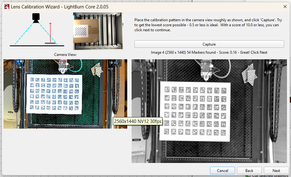

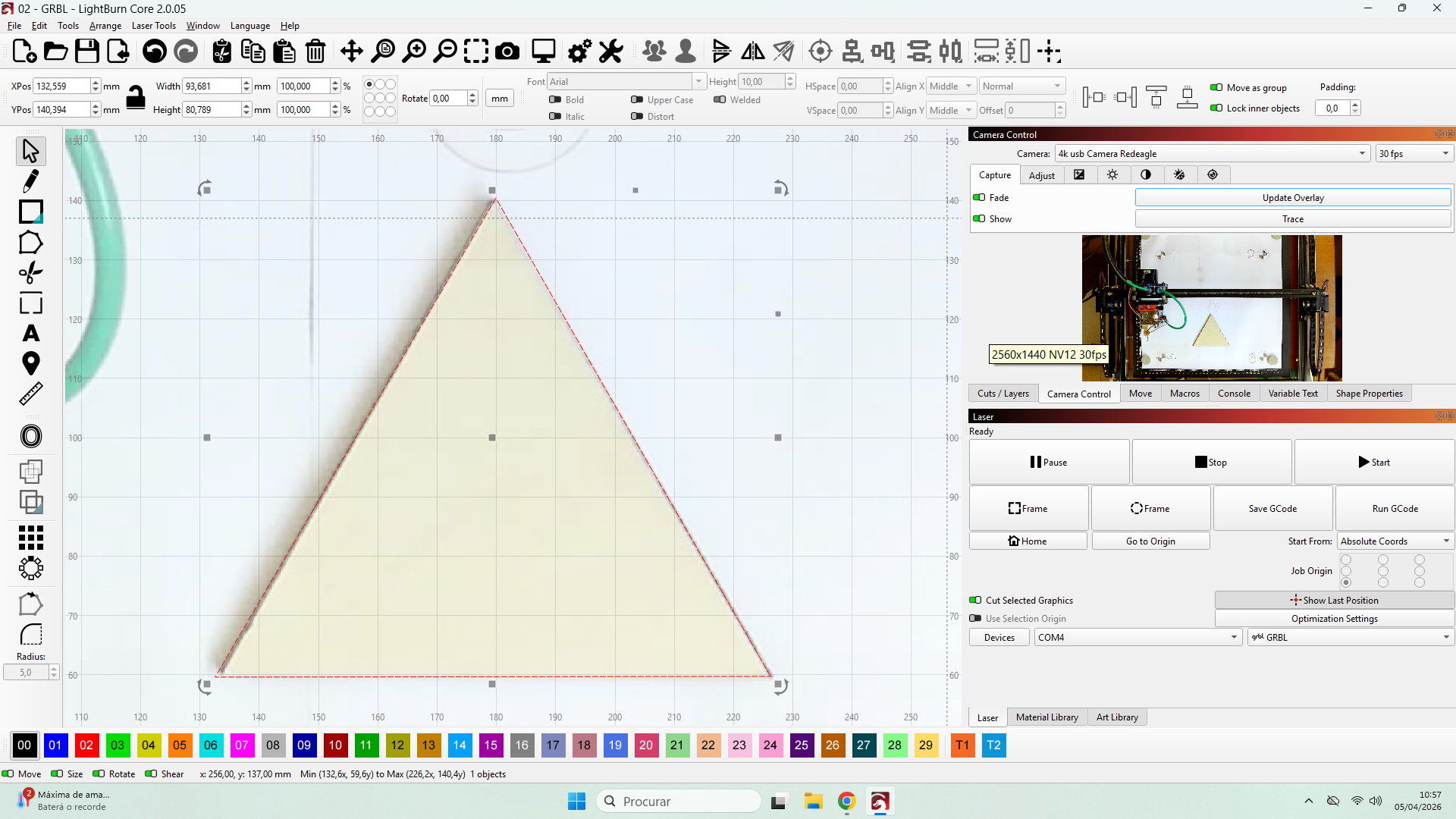

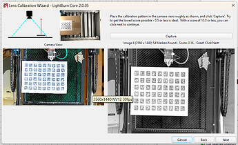

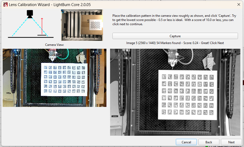

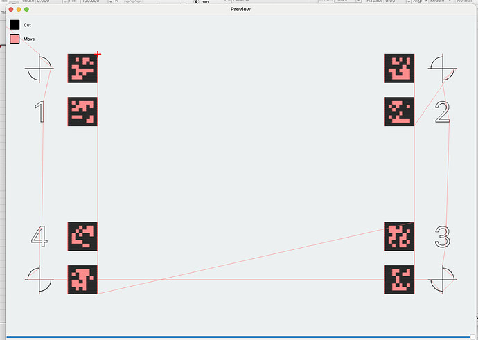

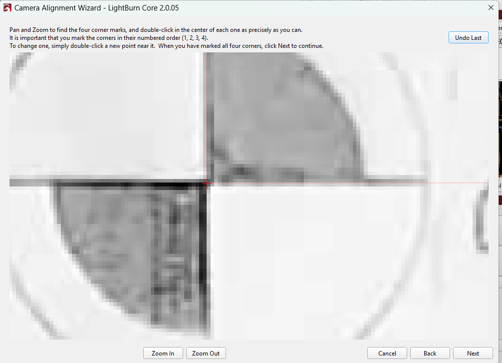

The lens calibration went smoothly. I used the “AprilTags” system, and while values ​​below 0.5 are ideal, I achieved values ​​between 0.24 and 0.16.

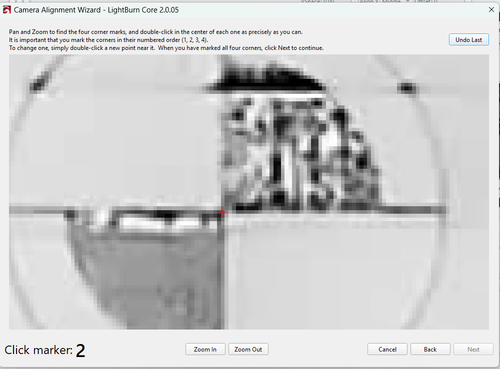

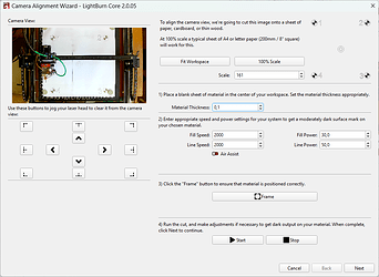

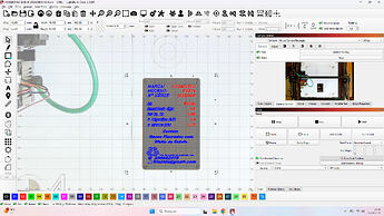

The alignment process, however, was the opposite; it took over an hour of trial and error (and some mistakes) to find the ideal scale value of 161%.
It started at 145% (default)
(Green line represents the jig holding the business card)

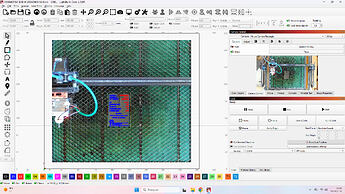

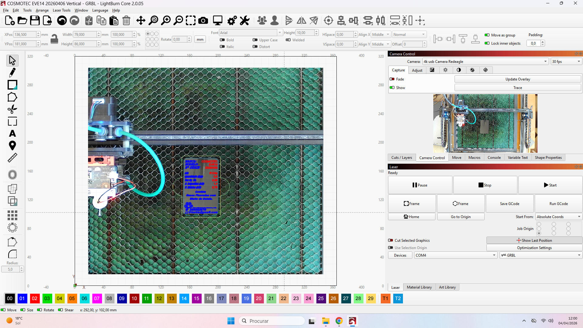

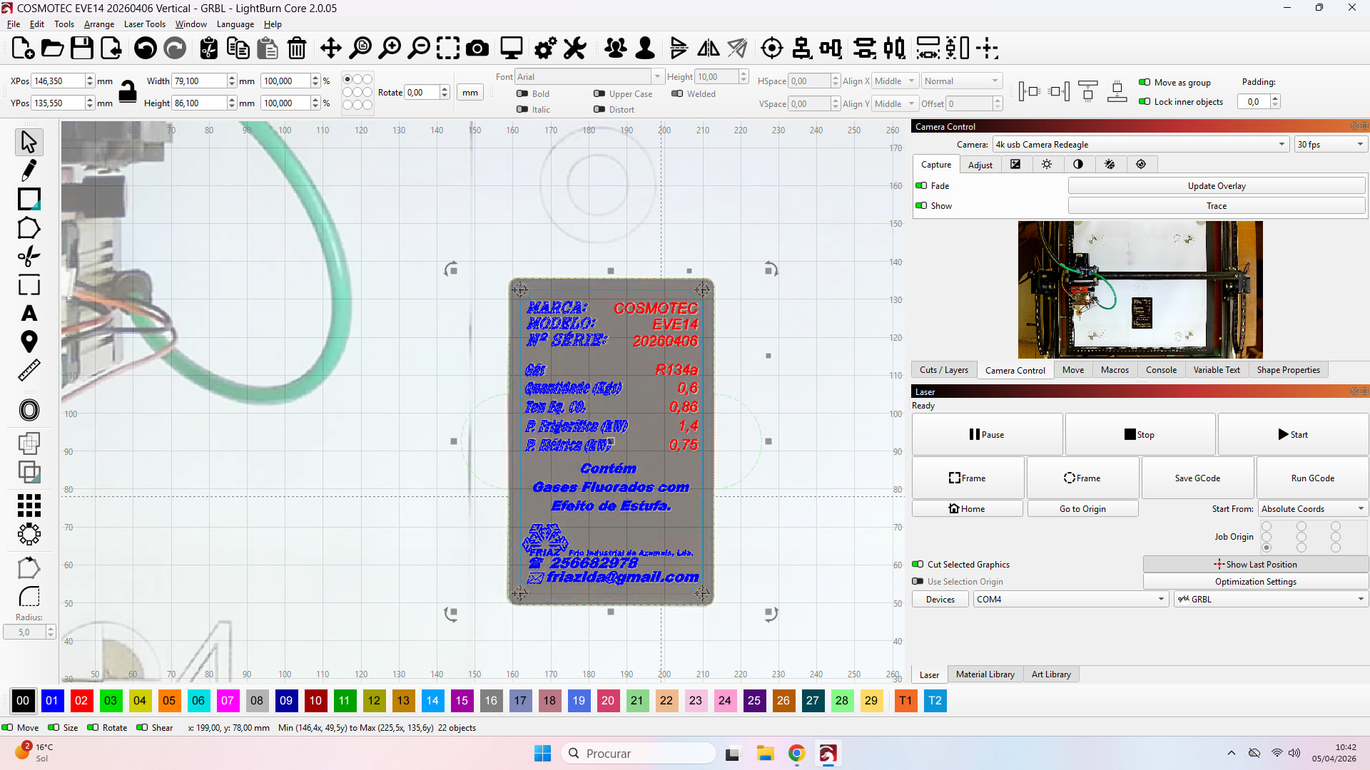

And finally I achieved the alignment (I would say perfect).
This is a business card in anodized aluminum (transformed into an equipment identification plate) previously made and now aligned with the image.
Then I tested a leftover 4mm plywood from a previous job and, basically, no alignment adjustments need to be made.
Of course, the fact that the object is in the center affects the results; probably if the test is performed at the edges of the work area, the result will not be quite the same, but I believe that for this type of work, modifications will not be necessary.
I believe that for work such as screens and other taller objects that extend beyond the edges of the work area, adjustments will have to be made.

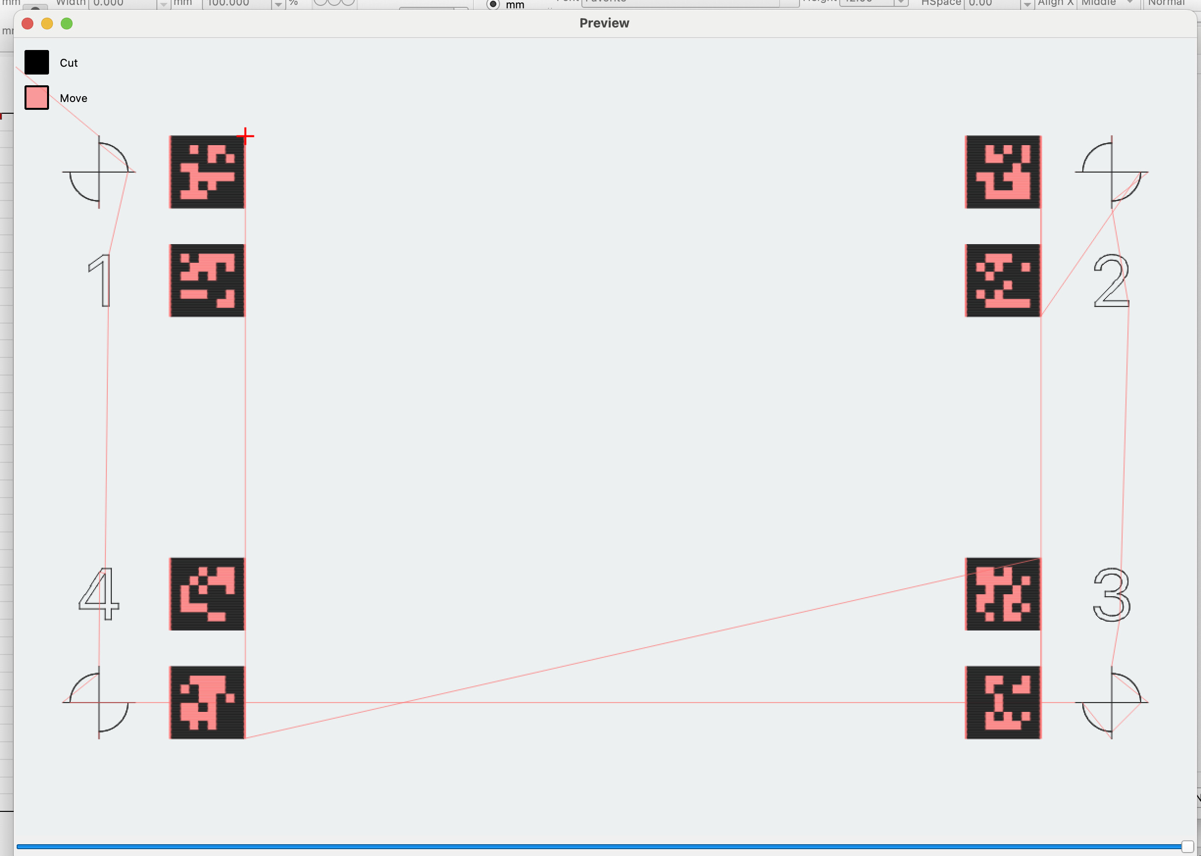

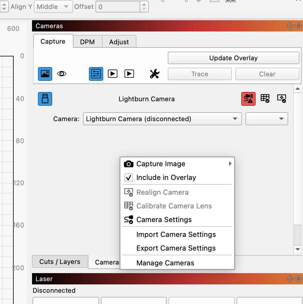

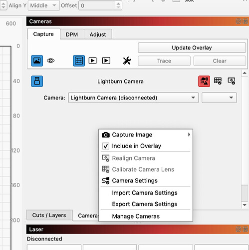

I don’t know if it’s because it’s too early and I’m not 100% awake yet, but I have several questions. :innocent:
  • I can’t confirm at the moment because the camera is at the post at home and I don’t have a camera installed here. But I would swear I didn’t see any option to save the settings in the “Camera Control” window. Am I wrong, or are the camera settings saved somewhere else? (“File menu > Preferencies > Export Preferencies” maybe)?
  • I already mentioned that it’s too early, but if I’m not mistaken, April Tags are used during lens calibration, and sights (targets) are used during alignment calibration.
Can you confirm? Because I’m already admitting everything!!! :grin:
Thanks! :+1:
…it’s a little hidden, right-click in the camera window and you’re on the right track.
That’s absolutely correct, but in the new version we no longer need to hit the target intersection but can use the 4 April targets from the camera alignment. - works amazingly well (here)
