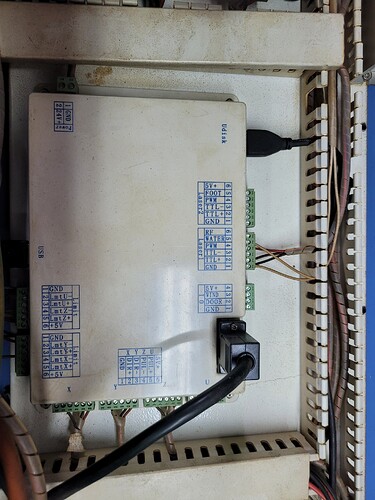

Can i run my triumph laser with lightburn
Hi, i have just gotten this laser and was wondering if i can use lighhtburn with it. I dont know how to identify the controller so here are some pictures.

What does the control panel look like?
That looks to be Puhan controller.
Do you use LaserSoft to control the laser?
If so, it’s not currently supported by LightBurn.
Ruida controllers are the best supported. The website list these particular controllers as being supported. I do not know if it’s a comprehensive list.
Ruida (RDC6442G / S, RDC6445, RDC6332G, RDC6344S, RDLC-320, RDLC-220)

Do i need to replace the control screen and the box inside which is connected to all the motors ect or can i only buy 1. Im on a tight budget and if the screen didnt need replacing i wouldnt do it
Yes. You purchase them together as a kit. Have a look at Cloudray’s website and search for Ruida.
As Robert has indicated, the control panel and the controller module are a pair.

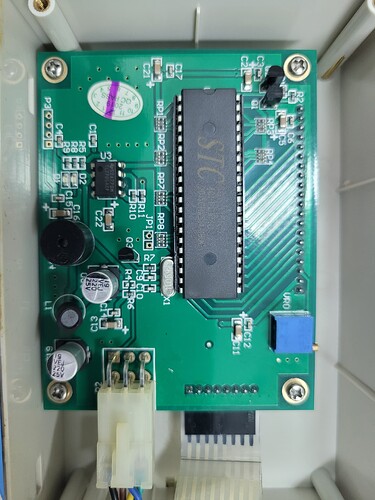

I’m curious about the other components in the system, however. As they may play a factor. For example, it’s unclear to me what the open PCB in the second photo is used for. Where does that connect to?
Can you take photos of the other components and also show how they’re interconnected?
The second picture is just the back of the screen,

Interesting view. What other hardware do you have? Like stepper drivers, power supplies, cooler, etc.

In these photos I see 6 stepper motor drivers with 3 axes used on the controller. How does this work? Are 3 of these not actually functioning?
I don’t see a dedicated 24V power supply. Do you have one?
Overall, I don’t see anything here that would be fundamentally difficult moving over to an alternative controller though. Seems fairly typical hardware wise.
