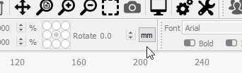

The laser was in the home position. I have been able t print using gerble laser, but would rather use LightBurn
I think I know what the issue is - Your entire UI is in inches, not mm. The design you’re showing is about 25" around, significantly larger than the 150mm working area of the Ortur laser. You have the working area set to be about 150" square - that’s likely why you keep hitting bounds errors.
On the main toolbar is a button to toggle between in/mm.
Click that to get into mm mode, then go to Edit > Device Settings and change the page size to 150 x 150 mm. Then adjust the size of your design to fit within that.
LightBurn defaults to mm for everything which is likely why no one noticed this before.
Thank you sir. Working like a champ.
I think the area of the Ortur Laser Master is actually 150 x 160 mm, so you might want to add in that last 10mm, but I’m happy to hear it’s working for you. :slight_smile:
